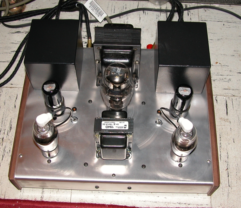

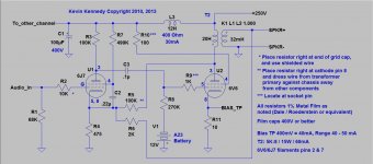

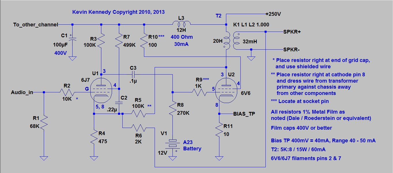

Well I installed the larger input capacitor, the choke, and determined that this killed all of the buzz on the amplifier output. It is dead silent now.
Did some further investigating with the scope and discovered to my considerable chagrin that I had somehow had swapped pins 1 & 8 on the 6J7 and nothing else. This had the unfortunate effect of running the 6J7 in zero bias mode which isn't linear above a certain signal amplitude and also caused the LF response errors I was complaining about in earlier posts. The amp worked despite this error - rather wish it hadn't, my error would have been so much more obvious.. All problems reported stemmed from this mistake. :eek:
Anyway the amplifier now cranks out 4.5Wrms over the entire audio band and all the way down to 20Hz. I have not redone the response measurements, but I assume they will be good when I do get around to doing it.
Noise is inaudible, (no discernible ripple on the output) and the amp sounds very clean and detailed. All reservations now removed. The amp doesn't sound sound like a typical triode SE, but it doesn't sound like a typical pentode amp either. It's quite good.
The schematic as shown in the final version is correct, and I will now disclose that the OPTs were made by Twins Audio and are quite excellent, and are exactly as they described. I can heartily recommend them based on what I am hearing!

Nice Kevin,
What voltages are you getting at the 6J7 plate and G2?
Have you considered regulating the 6J7 G2?

Hi Andrew,
I had to remeasure the voltage, but the 6J7 plate is ~ 105V, and the screen is ~63V. The supply to the output screens and the driver stage is approximately 270V. Plate current is around 1.7mA.. As configured this driver will swing at least 80Vpp into a 270K load which is of course far more than required. I can't remember where I saw the graphs, but I remember seeing some that indicated that this tube at the particular operating point was pretty linear, and it sounds that way. I recommend it.
This thing performs well, and is only one of two SE amplifiers I own that work well with the Onkens which tend to be fairly merciless at revealing amplifier weaknesses. (The other amps found new homes)
I am listening to Bedrocks "Beautiful Strange" which amongst other things is a good demonstration of phantom imaging, (cut 3 in particular) and this amplifier seems to preserve those imaging cues.
I am pretty firmly in the DHT camp, but almost all my designs feature fixed bias as indeed this one does. I feel pretty strongly that almost any bypass cap in a traditional cathode bias setup is a serious sonic compromise, so I tend to use fixed bias a lot. (including low level phono stages and line stages)
I had initially planned on using regulated screens for the output tubes, but not for the 6J7 which apparently performs better with the screen AC coupled to the cathode which in this case is not at ground potential due to the unbypassed cathode resistor and the feedback connections.

Kevin,
I'm repairing a vintage Aussie MATON suitcase style guitar amp which is a 6J7 driving a KT61.
It is oscillating like a "bi.ch". Will no doubt solve that later.
For now - I've reviewed this thread but was uncertain what you did with the 6J7 Internal Screen pin 1. I initially had it grounded and then tried it connected to pin 8 (Cathode). It was much quieter with it wired to ground. What did you do with pin1?.
This did not change the oscillation problem at all. That I think is a lead dress issue.
Ian
Administrator
Joined 2004
Hi Ian,
I tied pin 1 of the 6J7 directly back to my ground buss through a short piece of wire.. I had a lot of oscillation problems and found that shielded wire, and careful lead dress particularly around the 6J7 were the key.. The suppressor is connected directly to the cathode, and the screen directly bypassed to the cathode. I have a 10K grid stopper mounted right at the grid cap. It is rock stable now.

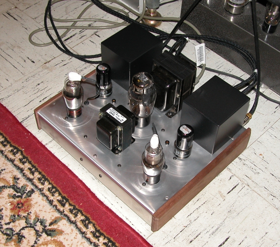

The amp is working well, and after a couple of weeks of steady use I can state that it is reliable.
The bass is extended and well controlled with an authority when called for that belies the simplicity and small size of the amplifier. Imaging is relatively solid, sound stage has some discernible depth, and tonal balance is just a little forward, but warmer than I expected. The highs are clean and extended.
The overall results definitely seem to justify the effort I put into this project.

This week-end the amp gets its moment of glory at the local audio club gathering at my place. It is now equipped with a pair of late 1930s Kenrad 6V6G.. Sounds good, but after having set it aside for a month or so when listening through the Onkens there was no mistaking it's pentode signature.
I also concluded that adding the triode/pentode switch was probably a step in the wrong direction as it is neither quite triode nor pentode, and lacks the individual strengths of either.. Perhaps it is just not the ticket for driving the Onkens, will report back next week. Source will be an ancient massaged PAS-3 and my diy TT..

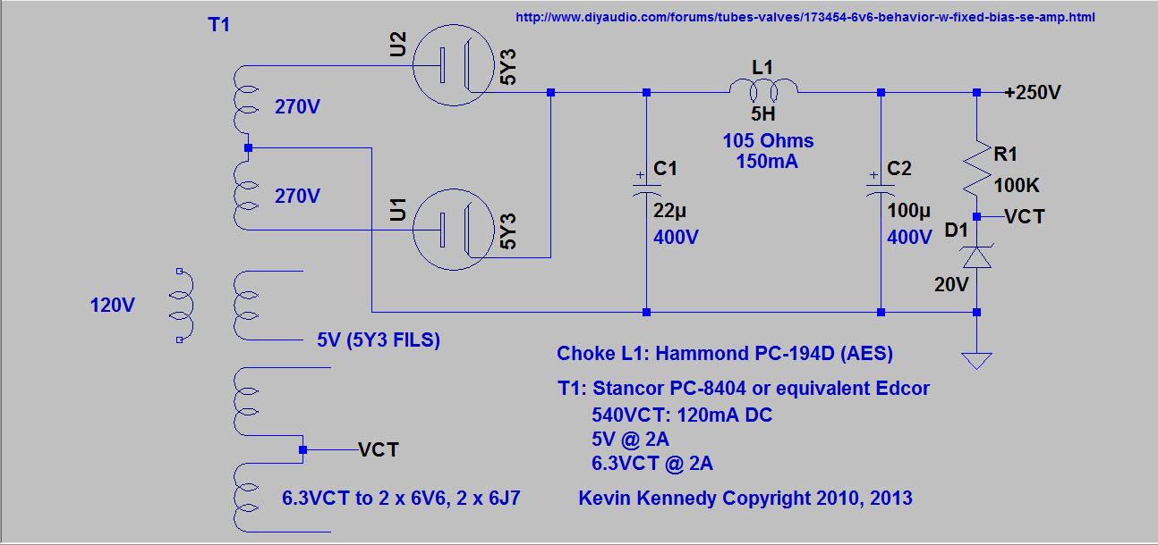

Joined 2004
Long quiet thread... Yesterday I took this amp to an audio fest where it was well received. It stayed in the system until I had to leave. The speaker system was based on a pair of Altec 604 (later, although I do not know the specific version) in what I recollect are MLTL cabinets. (I will check with the owner and post corrections.)
Strikes me that Electra-Print might be the best source for an output transformer, but Edcor makes something I suspect is comparable to the Twins Audio transformers I used, found here: https://www.edcorusa.com/p/537/gxse15-8-5k
Power transformer: https://www.edcorusa.com/p/598/xpwr009
Reasonable sub for 12H choke: https://www.edcorusa.com/p/776/xc75-15h-75ma
5H choke either Hammond PC-194D from AES or Edcor https://www.edcorusa.com/p/783/cxc100-5h-200ma
Note that if B+ is too high (more than 270V) under load it can be trimmed by adding a small power resistor in series with the HVCT.
Both of the 100uF electrolytics are bypassed with 0.47uF films (not shown) as noted earlier in the thread. Recommend 400 or 450V, 105 degree C rated electrolytic caps if possible.
