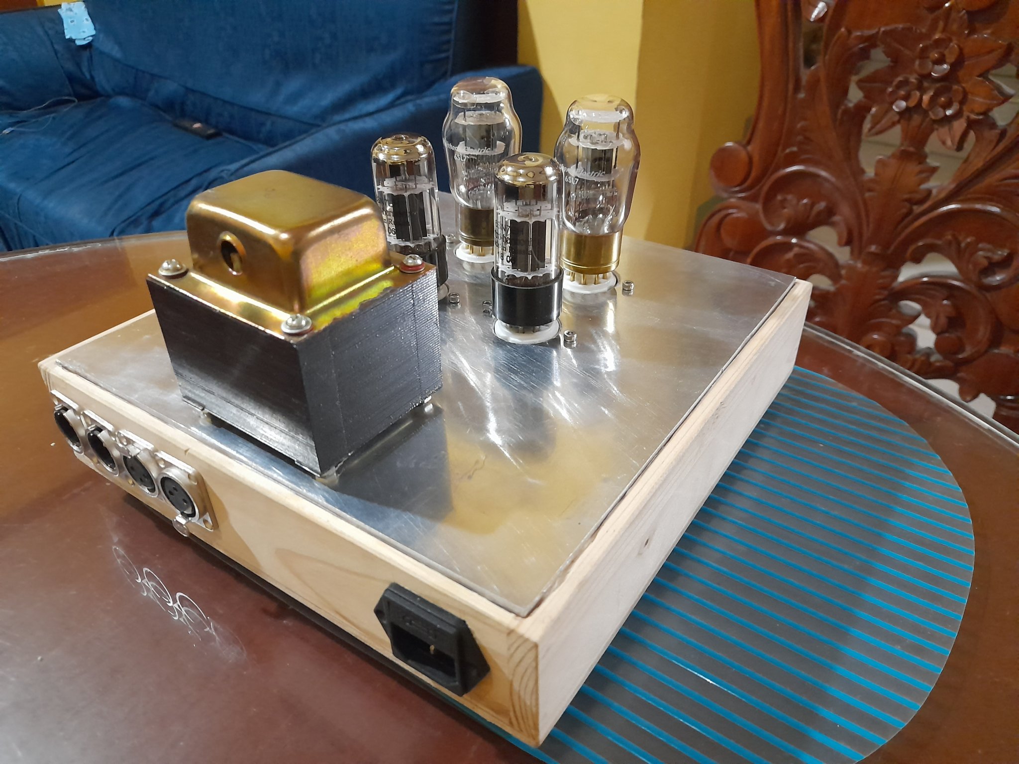

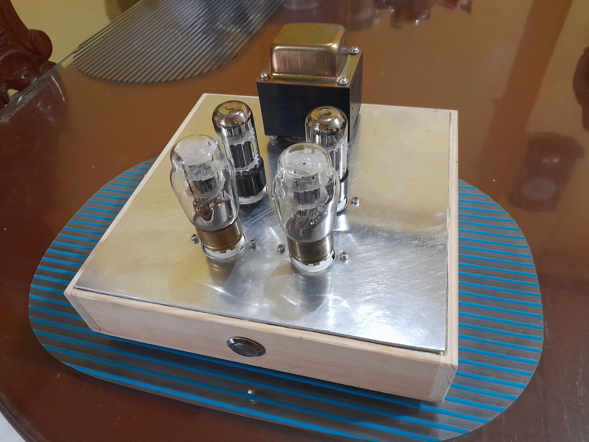

All right, it is almost a year ago since the last response, in the end Ling was so kind to sent me the Gerber files to produce a PCB of his design.I have a few left. I'd send some along if interested, PM me if you like.
But in the mean time I have drawn my own and ,yes, using his file which he was so kind to sent me, I have made my own.
But after populating my pcb with the relative components, I discovered that I do not know at which parameters I
have to judge the design: for instance, at which power (250mW into 8 Ohms load) can I judge the THD at for instance 10kHz?
I am now using the Block RDK15-2x6V as OPT, which gives a 11.8k Ohm load primarily at 8 Ohm secundair.
On the whole it behaves quite good.
My standard is to measure THD & PO when the amp is driven by 1kHz just before clipping.I discovered that I do not know at which parameters I have to judge the design: for instance, at which power (250mW into 8 Ohms load) can I judge the THD at for instance 10kHz?
Yup, 1khz sine is about standard for the testing. If you have the means to look at the waveform I'd say rated output power is right before the tips of the peaks begin to flatten out. THD is gonna be more tube and bias dependant but 250-400mW output is about where the Russian tubes measure best. Good NOS American tubes can net a bit better THD. You can get better low level numbers and less overall output by running the output stage hotter but I see no need as most of the time output is unlikely to be over 250mW in my use cases. Higher output impedance can net lower THD with lower output.

Its the THD what is mismatching at large signal levels
When running the transient response and simulating large input signal behaviour, simulation results of the THD
is much larger (around 1.5 to 3%) than I am measuring the actual print board.
For instance at Rload=8 Ohm and increasing the input signal up to around 900mW Pout, measuring result is 0.42% THD on the board, measured with my
HP339A distortion meter. LTspice calculates very much more.
This of course when using the 3-5 output terminals of the 125A where (according to Hammond), primary impedance is 17600 Ohm.
But I think that the large signal behaviour is inaccurate when using the LTspice tube models.
At 50 mW output I first got a 0.63% THD due to the 50Hz mains component. Whatever I tried, I did not manage to get that figure down until I
used 6.3Vdc in stead of 6.3Vac filament voltage (using the Arta spectrum analyser software together with the soundcard of my computer). Then it dramatically dropped to .18% THD.
So all THD figures are ranging from .18% (50mW) to .42% (900mW) and using 6.3Vdc filament voltage. Did a simple sound check with one loudspeaker.
Now I have to populate a second board to do a final listening test.
