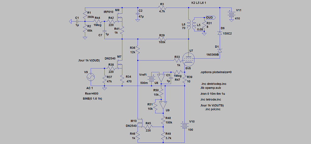

Will come back with an alternative MJK style Schade-driver.

In the FET-driver schematics, the FET is injecting current into the output stage? To match the open-loop nonlinearity of the tetrode? If so, I will have some fun with that.

Work will be bad, you can see without spaysmodel: when the DN2540 drain voltage increases, the plate voltage is reduced. A plate voltage is the supply voltage for DN2540.Rod,
This was the basic topology I was thinking of. Can and should be refined.
So you can do in PP if you take the plate voltage on the opposite shoulder.
Hey SVStube, you just exposed your ignorance.
Before you post, I suggest you use "search" at diyaudio. In this case you would have found out this topology works great. Michael Koster have designed and built a few.You should also had spiced it to find it also sims great.
It actually works at least as good as a D3a pentode as Schade-driver.
This is the prototype from MJK:
http://www.diyaudio.com/forums/tubes-valves/165221-most-linear-triode-strapped-pentode-7.html#post2204502
