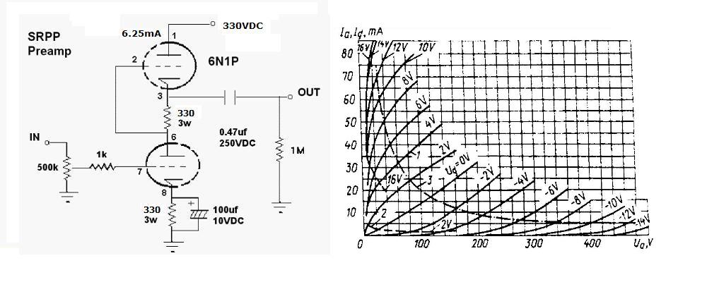

I forgot to memtion an oddity about 6n1p's that I found. The Svetlana produces a tube called 6n1p which has completely different characteristic curves from anybody else's. The safest way is to use the spec from the particular tube manufacture's web site if they are still in business. The characteristic curve I attached was obtained from Sovtek a few years back when I built my SRPP. I believe the Svetlana 6n1p's will run much hotter with the same plate voltage and screen biase.
tttking said:I forgot to memtion an oddity about 6n1p's that I found. The Svetlana produces a tube called 6n1p which has completely different characteristic curves from anybody else's.
Svetlana has never made any 6N1Ps. The logo on the "Svetlana" 6N1Ps I have is not the Svetlana logo ("winged C").
I would just use the data from the original Russian data sheets - whether Svetlana tubes are used or not. The circuits from the Svetlana 6N1P app. note do work though (the ones I tried at least)...

ArnoldC, just some personal experience to share. My 6n1p srpp sounded somewhat less dynamic, with sweeter highs, a little more open, much more musical and with more controlled bass than my passive amp (with a home made step attennnuator). Over all, the SRPP sounded quite natural and reminded me quite a bit of the live concerts that I have been to. Somewhat weaker bass, a little less clear in the details and a hint of harshnes in the highs though. I am using a good CD source and a DOZ class A power amp. BTW, the Sovtek's sounded better than the Svetlana's in my SRPP.
tttking said:that was a really nice looking set of charts for 6n1p, one hundred times better than the Sovtek ones. Thank you for sharing with us. The data do look similar to Sovtek's ugly charts.
Check out his whole site... more tubes measured, some interesting amps & such, and a DIY curve tracer.
dave
Some real data for an '80s version, a 6N1P-EV is: at 150 plate volts and -1V on the grid, plate current is 10.75mA, gm is 5.3mS, µ is 37.5, rp is 7.1KΩ.
This is ACCURATE data for the part, taken from a sample of 125 parts on a special test rig of my own construction and processed in an Excel spreadsheet I built.
