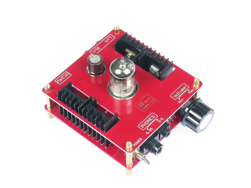

I got an interesting headphone amplifier board today. There's a 6N11 tube on it, other silicons are 2xIRF630, 2xLM317 and 2 TO-92 transistor. The sound is fairly good with my HD600. Most interesting of all it is powered by single DC 24V! How can 6N11 work at such low voltage?
Google a bit, found that most 6N11 circuit need much higher voltage such as 150V or higher.
This is the headphone amp board

There's no voltage multipler on board. The circuit should be like the one VictoriaGuy posted but there's one more transistor to drive the gate.

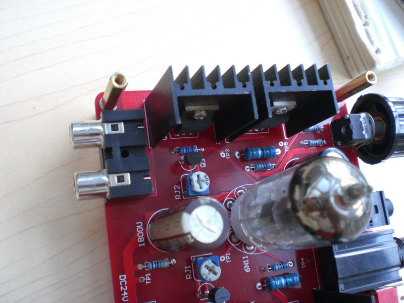

See the following photo, the TO-220 on the left is IRF630, right is LM317. There's a small TO-92 transistor near the IRF630.

Most all tubes will sort of work at low B+ voltage.
The distortion will be very high, but most of the distortion will be even-order distortion that most people perceive as sounding nice. And there is nothing wrong with that.
The (c) Rogers Gomez schematic looks like yet another variation on an amp designed a few years ago by a korean who went by the handle "sijosae" on the forums. He called this basic sort of design the Multi-Hybrid Headphone Amp or MHHA. He designed 6dj8 and 12au7 versions, with irf610 for output i think.
They were very popular back around 2004-2005. Many lookalikes have turned up on ebay.
Since the 6n11 is similar to a 6n1p which is similar to a 6dj8, i would assume that it's just another version.
There is nothing new under the sun, so i would not be surprised if it's been done before sijosae did it.
