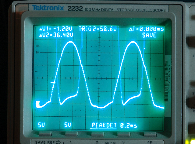

Negative plate voltage? Like this? Negative plate voltage IS possible, but usually only happens in clipping into a reactive load.
Photo shows the drive voltage in screen drive and the plate voltage on a pair of 6CB5's being driven well into clipping at 130 watts. The scale is 50 volts per division. The screen swings from -25 to +240 volts and the plate goes from -5 to + 1100 volts. This photo shows the fatal flaw in cranking maximum power via screen drive. At the instant of peak power the plate is near zero, and the screen grid is at +240 volts. It glows like a light bulb. The screen is still glowing when the next half cycle comes and the screen is zero while the plate is 1100 volts. The screen begins to emit electrons, and BANG happens!
