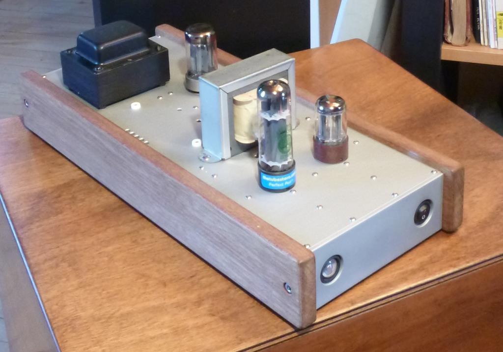

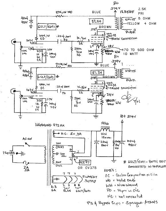

This circuit used to be on the Angela Instruments site. I built it as 2 monos with a 5AR4 in each because I had 2 small power transformers and 2 small chokes. Had some hum until I rotated the OPT 90 degrees. Sound was OK.

Thank you Kenneth, but that is a $100 tube (website says 70W dissipation? What a beast) I'm a little confused here.<snip>
Yes. In pp EL34 can produce the power output that you specify. Actually if the EL34 have real good quality as those produced in the 50s to 60s, you may squeeze upto 100W from a pair of EL34s in pentode connection.
But those DHT fans always boast "SE prevails".
So... if you like the sound of SE amp, KT150 in parallel might offer you a safe option other than those real breasts that requires B+ at about 1KV.
I'll offer a different opinion here. If you do indeed want/need 20-ish watts of power, you could investigate the 6C33 tube. The output transformer isn't particularly difficult to find, and you can even use some speaker distribution transformers and plate chokes to go parallel feed. With 250V of B+ and some hefty current, you'll get close to 20W without too much trouble.
