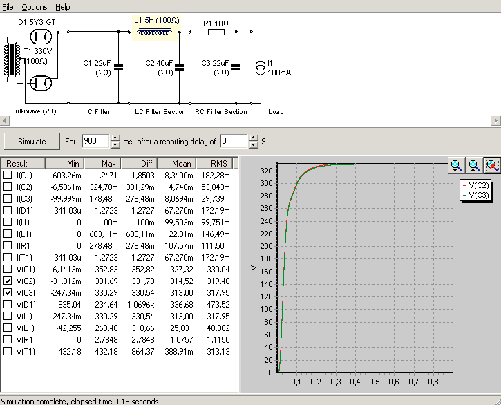

I would like to build a complete unit with PSU, power amplifier and also preamplifier.
Attached are the schematics that I'm considering (Correction; this is the original version not the final one).
As regard the PSU (that I personally have designed in order to obtain the indicated requirements as B+ voltages and smoothness) could anyone provides me some suggestions to correct or improve it?
Can also someone indicates me a suitable output transformer for 6L6 in SE configuration (induction value etc.)?

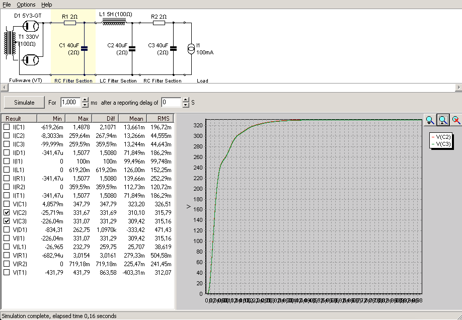

What do the 2 Ohm resistors add to the power supply?
40uFd 5H 40uFd may be enough filtering-- it was for many old radios.
2 Ohms and 40uFd is a 2KHz low-pass.... will do nothing for 100/120Hz ripple.

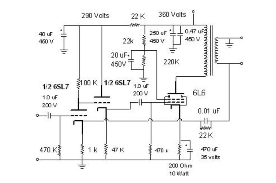

Why do you use a cathode follower to drive a simple 6L6 grid? Should not need that.
Is your 6L6 screen grid divider passing enough current (low enough impedance) to handle the change of screen current from idle to MAX? Old data says 3mA to 5mA, but real tubes (especially recent-made) may be far off these numbers.
Is it necessary to run the SE 6L6 way up at 360V? (Perhaps not...)

PRR and Allen have touched on very important details of your power amp. I would add that the screen bypass cap needs to go to the 6L6 cathode.
As far as the preamp goes, what you have there is a phono stage with adjustable EQ. If you're planning to run a source that isn't a record player or a tape machine with direct head outputs, it's not going to work particularly well for you.

As regard the PSU, the first schematic attached is completely wrong and you are perfectly right about the CLC configuration.
As regard the power amplifier schematic I'm not sure specifically why the author of it runs the SE 6L6 with 360V. What do you suggest? Indeed in designing the PSU I faced some problems in rising the B+ up to 360V while filtering it enough.

For pentode operation, the screen needs to be bypassed to the cathode.

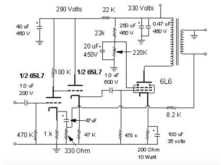

Sorry again I also noticed that the power amp schematic that I uploaded first is the version without the modification to flatten the frequency response.
These are the correct schematics which I'm intended to build. As PRR stated there is no need of 360V B+.

Moreover isn't 20uF 450V cap the screen bypass cap?

Yes, the screen bypass cap needs to connect to the cathode, not ground.Moreover isn't 20uF 450V cap the screen bypass cap?

Just the capacitor will do.

Works well as it is now. The cathode is bypassed fully with 470 uF capacitor, so there is no difference if the screen is bypassed to cathode or to gnd.

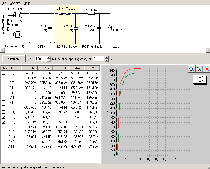

Thanks for your contribution. Also what you think about the PSU that I designed? And as regard the clean B+ for the preamp? (PSU and additional inductance would be sufficient?).
.01uf NFB cap seems high, you will lose mid and high range gain.
Which capacitor you are reffering to?
