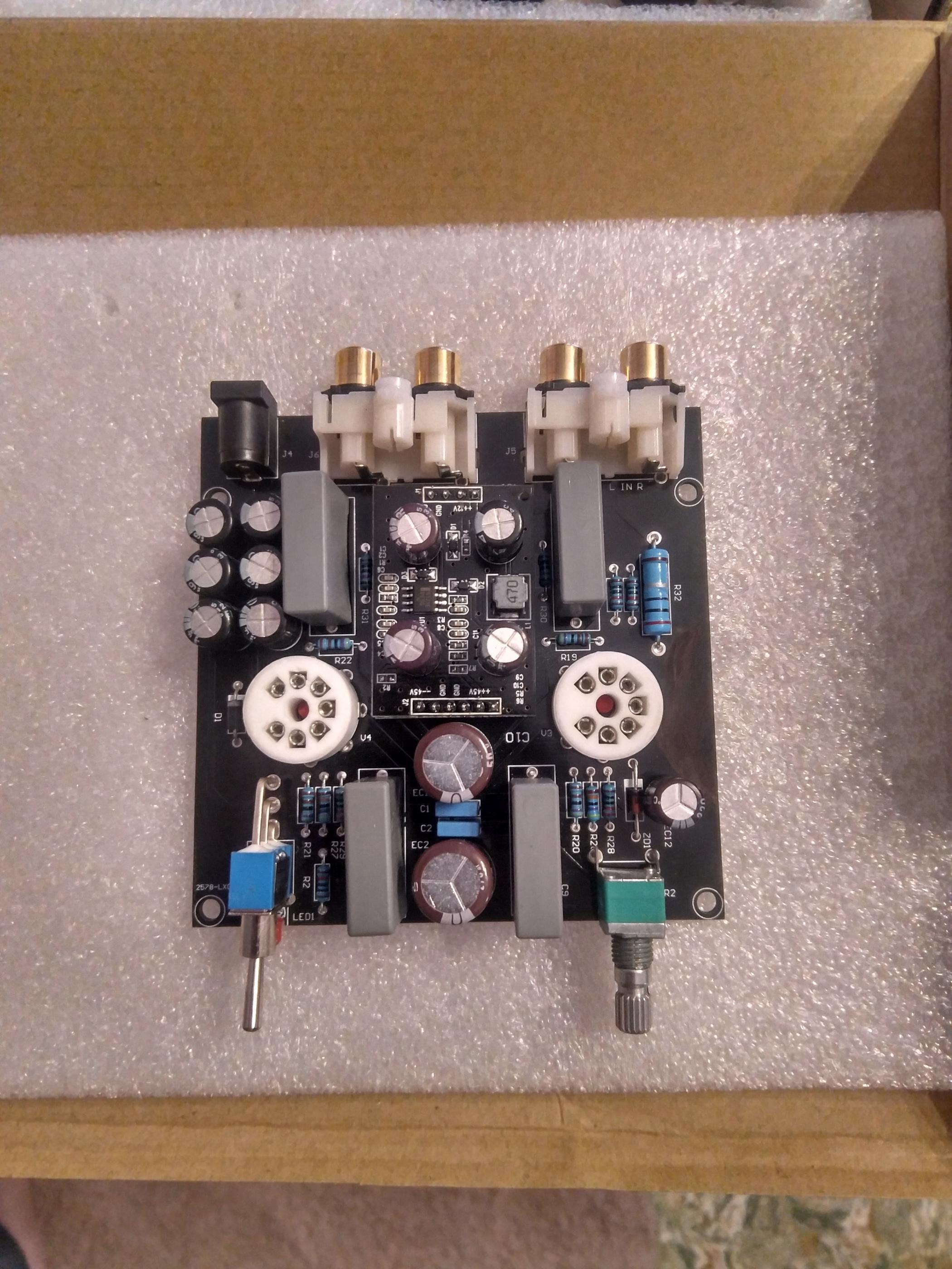

99% reduction in hum with just 2 wires and 3 cuts that separate the filament supply ground from audio ground.

3 questions if I may:
Which of the 2 mods are most effective in terms of hum removal (or are they much of a muchness)?
The first mod has an external switch added - what is its purpose?
What power rating does this preamp require?

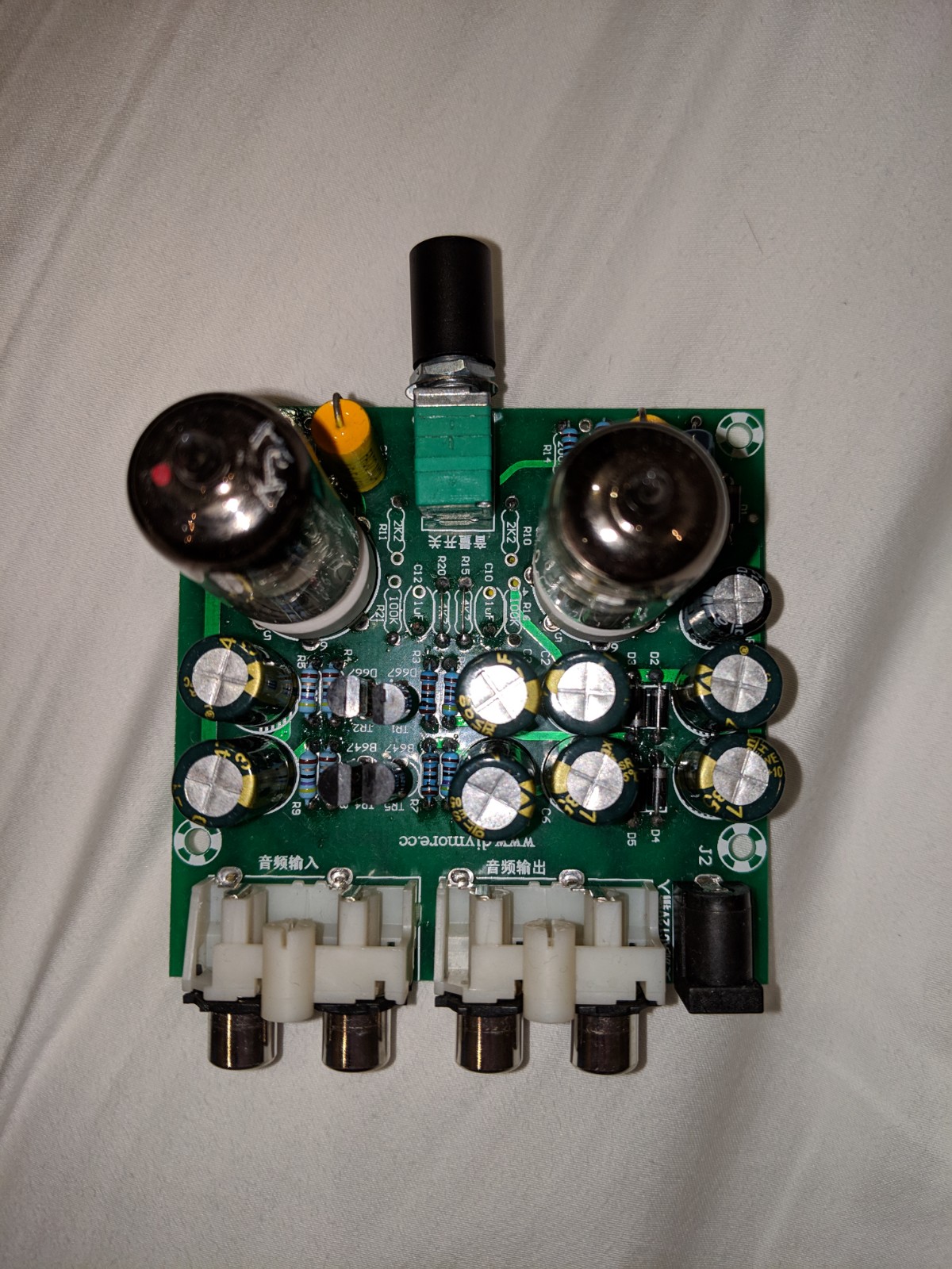

I recently got this pre amp.
But on connecting in the chain there is a constant noise even at nil volume level from speakers.. noise sounds like radio turned on at high volume but without anything being played.
Unit comes with a dc wall socket- could this be power supply issue or the tubes issue!?
Pic of the board:
If it's to do with tubes then planning to get GE substitute and for powerfully issue, i have R core with regulated dc power supply which might need tweaking for that 12 volt input (at present output is at 15volts)

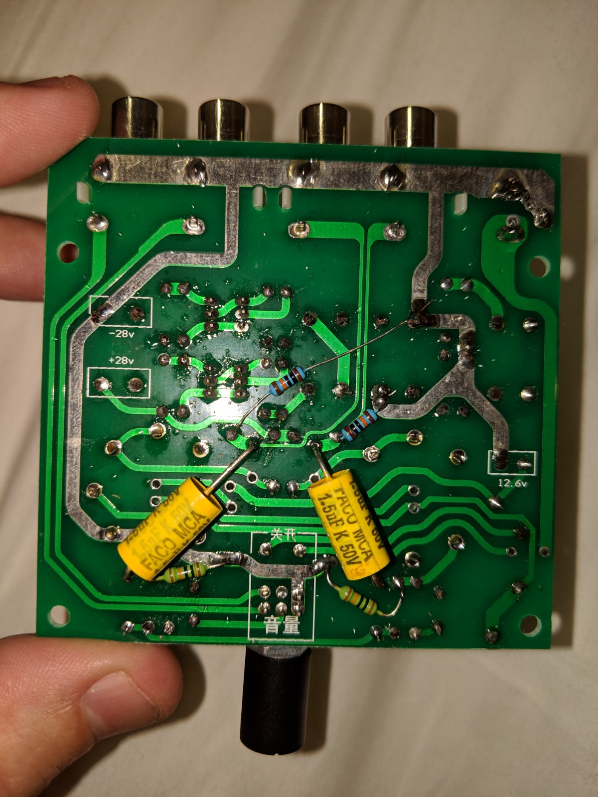

Mods 6J1
And there you go! Grid referenced to gnd and not -ve, as is the output node, plate load is gone, and the cathode load is now 4K7.
Works fine, and I really should have a play with some of the others. :)
