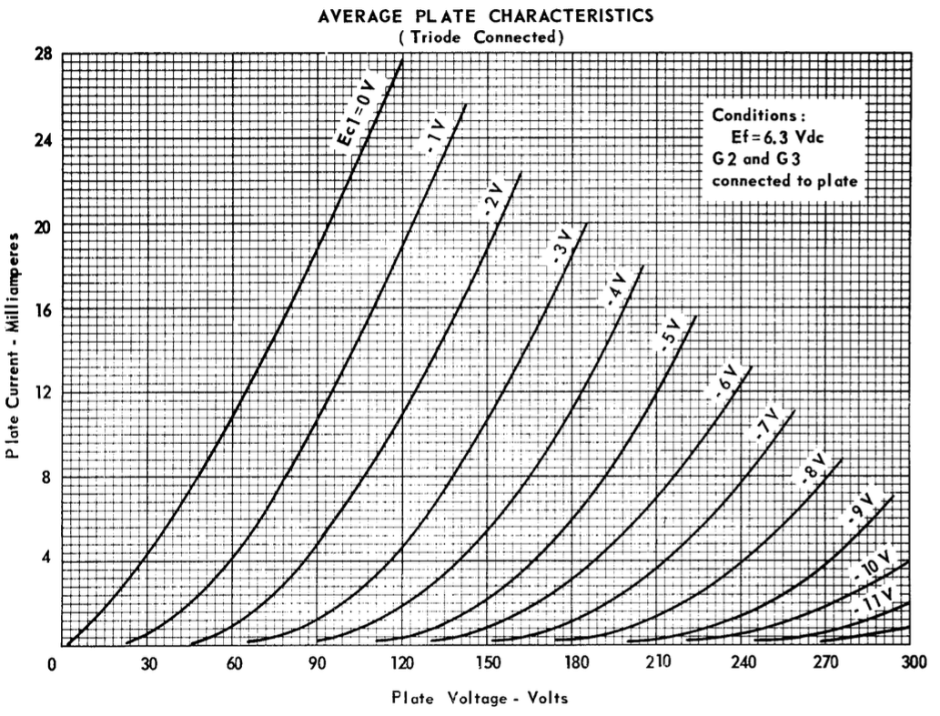

First, the plate curves shown in the document are for the tube in its normal pentode mode and all the preamps that use them run them in triode. The "specifications" link in the text brings up the Chinese data sheet and it does show triode curves. Here they are from the much clearer Raytheon data sheet.
I'm not sure how much the use of the wrong curves might affect your analysis.
Also, I had earlier run across some estimates of the plate resistance (Ra) of the tube in triode and your calculations confirm that it is ~4k. But then you say that the plate load resistor (R15), which is 4.7k is appropriately sized.

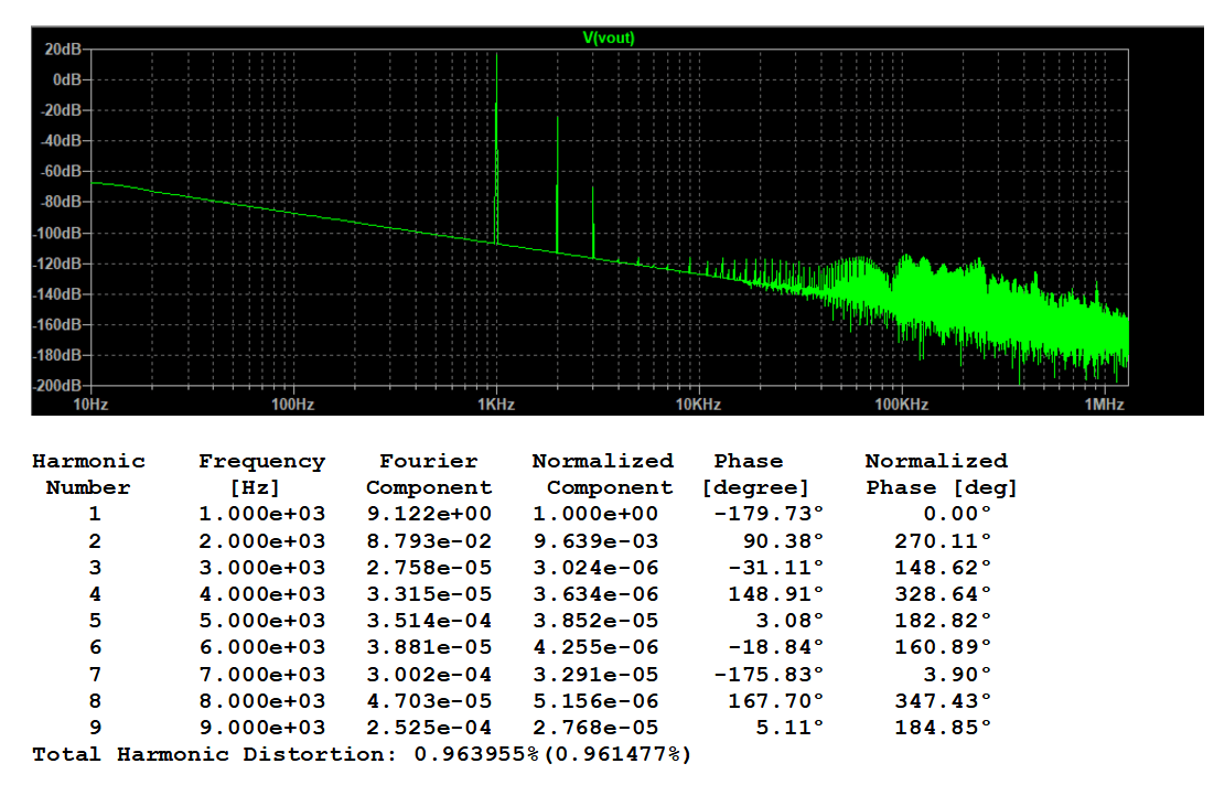

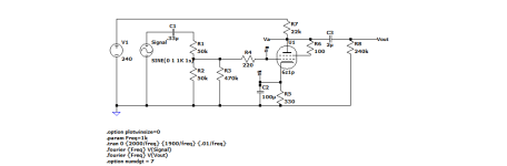

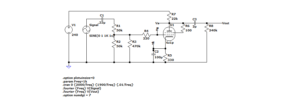

Maybe it is wrong thread, but this is a thread where I see the board I have played with and where I wanted to contribute in return.
I took the liberty and looked at design from your post at other forum. I have run it through the simulation. Here are the results
If members at other forum can provide schematics for Audio FX board, I may have a look, but I will not buy it just to play with it.
Looking at the board as advertized, it takes different means of voltage boosting, there seems to be some sort of power source
filtering with low pass filters, I believe it will use same common cathode design.

I have no experience with Spice sims or whatever you're using and I have no idea how to interpret the results. I'm pretty much a copy and paste builder and I make decisions almost exclusively based on what sounds best to me. As I said, of the dozen tubes I breadboarded in the same basic circuit, the 6AK5 was near the bottom to my ears.
In introduction to tube design on page 71, one can see a frequency response that we strive for. The plateau (flat region) shall be at least in human audible range and shall be as flat as possible. Design from your post at other forum resembles more a low pass filter than amplifier response that one longs for, it might be correct though, depending on source and target circuits. Since there is the attenuation, 2nd-10th harmonic frequencies do not contribute to THD as with flat response, thus the value might be not comparable.
With regards to “the wrong curves might affect your analysis”, LT Spice model by Robert McLean has all the curves modeled as precisely as possible, thus need for load lines and other calculations as shown in introduction can be saved. The quiescent point I took from 6J1 specification places me at the start point for modification.
I rather use Spice modeling in order to save time in breadboarding various variants drawn by other designers to verify the plausibility of their design.
Ad "if you want your efforts to reach a much larger audience", you may cross-reference this thread since you are regular at other forum too :)

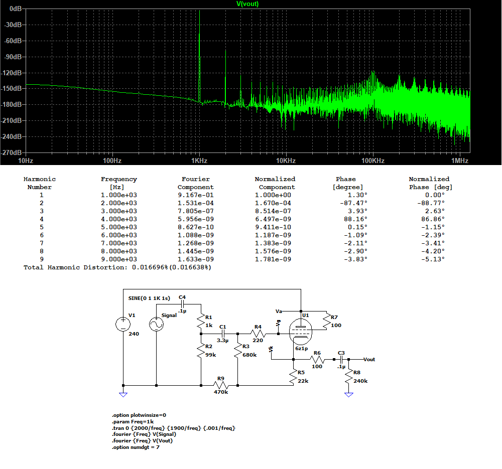

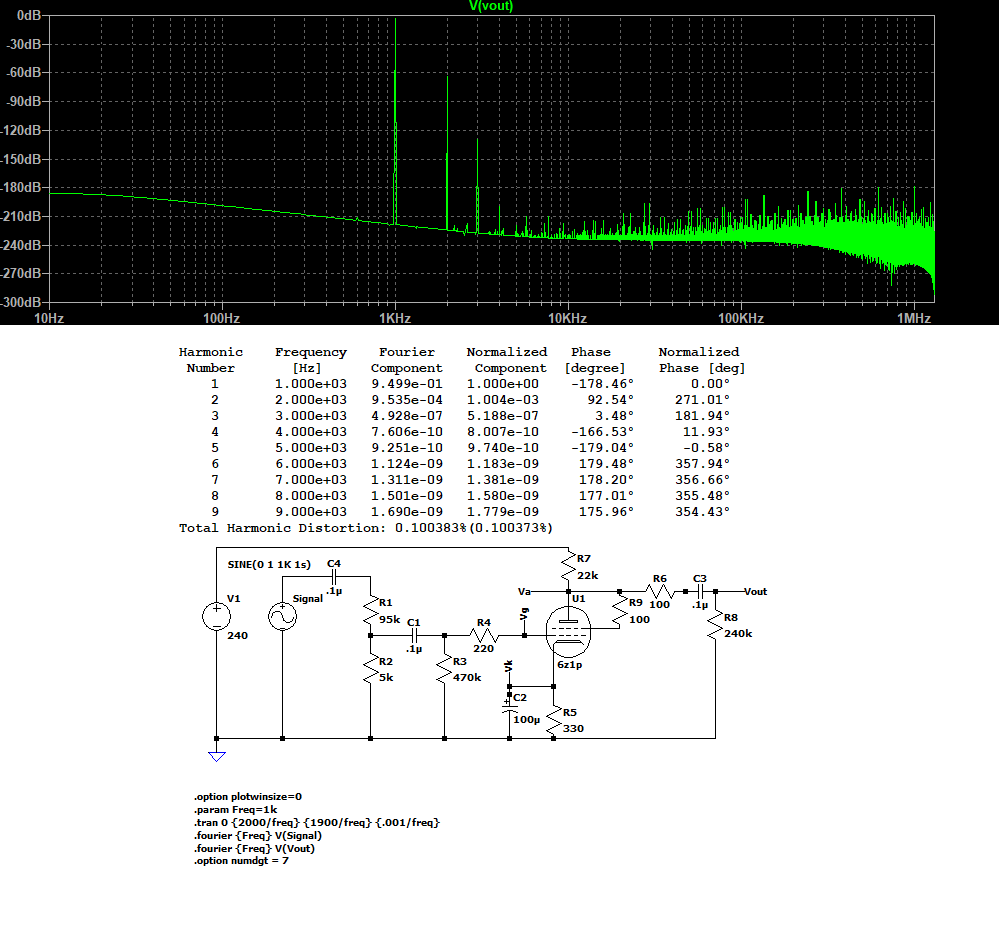

I have tried to correct FlaCharlie design in Common Cathode setup and created Cathode follower.
The potentiometer is set for 0dB in schematics for the calculations. I have done no breadboarding nor smoke testing.
I hope someone will find it useful :)
As you have suspected very low ~0.3mA.
Chosen resistor (R7-Common Cathode) is used as R5 Cathode follower.
I took R7 as Charlie's design decision, I have tried to accommodate rest of the circuit. to run with the value.
I was trying to show that for any operational point one can have flatter frequency response.

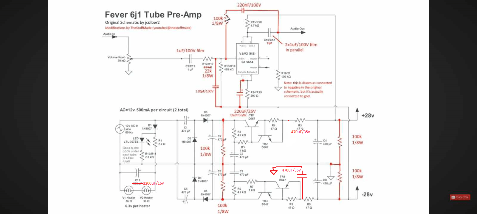

Sorry to resurrect this thread again. But it seems the logical place to put this mostly debugged schematic for modification by TheStuffMade on youtube that drops the output impedance of this preamp from 5kohm to 1.2kohm, limits the upper frequency response from 500khz to 100khz, and pretty well fixes the low end response roll-off issue on power amps with low input impedance. I also added in the most effective hum removal for me. Going to go through acamus' pdf and maybe tinker some more with it. Will probably make a schematic with what seems to be the most effective all around set of mods for this preamp soon. TheStuffMade thoroughly tested his modified pre against a far, FAR more expensive tube pre, and the only place it tested worse was noise floor i believe, but he didn't even attempt hum removal mods for the noise.
I definitely disagree with FlaCharlie. I was quite discouraged by his posts, glad i chose to disregard them. For the money i have into this thing, the performance is honestly pretty ridiculous and it was very much worth buying and modifying. Is also apparently what got me into the diy side of amplifiers and i enjoyed the hell out of trying to figure out how to improve this thing's performance and i've learned a lot more in the process then i expected to..
Reactions: 1 user

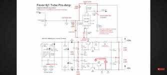

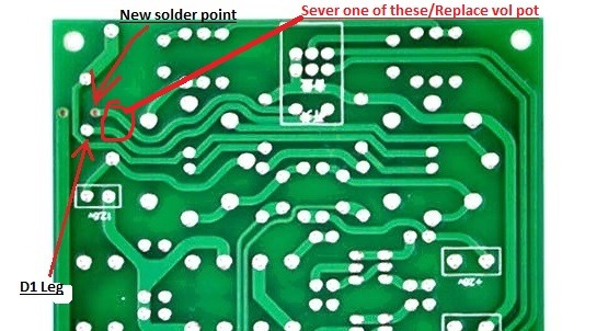

Also meant to post a switch mod that's a little bit cleaner if you're not using a wall wart style transformer for this preamp.
If you solder a jumper between the inner pin of D1 and one of the empty holes near by (pictured), you can just put a switch on the 12v line in from the transformer. And take a pocket knife and just scrape through one of the 2 tracers heading out between the tube pins if you dont want to replace the Pot. It's the same mod, but a much cleaner looking version of it. You can also just unsolder the volume pot, and replace it with an un-switched 2ch 50k potentiometer. If you do this go a50k, not B, you'll have a more usable sweep. That's what i did. Single jumper, replace volume pot. Switch on 12v line in. Looks like it was meant to be this way.
Especially if you're using a little 12v transformer like i am i would recommend this version of the switch mod. Less effort, looks cleaner, same result.
Pictured are the two points that need to be jumped.
It's currently the best performing preamp i have, while also being the most inexpensive by a pretty good margin. It was definitely the most fun to tinker with. My first point 2 point build will likely be the debugged schematic of this preamp because of how familiar i am with the circuit now, how simple it is, and how well it preforms in the end. Plus i got to help in getting this circuit to this point.
I also have no problems if Joe China wants to copy the schematic and release new version. I have no problems at all personally, with this kind of performance being accessible for this kind of money. If that happens ill probably buy one. Honestly. My fosi P1 preamp has more noise, and less output both, then the last schematic circuit i posted, fwiw to someone who cares.
