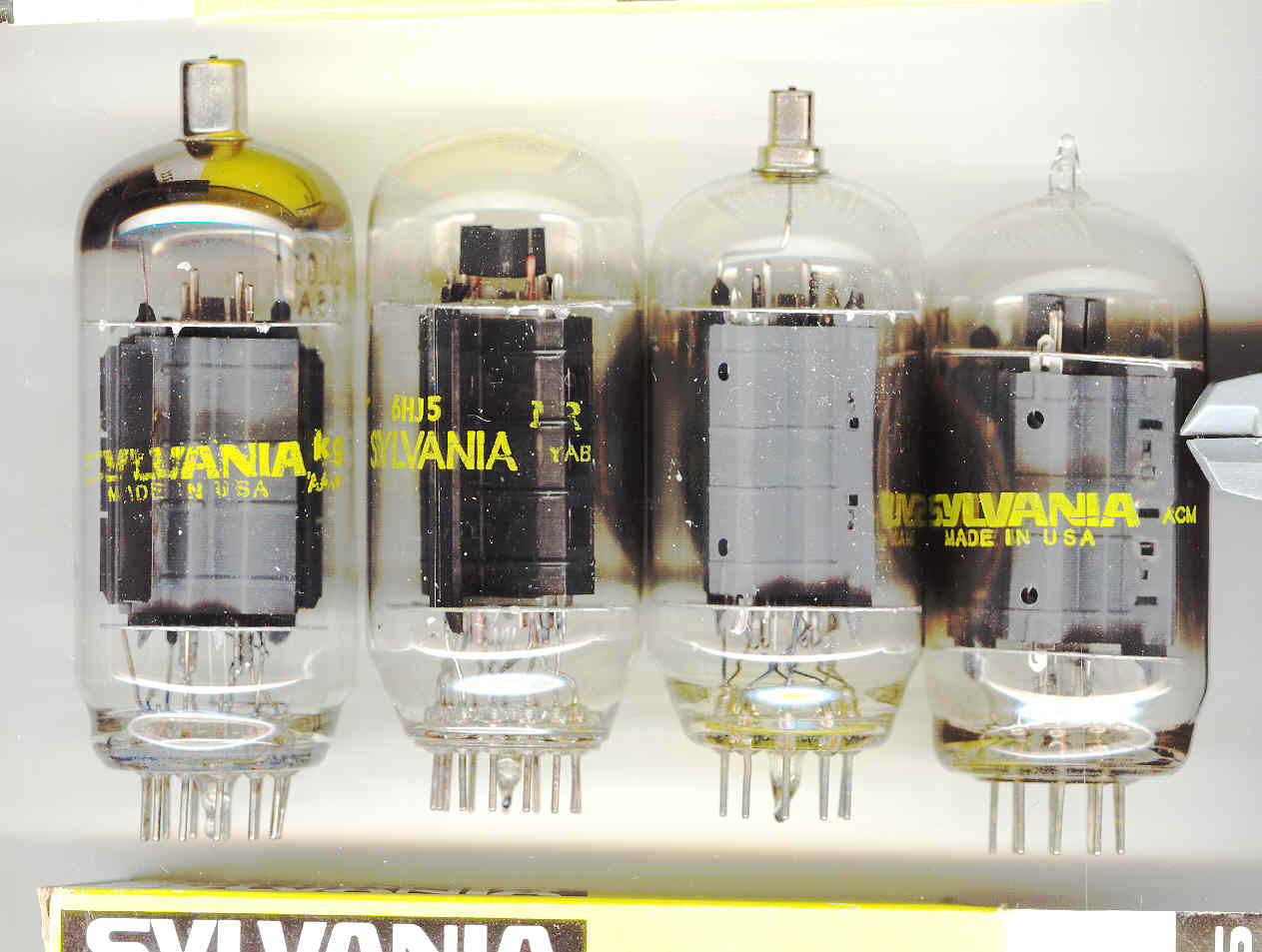

Pics: LG HJ KM KV

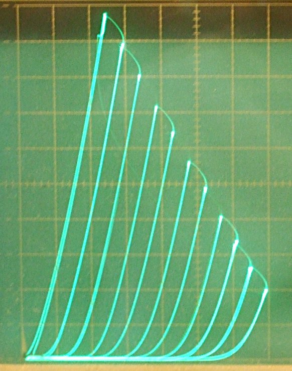

Seeing as how this thread started out with Screen Drive, to get back more on topic, here is a list of TV Sweep tubes with knee currents at 150V on g2. Ordered by knee current. 6GB5 about half way down the list. The still available $1 12HE7/38HE7 oddball tube is just above it.
List of knee currents for g2 = 150 V, g1 = 0 V, Vp = 60 to 80 V

Hmm, not good. The two Westinghouse ones I bought some time ago look like nice tubes. Vacuumtubes.net lists the 26DQ5 at $5. There is also the 6EX6 ($5) and 21EX6 ($3) at Vacuumtubes.net These are similar octal tubes to the 26DQ5. 6CB5A is also quite similar, at $5, either place.

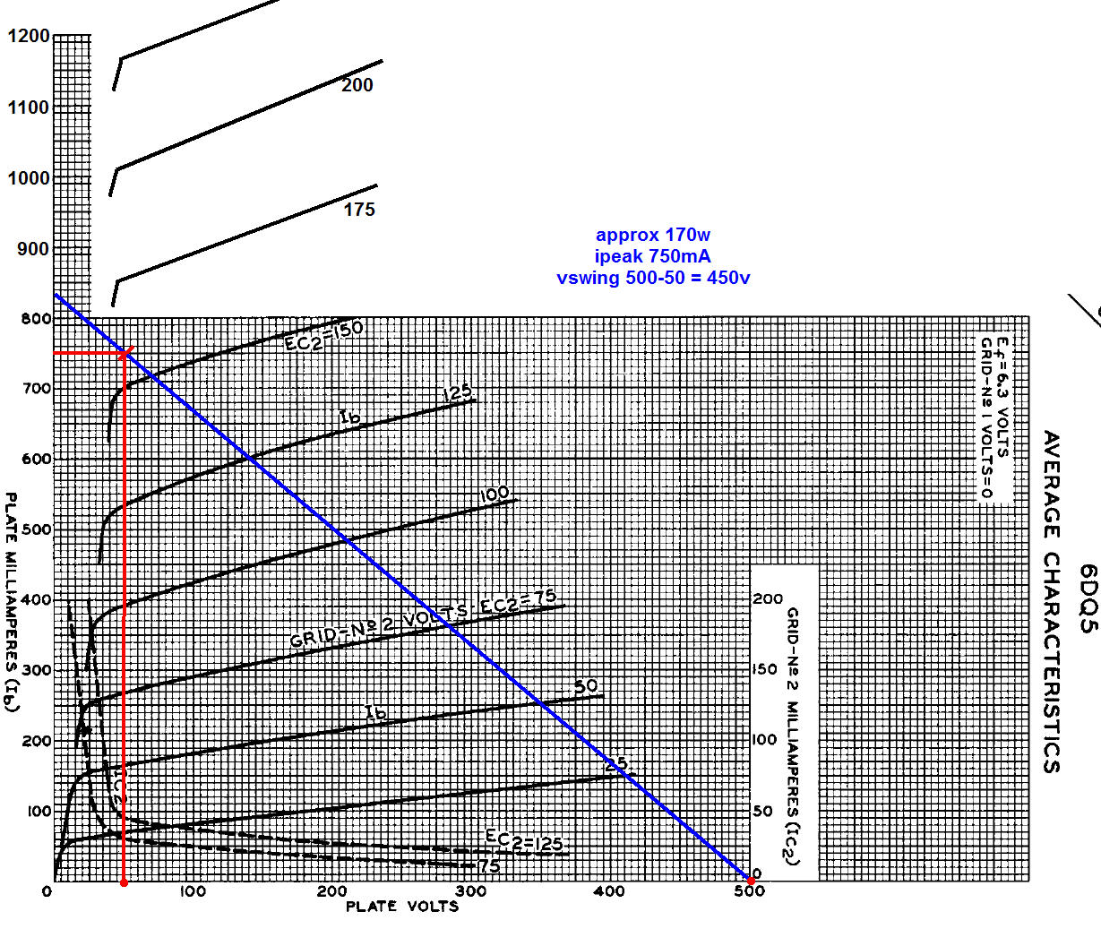

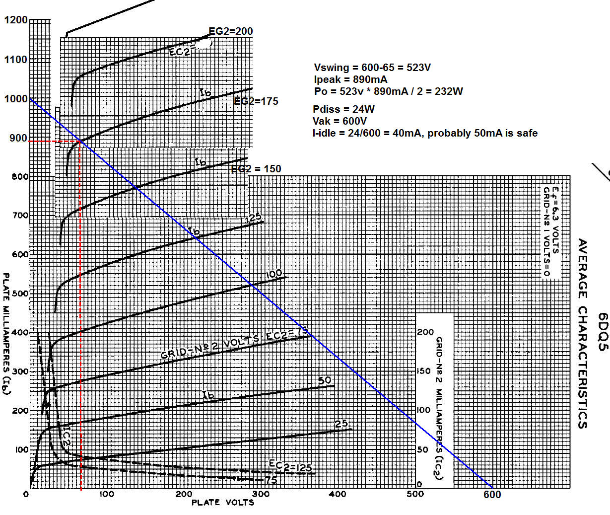

From the datasheet of 21EX6 vs 26DQ5
Maximum Plate Dissipation: 22W vs 24W.. okay
Maximum Peak Cathode Current: 770mA vs 1,100mA.. not okay. Are these tested numbers or the 21EX6 can actually reach the same 1,100mA? I need only around 900mA as that's what the Class B loadline for 2K4 OPT at 600V that i drew called for.
I could just settle for 150WPC using Vak=500V.. that's plenty enough for me.
I would have to go by the datasheet numbers on that.
For 900 mA, looks like 6HJ5 (1000 mA) or 21LG6 (1100 mA) or 35LR6 (1300 mA) would be your tube. (or 26DQ5 1000 mA) The 1st two are inexpensive, but of unknown availability. (try Vacuumtubes.net for 6HJ5, last I heard)
6/17/22KV6 and 6KM6 are another possibility, @ 950 mA and 20 Watts
(along with 6JF6, 6JG6, 6JR6, 6JU6 at 950 mA but only 17 Watts.)
another one, 6KN6 42KN6 1500 mA 30 Watt moderate price

6197 video tube curves. Pics 1 and 2: g1 drive pentode, and triode curves. Who needs g2 drive when you have g1 curves like this.
Will certainly give (in parallel) a unique linear power tube with outrageous gm. ( 11000 gm per tube ) Good triode curves too.
One could go even further with paralleled 12HL7 video tubes for higher gm. Were on the $1 list briefly, now $3. Frame grid 1, 21000 gm per tube.
(will need some g1-k diode protection to avoid grid current into frame grid 1) Pentode curves are maybe not quite as nice as the 6197, but curve tracer selected 12HL7s can give remarkably linear triode curves. (3rd and 4th pics)
