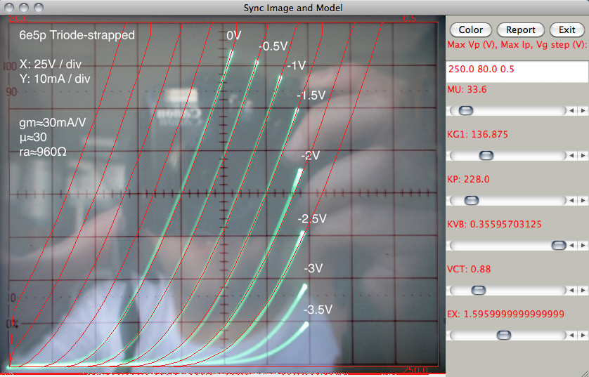

I wish I had an AVO!. After so much work managed to get my curve tracer working well. It's a challenge though to trace high gm valves, as the bias point tend to drift a bit so need to readjust just before taking the picture with the camera.

Indeed, the valve stabilised after 20-30min. I managed to get a model very close to Dmitry's.
http://www.bartola.co.uk/valves/wp-content/uploads/2012/05/6e5p-triode-model.png
I may have recorded incorrectly the tracer settings as it seems like the grid start voltage was -2V and not 0V....
Here is the model
http://www.bartola.co.uk/valves/wp-content/uploads/2012/05/6e5p-spice-model.txt
Ale

I was looking at the datasheet of that valve and the lifetime is stated 500 hours ?!?!?!
In that case, maybe the Pa (max) is optimistic. Just a thought.
Indeed. However can't comment on that as haven't used it yet.
Interesting to see that there is a close brother of this valve, the 6e6pe. Longer life one with similar characteristics. It's a bit price though, but may be worth looking at this one as well....

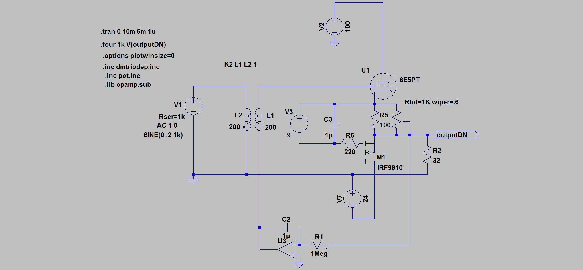

With P-channel depletion MOSFETs on the market it would have been even easier to accomplish.

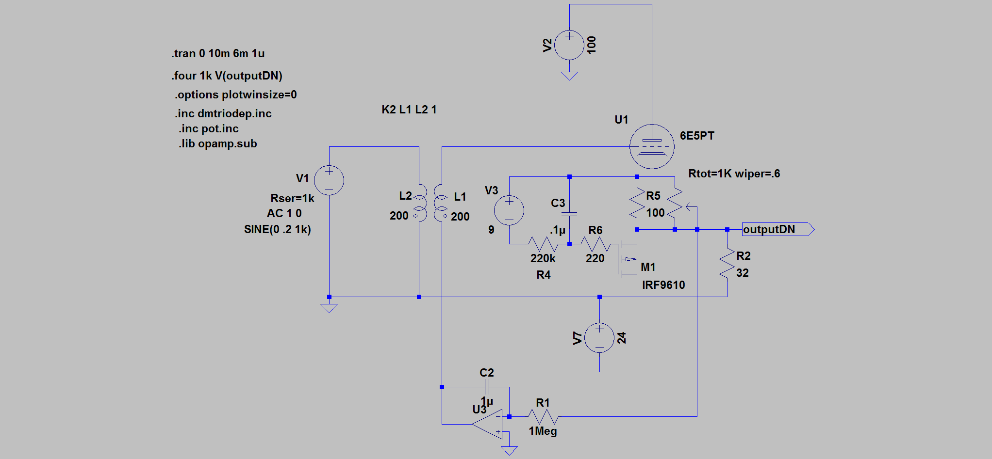

Well, it looks to me like a gyrator with a mu or anti-triode output (I think Michael Koster named it or referenced it as such), correct?
Same function. Gyrator this time?
Indeed, but I thought that when the output was taken from a midpoint of the source resistor, that would provide the lowest Zout (Zout/2) compared to the gyrator equivalent?
Wouldn't that be the case when taking the output from the pot?
NO, no gyrator at all this time this time. Look at the battery as a signal short. If you take the output from the midpoint, Zout gets higher, not lower. When taken directly from the source Zout will be just a few ohms. When taken from the midpoint you will get a useless ballpark Zout of 30-40ohm. So Antitriode is no option here.
Noooo, the second one is NO gyrator, the cap can be omitted.
Question is wether the the battery would harm fidelity? No current through it so one could try Lithium cells. Thorsten L. used them in series with signal when adding grid bias. Think he bypassed with a small cap and a large resistor though.
