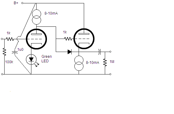

6DJ8/ECC88 mu-follower
I looked over SY's schematic a bit more, and I am thinking the grid leak resistor and the grid's impedance is quite tough for this dac. It wants a low impedance load and resistor to ground should be higher than 100R for optimal linearity from the dac. This implies driving the cathode, ala grounded grid, for first stage.
JB gives details on such a circuit in his blog. It requires a servo to maintain the 0V that the dac wants. (His circuit is drawn for TDA1541 but the same is true for the BB1704 iirc.)
