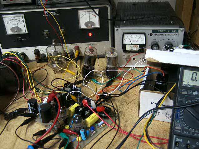

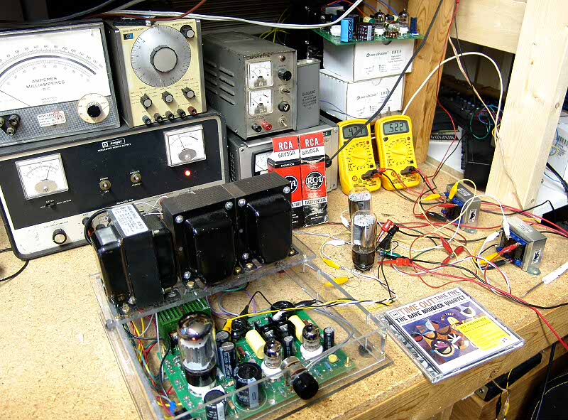

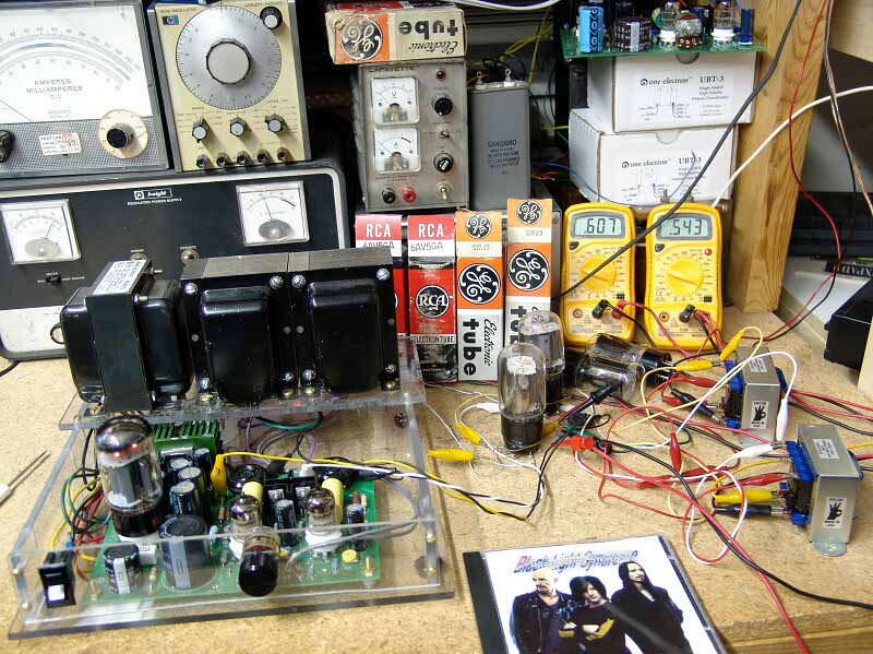

So, can you wire a 6AV5 into a 2A3 socket. Well, first you will need to find 6.3 volt heater power, and make up some socket adapters, but it appears that it does work. Includes are pictures where I wired a pair of 6AV5's into my TSE which was set up for 2A3's. The higher rated 6FW5 works too.
The 6CU6 is the same thing as a 6BQ6GA, and some tubes carry the same number. The 6CU5 / 6BQ6GA is similar to the 6AV5 except it has a plate cap.
The 6B4GA is an octal version of the 6A3, which is a 6.3 volt version of the 2A3, so you can see how that story evolved.
Note that the 6AV5 or 6CU6 may not work in all applications, and does not sound exactly like the 2A3, but it can be made to work, and sounds pretty decent.
