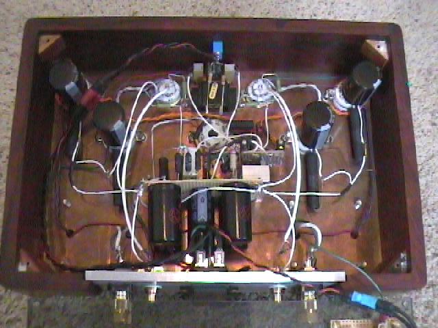

Hmmm. I've just read through this thread. Comments on the test measurements, though. Looking at your THD, you have a crap power supply. That's why you have sidebands around the distortion spectra. Aside from that, the spectrum is very nice indeed. In fact, it's suspiciously nice. What level were you using? What does the spectrum of the measurement system look like (do you have confidence in your measurements)?
EC8010 said:Hmmm. I've just read through this thread. Comments on the test measurements, though. Looking at your THD, you have a crap power supply. That's why you have sidebands around the distortion spectra. Aside from that, the spectrum is very nice indeed. In fact, it's suspiciously nice. What level were you using? What does the spectrum of the measurement system look like (do you have confidence in your measurements)?
The power supply schematic is shown above. I don't know how to exactly model it in psud, but an approximation shows about 7V of ripple for the B+ of the output tubes. The driver tubes are much lower. The output obviously has good psrr, as I get less than 1mv ac on the output, but I don't know how the ripple will modulate distortion.
With this simple setup, I don't know how to get the output level, as it's not a steady tone and it's difficult to measure with a digital mm. But I was estimating a watt or two, based on the listening level, as I had the speakers hooked up during some of the measurements (as indicated in the text). I don't know what the spectrum of the measurement system looks like, other than to say that in the card/amp examples, you can see the output of the system without the amp. That is, the line out loops directly back into line in for the "card" channel. I do hear the output though. One of the tones is identical to the MLS for Speaker Workshop. there are at least two additional tones, including one at lower frequency. If you've got better ideas on how to measure, I'd be happy to try. If I keep at this long term, I'll get proper measuring gear.
Sheldon
What I'm getting at is that you shouldn't be seeing that cluster of sidebands spaced 120Hz(?) away from the 1kHz fundamental and its harmonics. In my experience, that indicates a poor power supply, and often that the amplifier is going into Class B. That's why I wondered about what power level you had.
But you've lost me by saying that the output isn't a steady tone. Am I misinterpreting your images? I had assumed that your THD spectrum was the result of applying a steady 1kHz tone and then doing an FFT on the output of the amplifier?
