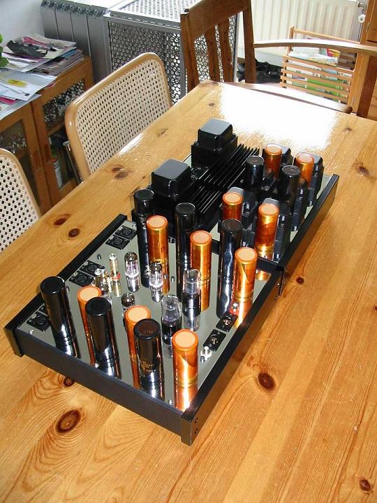

6c45 phono amp
with the 6C45 i built a phono amp. The tube is simply "invented" for that purpose.....
As stated in other replies: low on voltage and milliamps. And i also had to use gridstopper (used a tantalum 150 ohm).
The amp is built on 2 chassis. One for audio and the other is the powersupply. Picture included.
Schematic in words:
6C45 - RIAA - 6C45 - interstage - 6SN7 - output transformer.
Why: because there is only one tube manufacturer of these tubes. So: take it or leave it. With a 6SN7-stage after the phono-amp itself i can finetune the tonal quality with the abundance of all available 6SN7's. At this moment i'm using KenRad's for the 6C45 does sound a little cool and the KenRad's just bring the total sound back in balance.
Powersupply: massive. But now the amp is extremely quit and stable.
