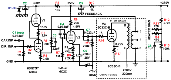

Hi!
In the schematic there is a 500 written near the output transformer: is it the reflected primary impedance with a secondary load of 8 ohm?
Thanks!
Ciao
Paolo
Hi, I looked at Gabriel's distortion results and I was so curious that I did my own simulation with just basic approximations (references : Ed. Morgan Jones 3rd edition p. 380 , 6c33c russian/english schematic for curves with 60 W dissipation, The Valve Wizard -Single Ended for the power formulas).
I could get to very low distortion for Gabriel's amplifier output stage given 16 watt of max output ... ((Vquiescent - (Vmax + Vmin )/2)) / ( Vmax - Vmin) %
(210 - ((100 + 310 ) /2)) / ( 210 ) = 2.4% and lower, I had 110 V that I arbitrarily reduced to 100 given line tracing errors...
With parameters 210 V , - 75 V bias, 220 ma, 500R primary inductance, I have no idea how it is possible to reach more than 16 watts without increasing the distortion from clipping on the negative biased grid which is getting so negative than there is reverse current beyond around 310 V.

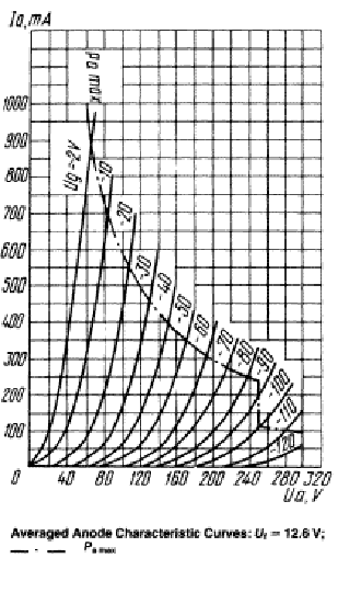

If I go this way, the ideal should be to recalculate the bias voltage using the diagram of the tube (see attachment).
In my last listening test, I got the better sound with 176V anode and 275 mA. With a Bias of -65V.
I would like, but I don't know how, to calculate the ideal charge bar and the ideal Bias based on the diagram and the secondary PS transformer voltage which becomes to 212V CC at the output of the power supply. By the way the current for this secondary in the transformer is 600 mA.
To simplify, I get 212V CC and 600 mA after rectifying.
Based on this and the 6c33c tube operating diagram, what is the best Bias voltage, and current and voltage to apply to the anode of the 6c33c with the R17 as it is (see the amps schematics) ???

Try to adjust now the curent of 6C33C don`t bother about the 250V of the driver.
Try to adjust the tube at 220mA the voltage is low because the tube works now at higher current. Try ti stabilize the tube at 220mA = 220mV at R17 and tell me what voltage you have after.

I could manage to put the 220 mV to the R17 as suggested by Gabriel.
To get this value (very constant) I had to set the Bias to -70.5 and the anode voltage was 183V. The issue with the high frequencies came back, the power at the ear decreased as well as dynamics.
Then I made a series of new tests paying with the Bias voltage, between -60V and -70V.
The best results were when Bias was -64V, current 258 mA and anode voltage 176V. With these values, all became again nice and stronger.
I think that it should be a good thing that I could get the calculation I explained in my previous post.

Yes those were the custom Electra print OPT's. I was limiting the plate dissipation to 45-50W for best tube life/reliability/safety. The new amp will have wider spacing between the output toobz. I will have to re-do the impedance measurements; I think I was getting closer to 700 ohms into the 8-ohm resistive load woth the Hong Kong OPT's.
For 600 ohms and assuming a saturation voltage of 40V with the 45W plate dissipation one gets approximately 180V and 225 mA. Actually running the 160-170V and higher current provides better performance at lower power settings. With the 6KV8 triode-pentode drivers I have the option of running triode mode or pentode mode with a local feedback loop to the plate or cathode of the preceding voltage amplifier stage.
I think it will be cleaner sounding, less distortion with lower HT . Example : 13.6 Watts , 3.55 % 2nd harmonics at bias -40 , 350ma, 140 V HT. Also for this setting the load line is closer to the tube dissipation limit and in a more linear region of the Ia/Va curves.
Also less variation in the HT voltages is required :
183 V variation vs. 230 V variation for a 210 V HT at 180 ma

Hi Jose
Try to use the tube at 210v with 220mA or more if is possible.
the maximum current allowed for this tube at 210v is 280mA but is to much for your power transformer if he has only 600mA for both tubes.

Today I made complete test of my 6C33C amplifier
Unfortunately I forget my camera at home and no photo yet, but the amplifier is it at my office and I will make some photos to show you what I measure.
Equipment and measurements conditions.
Function Generator 1 Hz-1 MHz Made in Romania
Output voltage 2.5V rms.
ShibaSoku 760E/2 Automatic Distortion Meter Made in Japan
20Mhz Oscilloscope Made in China
Output loading 8 ohm
OPT Ra 550 ohm
6C33C voltage 210V
6C33C current 220 mA
All the voltage exactly like in Borbely schematic
Input AC voltage regulated 230V
Preamp tubes General Electric NOS 6SN7GT
Driver tubes Russian NOS 6C2C
The measurements were made with NFB
The results
Sine wave 1 KHz
Output 2.83v rms 0.22% bandwidth measurements at this power 10Hz – 100 KHz 0dB
6.3v rms 0.35%
9v rms 0.65%
11v rms 1.35% bandwidth measurements at this power 25Hz – 25 KHz 0dB at this power perfect sine wave without attenuation.
Maximum voltage 14v rms 19%
All this value were read with the Distortion meter
Photos in a few days if I will have free time.
Best regards
Excellent results. However, sorry, I do not use ( read : like ) the overall feed back.
Hereafter the results of the tests made with the ARTA solftware on the
"Duplex" , fitted with the "double ended OPT" . Those with the "self compensated" will follow.
1) with 10V RMS output on 8 ohm ( = 12,5 W )
THD 3,11 % IMD ( 18,5 and 19,5 kHz) 2,9 %
Frequency range at -1dB 20 Hz to 20 kHz almost flat
Z out = 1,4 ohms Damping factor = 5,7
2) with 18V RMS the frequency range, at -3dB is < 15 Hz and > 50 kHz
No overall feed back but just local feedback in the driver stage.
I will continue the tests with the self compensated OPTs before end week.
Ari
