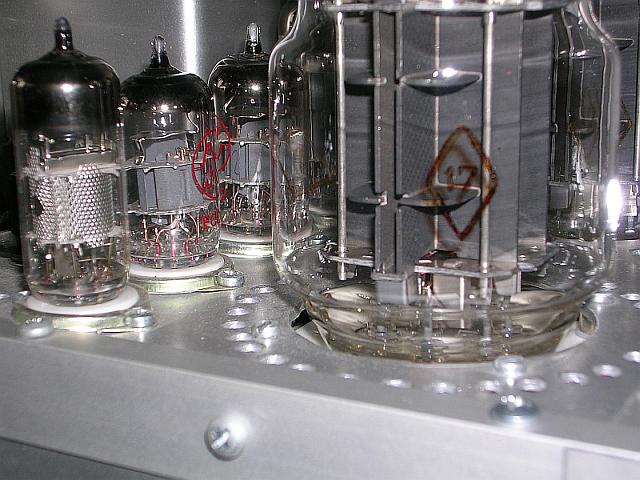

Very interesting.... Just, as this shouldn't burn away oxide particles on the plate... In new tubes, I see them often as white glowing points, and usually soon after there was a flashover just at this place - the particle finally vapourised, and I think that its gas cloud was the reason for arcing.... So I was concentrating on burn-in to get rid of these particles.
My amp is a completely symmetrical design (my pre-amp has symmetrical output). Pre-stage is a diff-amp, its two legs with ECC 82 in SRPP and CCS EF 184. Capacitor coupled to the driver, a mu-follower with ECC 99 generating the voltage swing for the power tubes and 2x PL 84 as cathode followers. Bias regulation for the power tubes is via the screen-grid voltage of these pentodes. 6C33CBs are directly coupled to the PL 84-cathodes, potential difference between the PL 84-cathodes (around +20 V) and the power-tube's grids (-130 V) is maintained by (no, don't scream, it works perfectly - I love to try new ways...!!!) OA2 gas stabilisers.... ECC 99 plate current is ca. 20 mA, quiescent current through the stabilisers is 15 mA. ECC 99 cathodes run through a bifilar neg. feedback winding on the OPT to their common bias resistor. In my experience, this single-pair circlotron sounds much better with a low-ratio OPT than in OTL mode. I can switch between these two modes.

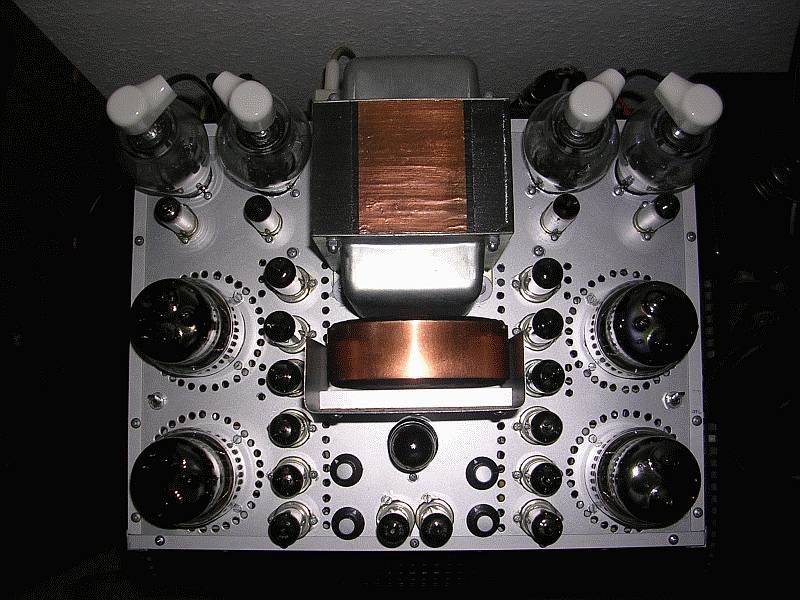

my amp from above...
the mounting of the power tube sockets for forced-air cooling
The big transformer is the plate and bias transformer only (custom made by Sowter, UK) - heating transformer (toroidal) is below it under the chassis. In front of the transformer the big PFC choke (to compensate nearly 5000 microfarads in the 5 power supply rails...) with a magnetic shield. GZ34 bias rectifier is in the middle in front of it, with the four knobs for bias adjustment.
This was an immense project, it proved to be much more difficult than I expected at the beginning.... but it was worth every effort!

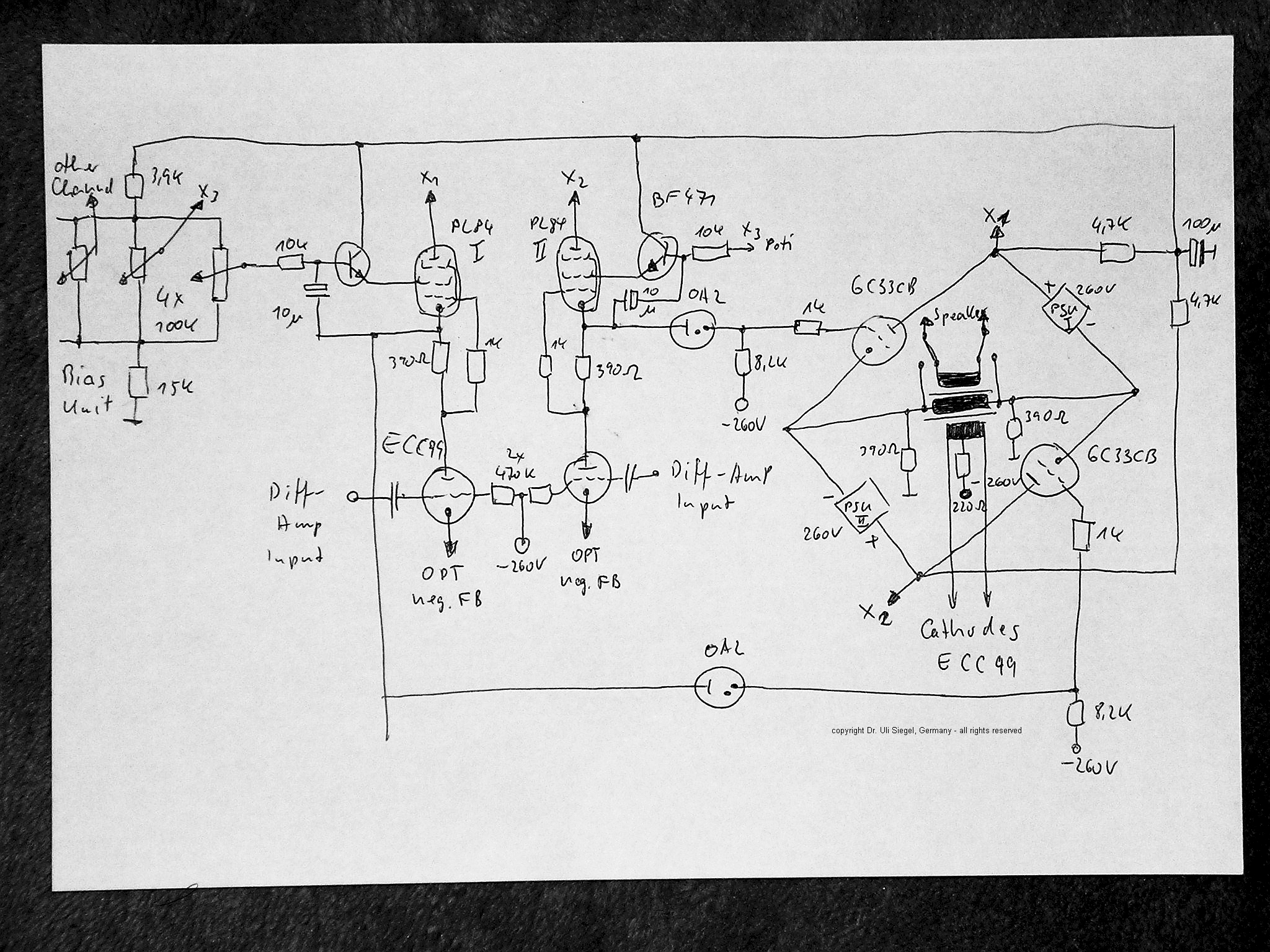

I don't have a "good" diagram, only a quick-and-dirty sketch, but I think it should be sufficient:
Uli's circlotron diagram big
small version
Oh yes, bias setting is over transistors..... but potentials didn't allow for using a regulator tube (maybe a low-voltage type like ECC 86) at this place. BF 471 needs hardly any cooling - a few square cm only. This kind of operation assures me plain pentode service (screen on cathode level for AC without using high-power potentiometers for bias setting) to obtain lowest output inpedance.
Driver is powerful enough to drive the power tubes far into grid current area - until the PSU fuses do an emergency break... ;)
There is nothing special with the OA2 potential shifters.
OPT is a simple 160 VA mains toroidal type with 2x 115 V primary in parallel to 2x 15 V secondary in series. They are sitting below the chassis under the power tube sockets.
Negative feedback winding is 20 turns just wound bifilarly (bell wire....) around it by hand.
any questions? ;)
