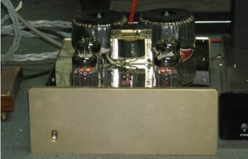

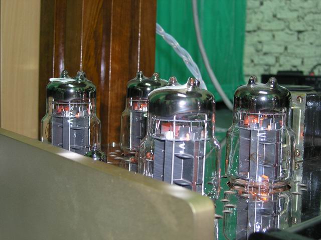

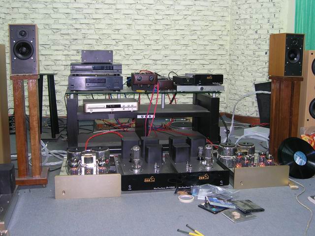

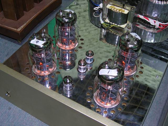

Dear Friends,
Thanks for my friend Wood's assistances the job finally came out. It is a very good Christmas present for me although it needs further modification. The schematic had changed a lot from the original design and I will post it later. The photos were took in Wood¡¦s studio.
Happy New Year,
Patrick
PS. I don't know how to include the images in text. Can anybody help?

Happy new year Patrick!, good to hear that you made it work!
The measurements look interesting but it is difficult to read the scales, is it correct that distortion reach 1% at about 85W?
Do you know why distortion increases so much at lower frequencies? have you deliberatly limited the open loop frequency response on the low frequency side?
How much feedback do you use? and what is the anode voltage to the output tubes?
Regards Hans
Happy new year Hans,
Thanks for your prompt response.
1KHZ distortion data as following:
0.1W - 0.28%
0.5W - 0.18
1W - 0.175
2W - 0.21
5W - 0.3
10W - 0.48
20W - 0.7
30W - 0.87
40W - 0.97
50W - 1.1 (max. unclip output)
60W - 1.45
75W - 2.3
85W - 5.5
(I found that the voltage swing of driver output were not enough)
No, I had not limited the open loop frequency on the low side, please tell me why?
Gobal FB is 6dB and in-state FB is 10dB. Anode voltage 145V (intend to reduce to 130V), current 300mA (intend to increase to 400mA).
Regard
Patrick
Hi Patrick,
Anode voltage is lower than I expected, I am using around 150V in my new OTL using 4 tubes and getting around 80W at clipping, I will increase to 160V and expect to get 100W, current is 200mA per tube.
The reason why I thought you had reduced the open loop response is that the distortion is increasing for lower frequencies which is not what I would have expected as there would be high open loop gain and therefore as much feedback as for mid band frequencies. Do you know why it behaves like that?
Regards Hans
