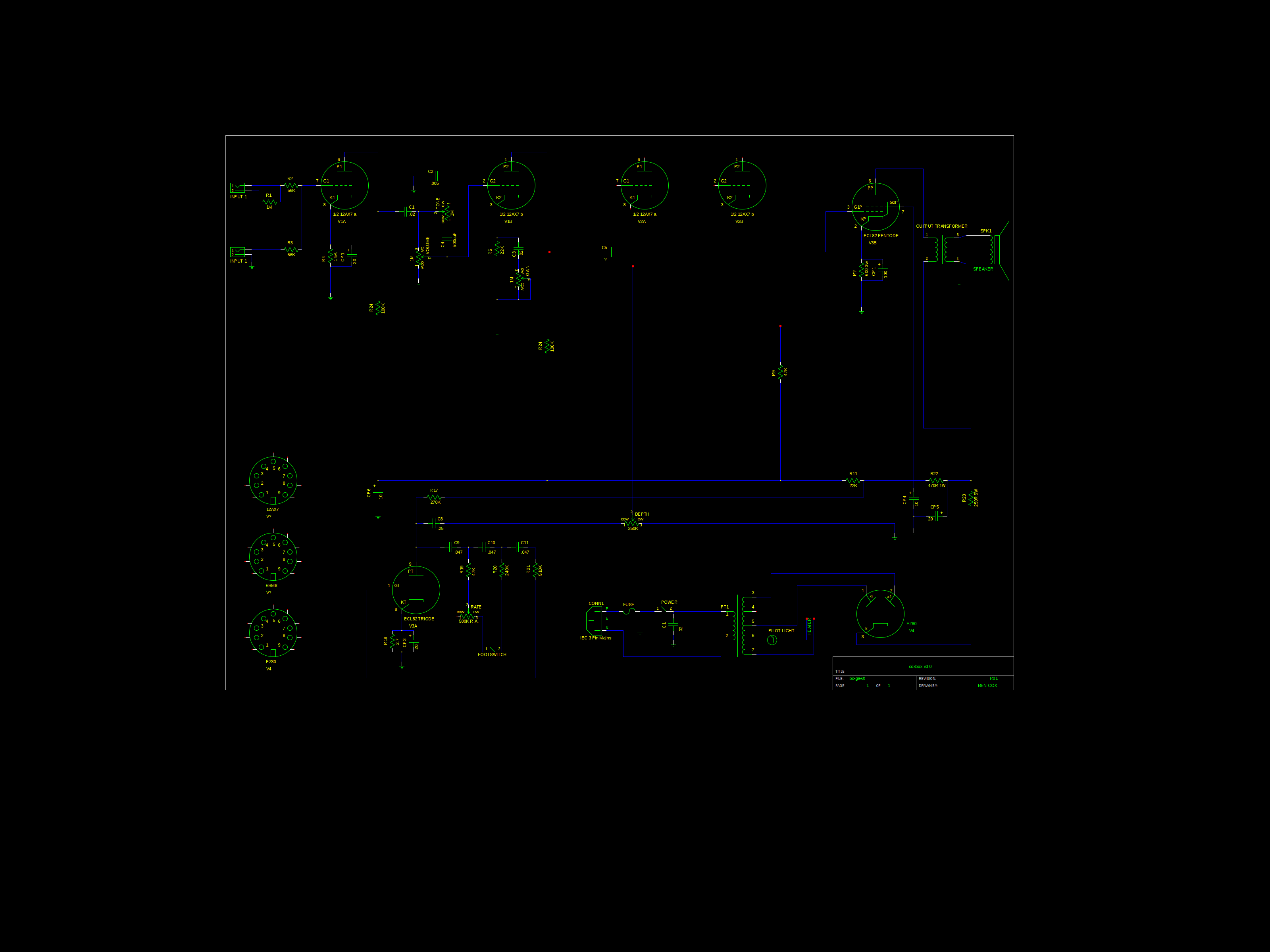

So I've decided to go with Ian's and build a (fairly) quick SE design with virtually the same circuit as the schem in my first post, only with a single ended output.
Correct me if I'm wrong, but, this should be achievable because one of the 6BM8s is using the triode section as a phase inverter. The pentode section becomes half of the PP output.
Is there anything stopping me (besides my lack of experience) from adapting a SE output to this design? I'm guessing there needs to be some sort of coupling cap?
I've been reading a PDF that I found somewhere called "Designing Valve Preamps for Guitar and Bass : Chapter 1- The Common Cathode, Triode Gain Stage"
I would like this build to be my working prototype for designing my perfect gain stages, eventually using 2 preamp valves.
You do not need the phase inverter stage, it operates at about a gain of one anyway so a SE output tube could run right after the first two stages. You will have to use an appropriate value cathode resistor on the output, probably the one you have now. I would guess the output and tremolo on the output will work if you just remove the bottom half of the circuit.
I have drawn up the schem for what I want to achieve, besides some R & C values, is this topology correct?
I don't know where the DEPTH pot should connect the tremolo stage to the output. After C5?
Is R9 required? It was part of the inverter in the old circuit I think.
Have I put the GAIN control in the right spot?
So far I'm assuming that my B+ will be correct. Next task is to measure my PT.
I would really appreciate any help with this one as I learn. I have a friend who is comfortable with very high voltage but doesn't know anything about tubes. He's going to help me out with a variac when it comes time to turn this on.
