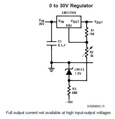

I recently found the schem. shown below. What do you think of the CCS implementation on the output stage?
Jeff
The CCS's themselves look good, but remember that this approach always restricts operation to class A. Since you are running class A why not go differential as in my design ?
The big electro caps are already in the signal path, but running therm back to back would helps to reduce their distortion. Sound wise you should expect a cleaner sound. The only slight consideration is that the caps need to be doubled as they are in series and so their effective value is halved.

One thing to consider if using those CCS's is that the zeners are essential. I found out the hard way that because of the direct coupling - on switch on the cathodes can have the full B+ of 300V across them which will fry anything less than a 500V rated component instantly. I am using the 900V IXY chips as a result. The zeners will absorb this switch on surge.
A time delay on the +B will help protect the output valves which otherwise are asked to conduct hard with cold cathodes - not good
