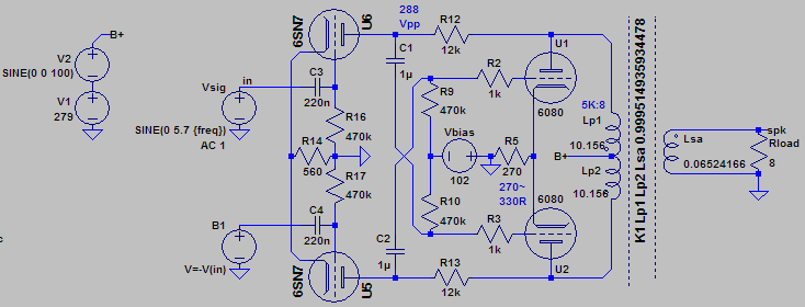

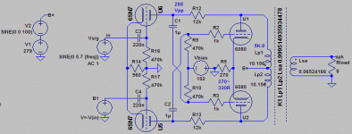

Have a look at the schematic below for a 6as7/6080 driver + output stage combo:
  • that does not burn high wattage in the cathode resistors
  • is easy on the Ub (+280V)
  • is able to comfortably swing 290Vpp on the drivers, without any exotic parts or phase-bending iron
  • gives high output with low thd (~13W, ~ .5%) in pure class A
some gnfb will tame the zout and any overshoots.
attachment.php
