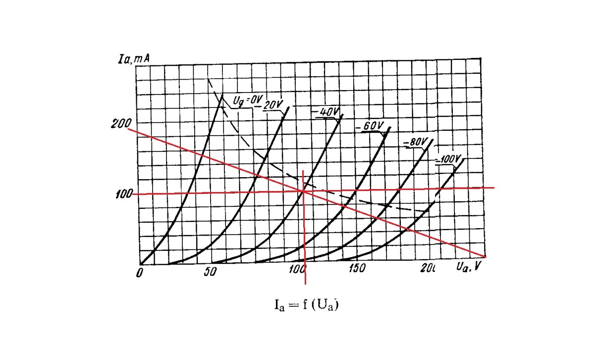

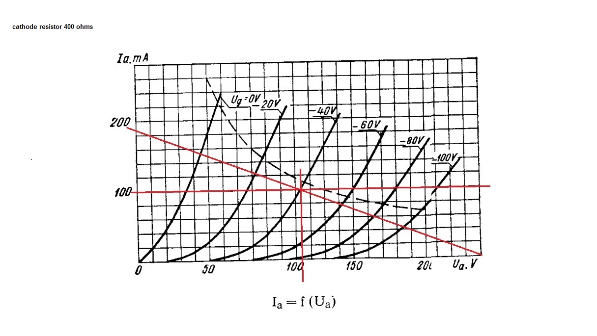

I'm thinking of a bias point of 100ma at 105 volts which will give me a grid voltage of -40. I did the calculations and came up with a plate resistance of 353 ohms?
131-85/170-40=46/130= 353?
Based on that I'm looking at an Edcor 25 watt 1.6k output transformer.
Too late to edit/delete so scratch the power transformer. I'm going to need more voltage. If I use a parafeed cap at the center tap of the output transformer there will be no DC on the primary. But there will be no resistance between the plate and ground through the power supply. So I will need plate resistors to get any gain won't I? Hadn't thought about that until I was almost asleep just now.
B+ will be 240 volts. I was talking about the bias point. That's very near the dissipation curve. Was I unclear in the previous post or are you talking about even more B+?

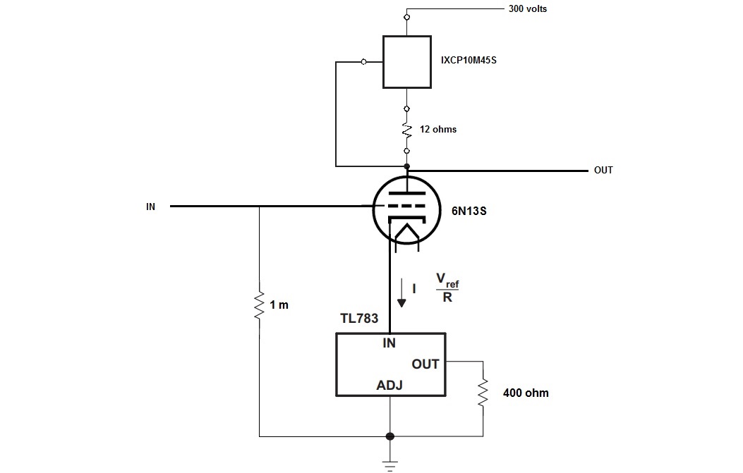

First let me say thanks for all the help I've received so far. I've wanted to build a powerful all triode amp for a few years now and I think this is going to be it. I've received some help off the thread via PM that has lead me to the attached schematic snippet. I would appreciate it if anyone could point out any obvious errors.

I'm really green when it comes to SS devices so you may be right. As I understand it a CCS (either flavor) is very good at ripple rejection. From that I assume they also reject signal as well, since audio signal is AC. I was assuming that bracketing the tube would leave no outlet for the signal current except the output therefor maximizing gain? Plus, using the parafeed cap will be a short to ground for the signal creating a path towards the output and the CCS's will encourage that won't they?
As for the placement of the parafeed cap placing it between the plates and the primary or the centertap and ground would be easy to change. So this may work as the experiment Broskie mentioned.

I've decided to use Pete Millett's uniamp as a front end. Its a two stage using 6SN7 in a differential amplifier. I've used it to drive 2A3 and AD1 push pull amps. It swings 235 volts peak to peak. Its at heart two long tail pairs so a pair of CCS in the tails should lower the distortion even further. I have a box of 6SN7 and all the passives in hand.
Unfortunately this is not happening.
The 6AS7G PP output stage create quite high (~4%) THD.
One very often used method to reduce THD is to use distortion cancelling, which is to bias the driver stage to create similar THD spectrum which is then compensating the THD of the output stage.
If this is done properly, the overall THD drops from 4% to below 1%.
So if you build a Hi-End driver with minimum distortion, you will get a non Hifi 6AS7G amplifier.

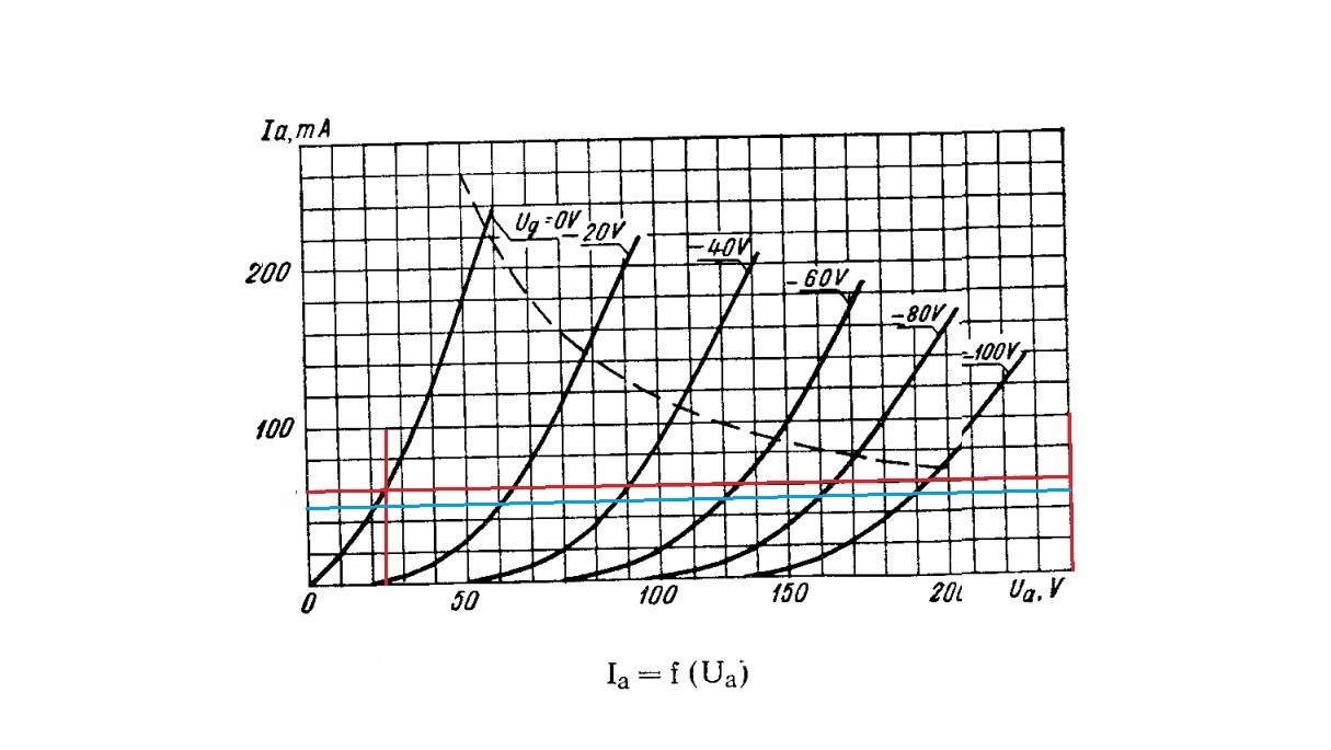

Thanks Shef. I've been looking at the load lines and I've included two examples. One cathode bias and one with dual CCS, Source for plate and sink for cathode. First off the grid voltage for 6N13S is -40 not the -125 for 6AS7. At Shoog's suggestion I plan to use a current source for each plate and a sink for each cathode. That should, if I'm right, provide the best rejection on both ends and should minimize the difference between triode halves? With cathode bias the grid voltage would be -40 at the bias point. With the CCS load line to stay under the 13 watt dissipation limit I would need to keep the plate current under 52ma for 250 volts of B+ or 60ma and just not drive the tube so hard. Or drop the B+ to 215 volts and up the current to 60ma. Is there any way to know or guess what would be the best way to go?

Everything is very approximate, taken from the plate charts with consideration of 250V is a max B+ for 6080, but barely enough for the SRPP first stage.
