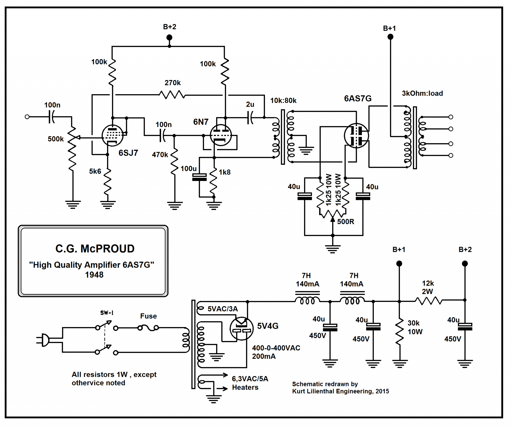

One question ,in for exemplet "koonw's" first link theres an interstagetrafo used as a fase splitter.
I read that some People say that an IT trafo destroys yhe sound.
Or is it just what some People say and The other half dont?
Disabled Account
Joined 2013
That was in 40's maybe other phase splitter didn't even exist.
I notice that is capacitor para-feed circuit, so may be even better than an air-gaped one, you probably can use PP type IT, so low DCR winding and non-cap coupling guarantee no DC blocking on power tube grid bias.
Disabled Account
Joined 2013
You mean idle current in primary OT? Ia is equal to Ik, where Ik=2.2k, Ia=Ik=125/(2200+500/2)= 51mA

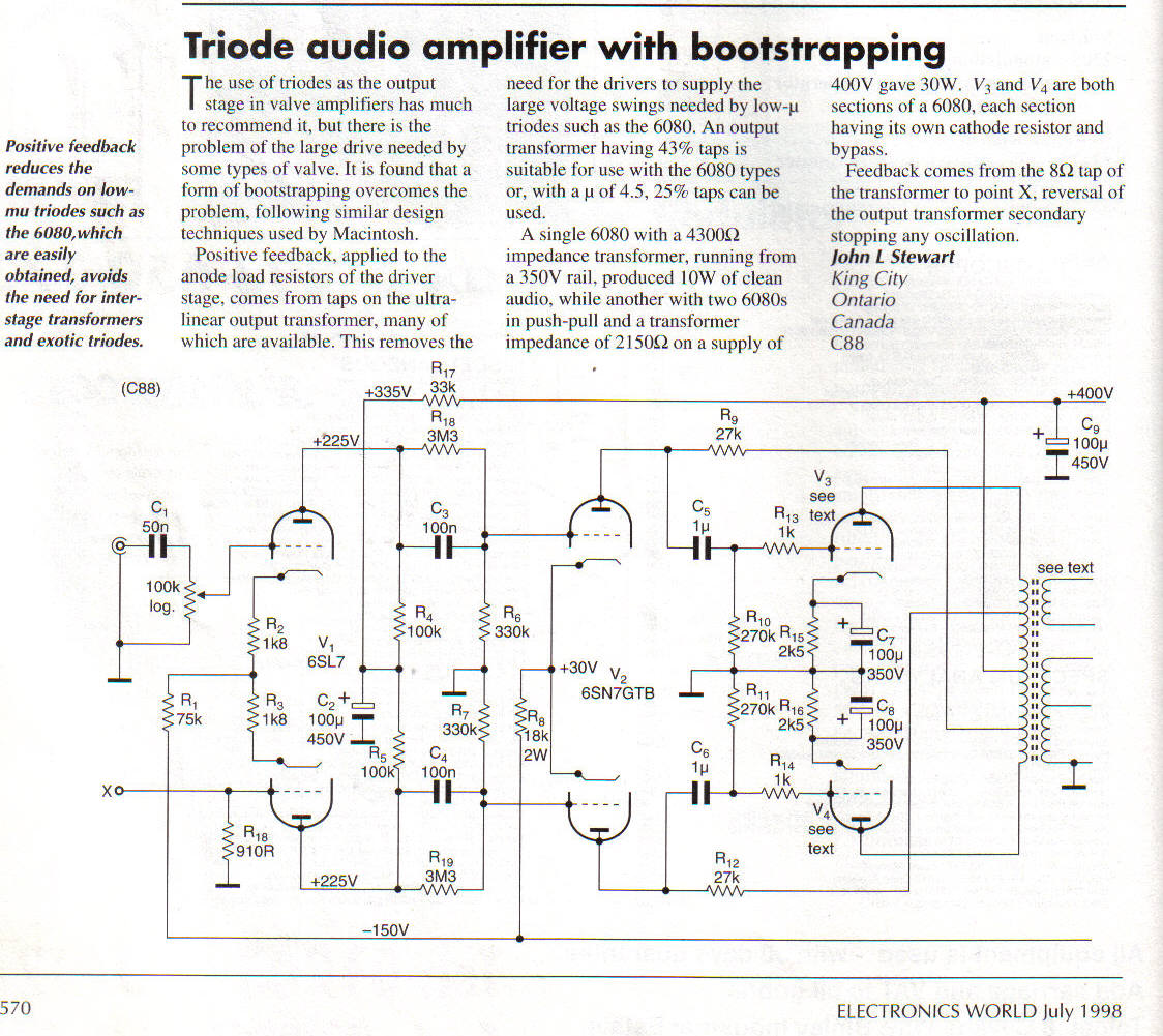

Another way is to replace cathode resistor with constant current sink for each cathode, these do away with any need for adjustment.
https://www.diyaudio.com/community/threads/transformer-coupled-6as7-6080.91626/post-1098816
That is another improvement over McProud amp
