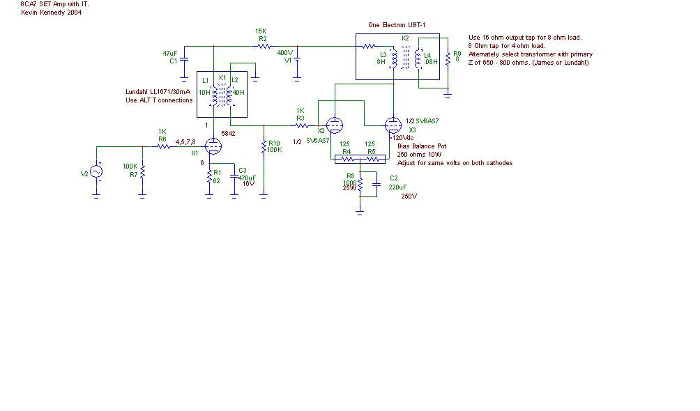

Here is a circuit you might be interested in trying, note it is not a done deal and there is plenty of room for artistic license.. Also I have not actually built this circuit, although I have simulated it in mcap with good results. (I find generally good correspondence between these simulations and the real world on other projects. I have built very similar circuits using other output tubes.) You will need to design a power supply using PSUD or similar for about 275mA at 400V for a stereo amplifier. Note that the 6AS7 will be dissipating about 20W total.. See here for information on 5842 and 6AS7 (6080 will work too!) : http://www.mif.pg.gda.pl/homepages/frank/vs.html just use search and download the appropriate data sheets. Note that output power is going to be directly dependent on the output transformer you use and at a primary of 600 ohms don't expect more than about 5 W out. I recommended the UBT-1 because it is easy to get, but in point of fact it is not the optimum choice, it will work well if you follow the guidelines in the schematic.. The primary dcr of the UBT-1 is high at 165 ohms and this implies both heat and significant losses in terms of available output power. Lundahl and James both make good alternatives to the UBT-1.
Both James and Lundahl also make suitable IT transformers, but the Lundahl is frankly better if harder to use.
It is really important that you do not omit or reduce the value of C3 as the low frequency response of the driver stage depends on the lowest possible RP out of the 5842.
In terms of filament supplies the 6AS7 cathode insulation is rated at 300V and the design is nowhere near that and the filaments may be heated by AC and I recommend 6.3VCT with the center tap being grounded.. 5842 may also be run off of the same windings and any combination may be used as long as the overall current requirements of 2.5A per 6AS7 and 0.3A per 5842 are meet. Twist the filament wiring to reduce hum induction into the other circuitry.

Replace the generator symbol with an rca jack, that is the input. Use PSUD to design your own power supply.. The program will provide all the information you need to design it.. Post the details here and I will review it to make sure it is basically correct. The program I am referring to in its latest incarnation can be found here:
http://www.duncanamps.com/psud2/
A very useful tool, and you will have the pleasure of designing it yourself. I recommend roughly a 10H choke, 47uF/630V film caps from Solen in Quebec (online) and a pair of 5AR4 in parallel for rectification - alternately a 5U4 may be used but you must allow the 6AS7's to warm up before applying B+ to prevent cathode stripping so use a switch in the center tap lead of the high voltage secondary.
