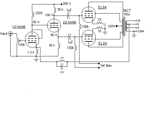

Hi
do you think this schematic needs some corrections ??
I thank you in adance
regards
Franco.-
Fine as I can see Franco!
I presume you have checked the voltages - I do not have 6AN8 data as triode. You use this as a low gain amplifier, directly from CD etc. I presume. You could use the 6AN8 as pentode if ever more gain is desired - don't be discouraged by urban legends regarding pentode input stages.
