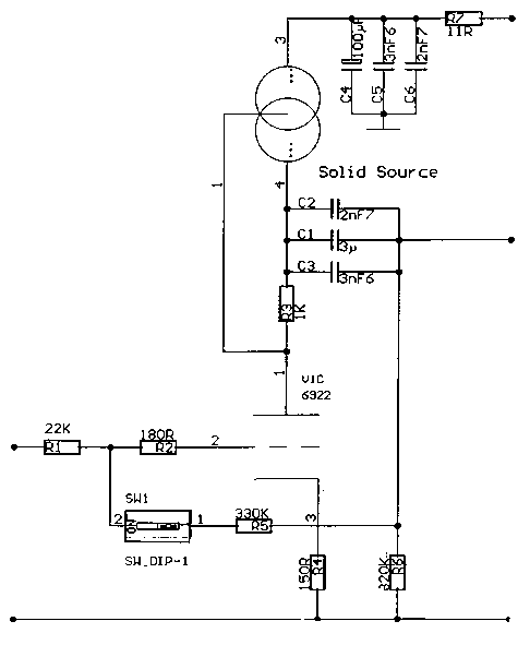

i do not use the same stage topology as Selbstzweck (end-in itself), it came out of design considerations. I wanted to get rid of coupling caps, knowing how even the best mess up the sonics. Choke loaded long-tailed pairs have the beauty that AC-wise, they are DC-coupled and high-z towards the PS. DC-wise lower bandwidth is limited by choke size and they are low-Z towards the PS. So if separate PS( voltage)s are used for the stages, stage n's PS voltage determines stage n+1's grid bias voltage and it does so rock-solid, low-Z, without drift. Quite soothing in a DC-coupled amp.
Now the only cause for the amp stages so sit in the corner and not at desired operating point is 1) warmup-effects and 2) tube parameter imbalance (caused by poor matching or by aging of the tubes). So each stage n has a small variable resistor in series with the one of the chokes to balance stage n+1. Has to be done regularly.

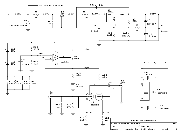

Hello Bernhard,
This maybe beside the point but still:
-As I understand it your circuit topology requires the user to adjust for drift on a regular basis.I think this is Ok for someone like yourself but surely unacceptable (no offense ) for the everyday user ?
-What I don't understand though is that you try to regulate the PSU on a preamp where hardly any current is flowing.For a choke to regulate sufficient currentflow is required,too much of it and it will swing and saturate it's core.Am I missing something here ?
-My approach to the problem is active valve regulation on a per stage/channel basis : series pass device/comparator/voltage reference tube.
When implemented correctly this is rock solid and has low Z.
-Ok,so you need to adjust things after switch on probably because the tubes need their cathodes to reach operating temperature.If this is the case you're very likely to damage the tubes.
One solution would be to use a valve rectifier EZ81 style and in case you argue about the sonic impact you can still get around it by a timer such as a N555 which would trigger a nasty rectifier bridge once operating voltage have stabilized ?
Active regulation with valves would also give you a slow and natural ramp up of B+.
Most people don't realise this but most components get killed at switch on,valves are even more prone to damage since they depend on their cathodes to operate.If one doesn't respect this cathode "stripping" will occur.

Frank,
i intended to feed each stage on each channel with a separate shunt reg.
1st stage: 2x EC8010 or 5842, 2x 25mA
2nd stage: 2x 12A4 2x 23mA or 2x 5842, 2x 25 mA
3rd stage: 2x 12B4, 2x 34mA.
I would not call that close to zero current. 164mA per channel, would quite a beast of a shuntreg and then, how do i get each stage's B+ where i want it for DC-coupling.
Better separate regs. And no interstage crosstalk via the PS. And i have the only really expensive thing of those shunt regs already: MKV caps to sit on. I have 120 or so.
Rectifiers will be a quad of fat TV damper diodes like the 6CM3. A Graetz bridge of them will deliver 800mA. That will do.
You point with the heatup are well taken.
I like soft start provided by tube rectifiers and i lave the absence of garbage injected by SS recitifiers in maplifier and wall outlet.
Manual balancing could also be done by a µC and cheap stepper motors. IN the future. But i will have to try out 1st how much imbalance this preamp takes. And how this develops with tube aging.
This is a preamp with DC-coupling over 3 stages and adjsting ablace from time to time will be a small price for that. Dunno if i get this product of insanity running at all, but if i succeed, i will not complain about adjusting the balance now and then.

Re: stein line stage with ecc88
Klaus,
to me this looks like an integrated CCS with R3 as current sensing resistor, acting as active load for the tube. With SW1 open, this stage will have gain of 33. Like the µ of the tube. Sw1 closes neg. feedback loop.
To me this looks not like an SRPP. The CCS simulates an almost infinite resistance so R3 is irrelevant as far as output swing is concerned.
Klaus,
lohk said:any comments about this hybrid SRPP circuit ?
Does anybody know more about the ominous "solid source" ?

To Lock,
Thanks for this Dusan Klimo circuit.Having met the designer on several occasions and moreover having listened to his designs I came to respect his work a lot.
I think his circuit is a very good compromise considering the combination with his Merlin preamp.
Very possibly one of the best prepre's I've seen on paper.
