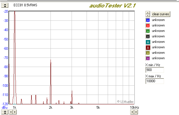

Response
"Way back I thought the same about the ECC81. Now I changed my decision. Look THIS thread please."
Yep, the Ecc81 has approx 10k ohms Rp, mu 60, and gp of 1.6pf.
Hi Anatech,
"I personally do not care that much for the cheap little 6DJ8. It was designed as a UHF tuner tube in cascode operation. It was never conceived as an audio tube. So it started life as a cheap TV tube. Yes, it can perform well and I will not take that away from it. It does well when designed with properly, but then again, so do the other tubes."
Hey it was designed for minimal sideband production, so low distortion is required. In fact the E88cc is very low in distortion.
So stop the crap.
"Mr 6SN7 kicks the 6DJ8 when you need large voltage swings. BTW, the 6DJ8 was designed with high plate current and low plate voltage in mind."
And I clearly mentioned that in a diffy circuit, the E88cc can produce 70 volts p-p with .05% distortion, with the same gain, and with a lower output Z than the 6sn7. But the response was concerning Miles post, which was preamps, and the misconception that only 6sn7s are any good.
Sy added the comment about large swings. Let's get back in focus, shall we.
"It's not happy when used at the higher plate voltages and lower currents that were typical of audio designs."
That is BS and you know it. (Maybe not since I see your next statement below.) Don't try that cheap trick 'not happy' crap with me.
If you were to check the JJ tech sheet, the tube can be run at 220 volts at less than .8 watt plate dissapation and they sound great. I run considerably less plate voltage. I have been doing it for years, and the tubes have been lasting for years with no problems.
Unfortunately, you really don't understand much, or else you have nafarious intentions behind the charade. See next.
"Hmmmm, high voltage and low current. Sounds like a high impedance circuit to me. That would be Miller time I guess."
Well, a typical tube tech (not even an engineer) would be laughing right now. If one simply inspects the plate curves of the E88cc, one will find the Rp remains almost constant until the plate current reaches down about 2 ma, maybe 2.5 ma.
So just any tube won't do, as you would like to deceive the audiophiles into believing.
So your last few comments just demonstrated how ignorant you really are about tubes and designing.

The 12at7 is a very high distortion producer, as well as limited bandwidth. Take a look at the curves from the links below. And actual measurements have been performed.
I missed that one before. Have you actually set up a good 12AT7/ECC81 in a grounded cathode circuit and measured linearity? I have done so with about 30-40 samples at varying currents and bias. My results have been posted here several times; to summarize:
ECC88 (Amperex Bugle Boy, average of four sections) 1.7V bias, red LED
14VRMS output, 1kHz
-44dB 2nd
-71dB 3rd
-87dB 4th
-90dB 5th
ECC81 (JJ, average of ten sections) 1.7V bias, red LED
15VRMS output, 1kHz
-66dB 2nd
-91dB 3rd
-99dB 4th
<-100dB 5th
Sorry that these weren't at exactly the same output voltage, but they weren't done for comparing one tube type to the other and were run a year apart. Same test setup, though.
edit: corrected test level units
