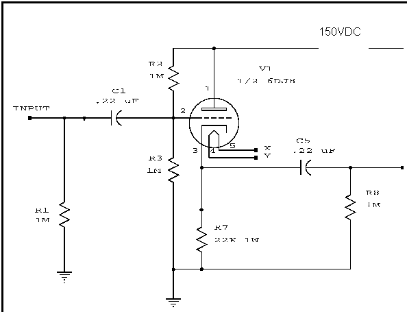

Well I finished my stereo buffer preamp using the 6DJ8,and the Compactron regulated power supply, it simply sounds beautiful, super S/N stats, but recently I decided to try a 6922EH,plugged it in powered up and noticed a buzz, with the 100k pot at maximum resistance. But if I turn up the volume it disappears. Is it simply the pot resistance, supply voltage not sure what's causing this. I will try later to post schematic, on iPhone right now. BTW it is Steve Bench's buffer curcuit.

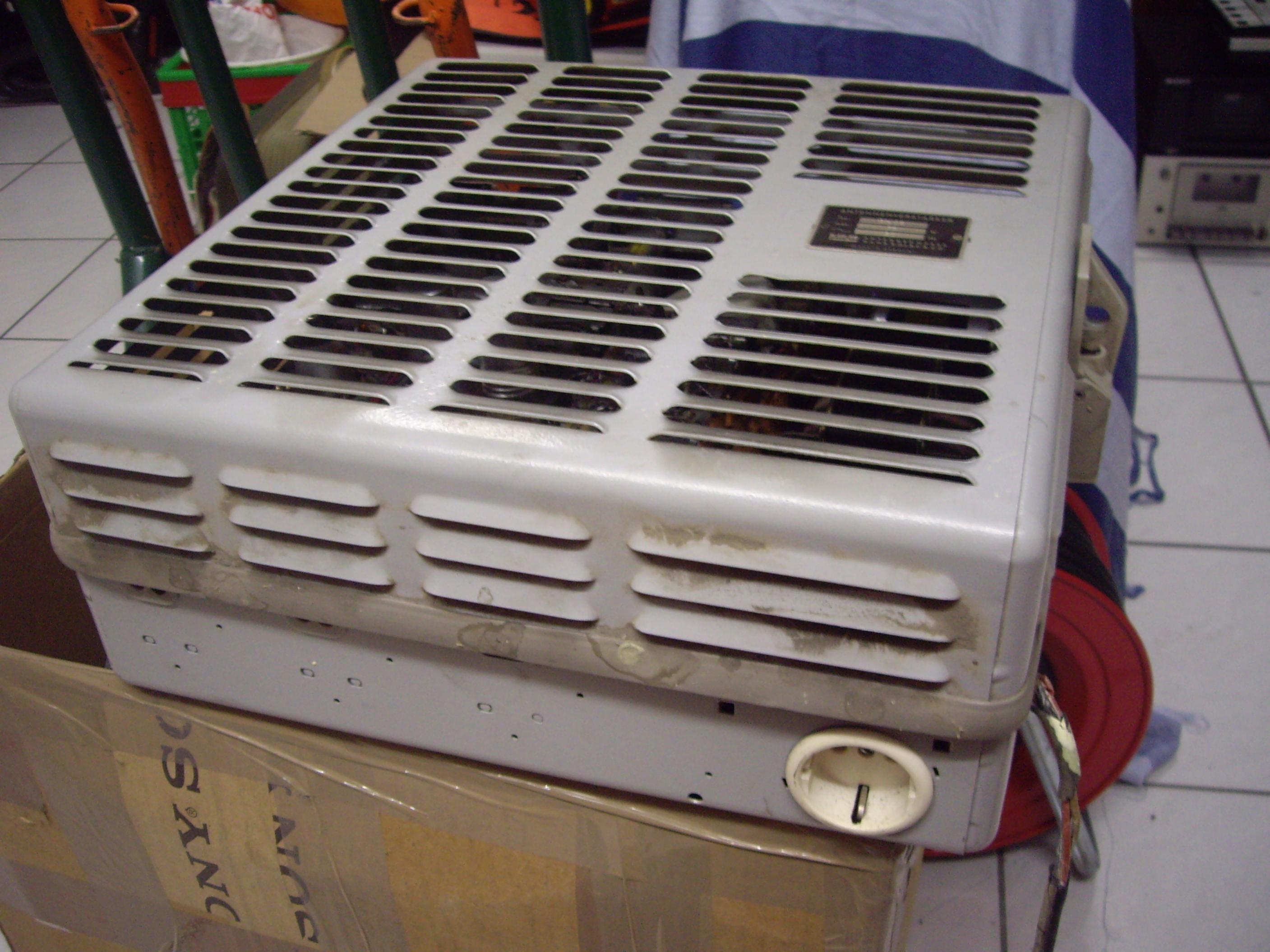

When you want to know the difference, look at the pics in the attachement. Thats an antenna amplifier for VHF and UHF for a multi-story building (source: Dampfradioforum • Thema anzeigen - Antennenverstärker Fuba um 1960). This was installed about 1960 and used E88CC. When it was removed in 2011 it still worked flawlessly. (The only problem being that this baby constantly cosumes about 75W !) A normal ECC88 maybe wouldn't have survived over 50 years. And that's is the difference.

With this tube family, a grid-stopper resistor is almost mandatory and a cathode stopper is often helpful, especially with the 100% feedback of a cathode follower. You also need local bypassing. Intermittent oscillations can manifest as all sorts of noises and odd effects.
I have ordered various other brands of 6DJ8's. The tube I'm using now is a NOS made in Japan,it's a nice sounding tube. The 6922 sounds just fine as long as I keep the volume control from the zero setting it's dead quiet!!,as soon as I turn the volume all the way down,I get that pesky buzz!!!
What you have there is a marginally stable (or perhaps not so marginal) circuit. The buzz with certain tubes is likely a gross symptom- what you need to do is address the root cause. Fortunately, the likely cure only involves 25 cents worth of parts.
Would a lower value pot at the input help?
