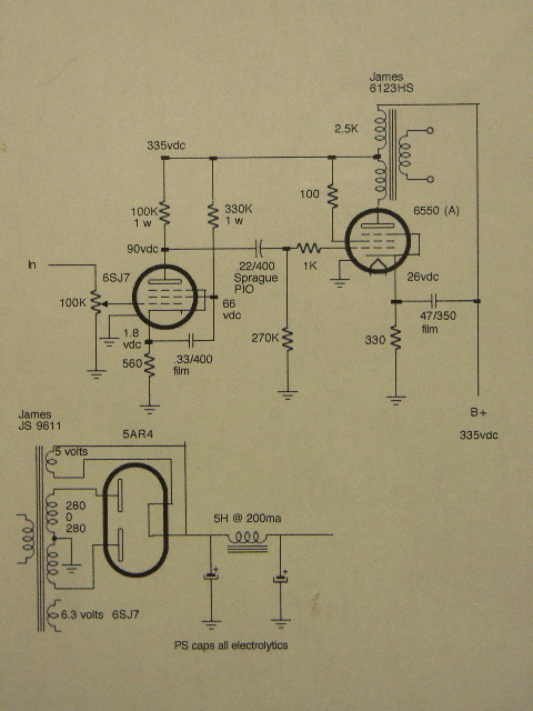

Hi,has anyone built or seen the `6550 single-ended amplifier`` from AudioXpress sept.01...I`ve built it in 2004, and I wonder.After leraning more about pre-amps and drivers I`m a bit un sure about R4 ,20k driving a 6sn7 at the plate with 280 volts seems to be a lot of current at 14 ma.I`ve modified it putting 100k on the plate along with mandatory changes on Rk.More gain but Ijust can`t put my ear on it but...something is missing.p.s.I use nos tungsol 6550 marconi and rca 6sn7`s.so the tubes aren`t the cause and neither the iron,Hammond... Thank`s

Can you show us the circuit diagram so that those with no access to it can understand your situation better?
OK, another embarrassing old guy moment. The 6550 SE has a 6SJ7 driver, not a 6SL7, as the schematic clearly shows. I had 6SJ7s on hand so I used them instead of D3As.
I used a 6SL7 as an LTP in a 7591 pp e-linear. Brain fog rolled in just before I posted and I mashed up the two designs.
The e-linear design relies on high Rp in the driver. At 44k and a mu of 70, the 6SL7 works well with an easily driven tube like the 7591 and I think it might drive a 6550, too, but don't know for sure.
I found that, for some reason, a 6SJ7GT sounds much better in this amp than the metal version. Another guy who built the amp found the same thing.

Basicly I`ll have to `word it``(This is the original design )-The power supply gives 390 v then goes through a 20k resistor to the plate,which is referenced to ground by a 470 k resistor...Rk is set at 6.8k! .Then it simply goes to the coupling cap(.22uF), and to a 1k resistor to the 6550,triode connected.The way it is,according to plan needs like 5-6 volts if not more to acheive full output power(10-11 watts@5% distortion)This a guess.I`m still experimenting with different skeems of operation.I tried a 6sl7wgt and I find it saturates easy.Maybe a two stage 6sn7 ,current source or cathode follower ect. I think I have my work cut out for me...Two stages, Hum...
