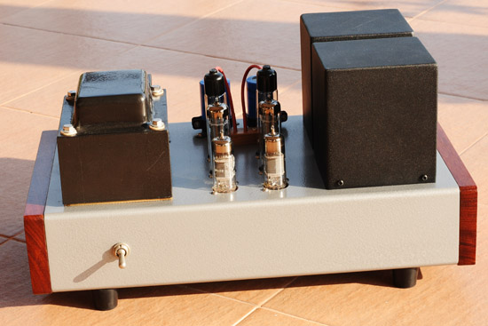

Hi, I build 6528 SE last two year for my friend. It was a good sound amp.
I used 5842 as a driver and 3B22 as a rectifier tube.
Yoss, that is a very nice amp!
What operating points and opt did you use?

I used B+ 250-260V, bias by 240 ohm cathode resistor. Cathode current is 90-95 ma ane grid voltage is 22-25V aproximately. The OPT primary impedance is 1-8-2.0K, this amp use 1.8K but another I've design is 2.0K.
Do you think using high impedence OPT (1.8K rather that typical 1K) will help damping factor? Can this 6528 SE amp drive reference speaker like B&W Matrix 810?

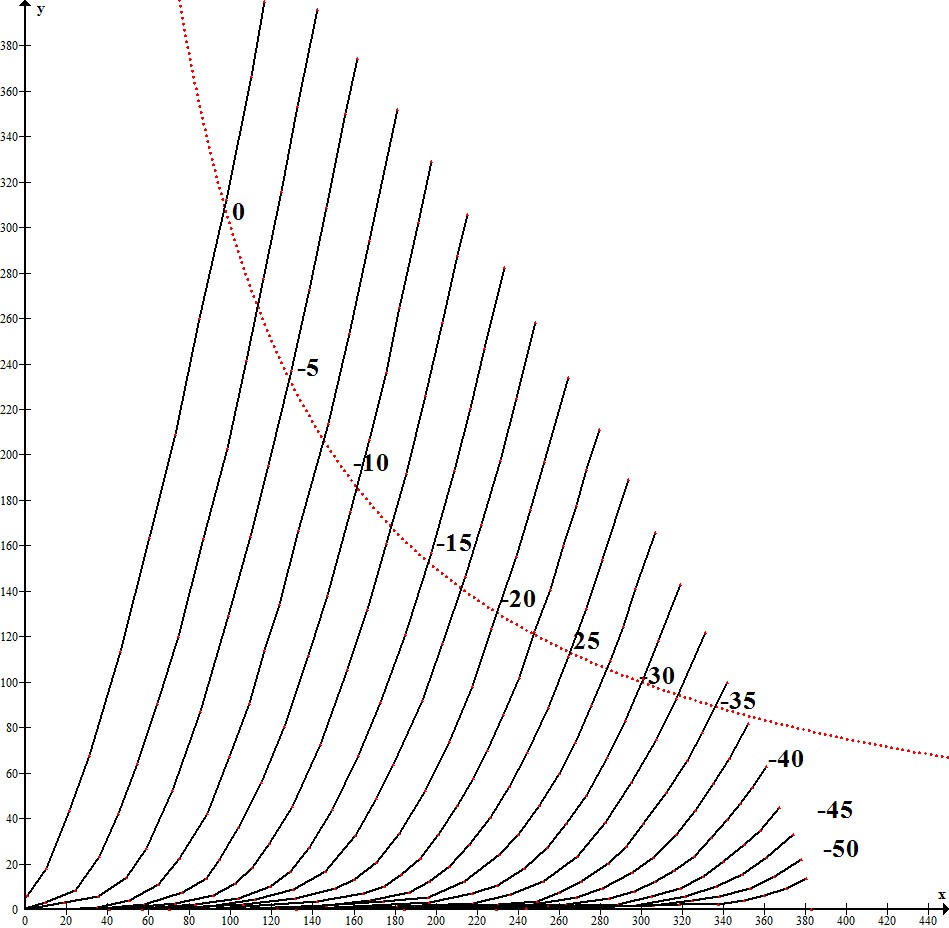

Why on earth build an amp on this highly unlinear regulatortube? With 220V/100mA/1,8k the swing to clip will be -155V/+115V(7,5% H2). Should be something like five highly distorted watts. But with the right driver and distortion-cancellation dialled in, it might work anyway.
Yes, Higher impedance, better damping factor. I also use OPT 2.5K OPT for my ED8000 SE. I just change from 1.5K, the result is lower power but better speaker control. Please note that ED8000 has plate resistant only 250ohm but I use 2.5K OPT.
My friend use this 6528 amp with Monitor Audio BR5, it work very well. For B&W I never try but I think it will not big difference from another SET amp like 2A3 or 300B.

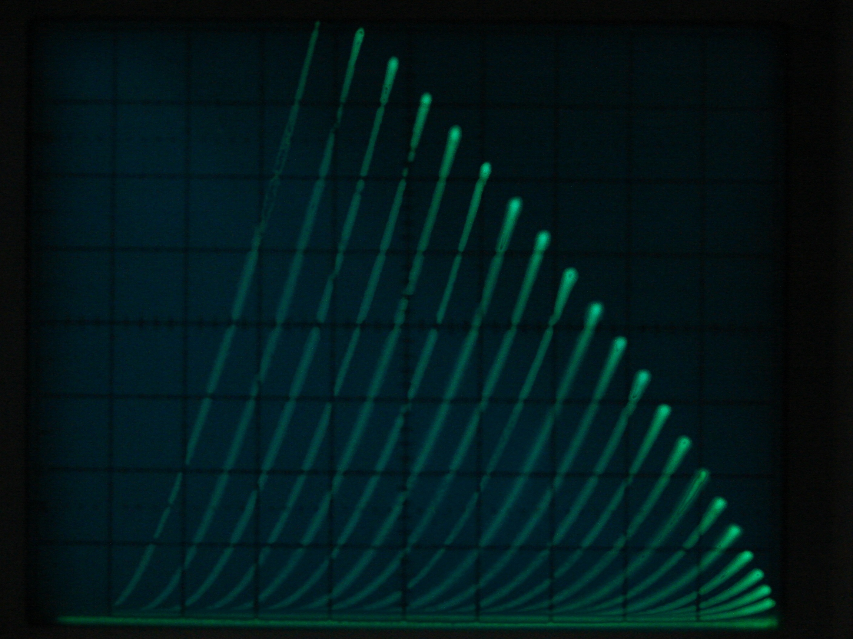

This is what I am after, finding out what the right driver is. I think there may not be enough experimentation with these tubes and therefore very little information about the optimal tube choices.
Is there such thing as a quick reference list with distortion scales for different driver tubes (triode)?
Alfredo
Those curves look sweet.
From my personal experience - these types of tubes work best at high current low plate voltage, and run as class A PP (single valve per channel). This will give you about the same watts- but they are likely to be cleaner when driven beyond a watt or so. In this configuration they can beat 300B SE amps hands down. Good gain of 9, but self splitter is not the best way to go as the sides tend to be highly variable.
