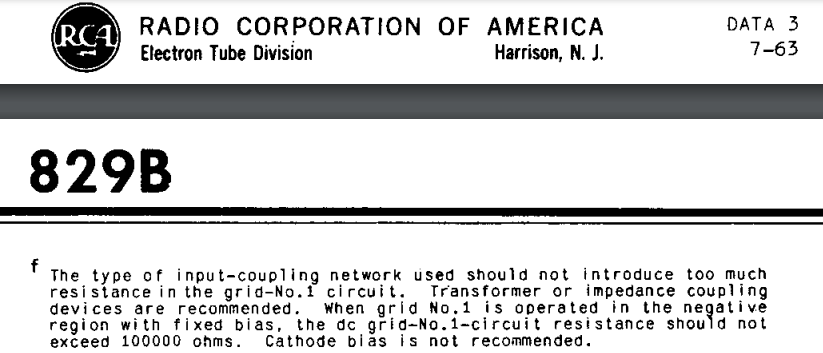

I never came across a datasheet where it said "not recommended for automatic bias"
https://tubedata.altanatubes.com.br/sheets/049/8/829B.pdf

Tnx, the affix "f" corresponds to a class B application.
It looks to me now, that for some reason, those datasheet writers felt a need to extra point out that cathodebias is "not recommended" when
operating in B.
Thats propably all that is to it, because inn the same datasheet one can find other types of applications with various cathode resistor values.
