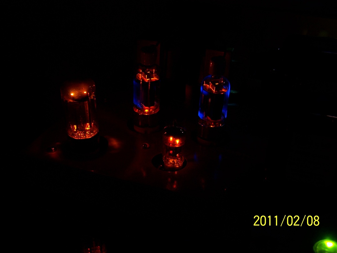

Snowed in and playing around last night with my digital camera.
Pictured are 2E26's. The one on the left is marked as Westinghouse. The one on the right is an RCA. The Shuguang 6146B are starting to show some color at about 750 hours or so, but it may be too faint to photograph.
These pictures are at ISO 80, max aperture, and 8 seconds exposure - the longest my digi cam will do.

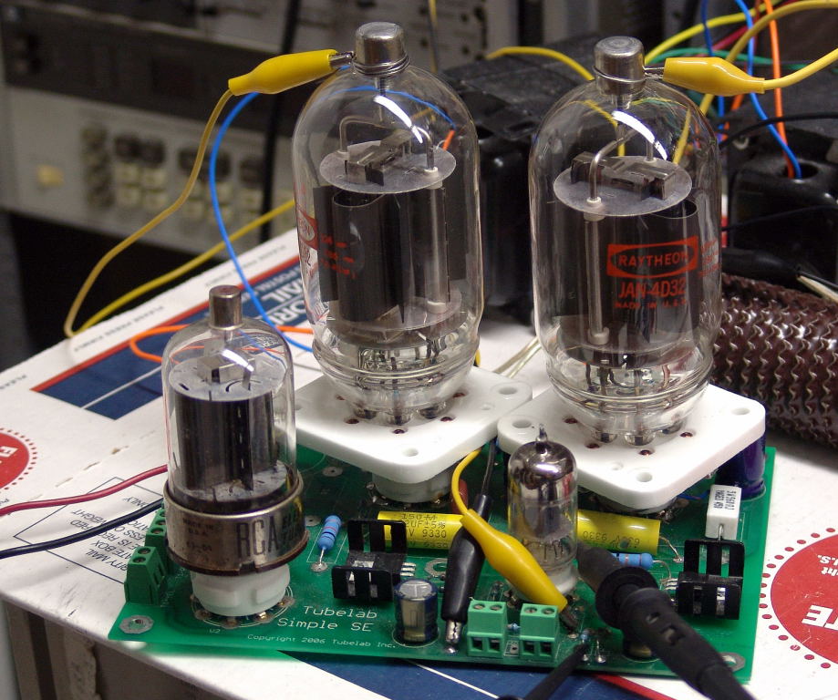

All this talk about stuffing transmitting tubes into the SSE made me think about trying it. But, why would I stick in a tube that is smaller than the KT88's that I have been using? Well, I have 813's, 828's, 845's and 211's, but they won't work in the SSE. People keep telling me to try a certain tube that is used in Collins transmitters, but I don't have any.
Ebay must have grown tired of me dropping minimum bids on lots of stuff, but never buying anything, so they sent me a 10% off coupon. Still, I didn't win any bids, so on the coupon expiration day I sprung for some 4D32's. OK, now I have got something that could kick the KT120's butt!
Do they work in the SSE? Lower the grid resistor to 100K, put in 100 volt cathode caps, and 10 watt resistors, wire in some BIG sockets and crank them up. Yes the screen grid rating is 350 volts, yes thay work fine in triode at 500 volts. I get 10 watts. When I have time, I will get the big Edcors and try UL mode.
I have been using an external power supply for testing. A big Antek with SS rectifiers would be the cheap ticket here. B+ caps will need to be rated for more than 500 volts.
I took a picture with a 6146 stuck in the rectifier socket for size comparison.....Don't try this under power!

But, why would I stick in a tube that is smaller than the KT88's that I have been using? ...so on the coupon expiration day I sprung for some 4D32.
Since I'm guessing most of us aren't familiar with the 4D32, I thought maybe I'd share a link: 4D32
In Class C a single valve can produce up to 100W at up to 60MHz with 600V anode and 1.25W grid drive. In AB2 a push-pull pair can deliver 125W.
Keep in mind the heaters of these tubes draw nearly FOUR AMPS each. Not exactly a "plug & play" replacement for KT88 in your Simple Single Ended. Even still, a very nice science project. Now I want one too. :mischiev:
They make my Fluke power supply groan when I plug the board into the power supply. An Antek 4T400 should be adequate.
