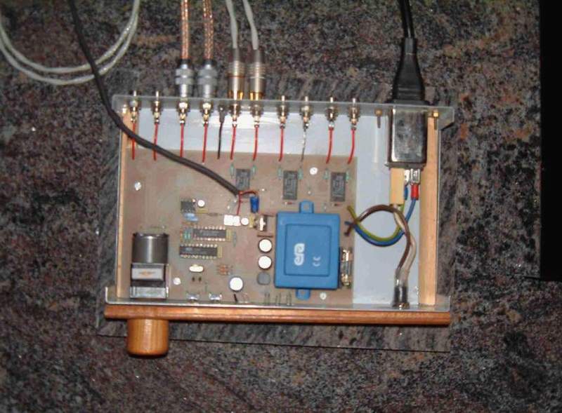

Hi everybody.
I made a single two chanel passive preamp. Sorry for the quality of the photo.
I used a µcontrolleur atmel and the result is very good.

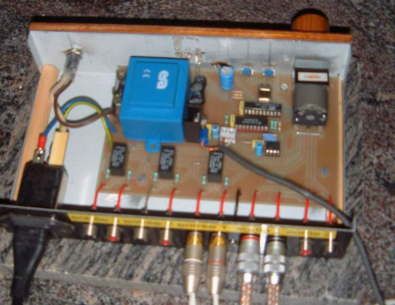

Hello,
Sorry for my bad explication, my passive preamp is controled by the µC, the potentiometre used is an ALPS with motor, the source selector is made with 3 relays and the µC decode IR information and command the volume and selection.
Soon I'm going to try to work on a 6 ways preamp based on Burr-Brown PGA 2310.
If you want precise informations about my two ways pre, don't hesitate.
Bye.
