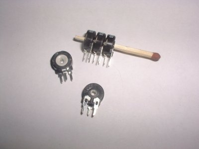

I forgot to mention the outcome of my original post (the one that started this thread)...
Well, I ended up using some 10K trimmer-type pots from Farnell, for a grand cost of £0.17 each, that have a hole instead of a shaft (no jokes, please) so it's easy to gang a whole load of them together. The quality isn't great - the tolerance is 20% - but they're only for a computer sound system so absolute sound quality isn't necessary.
Here's a pic. Don't worry, the match stick is only for demonstration purposes! The machine shop guys at my company will make a shaft from aluminium when they have some spare time.
Thanks to everyone who replied.

You can gang together a bunch of pots, but they won't track well, and not for long. A sound card usually has digital volume control built into the software that comes with it- is there a problem with that?
About the only way you're going to get a bunch of pots that track reliably over a long period of use is to go digital.
