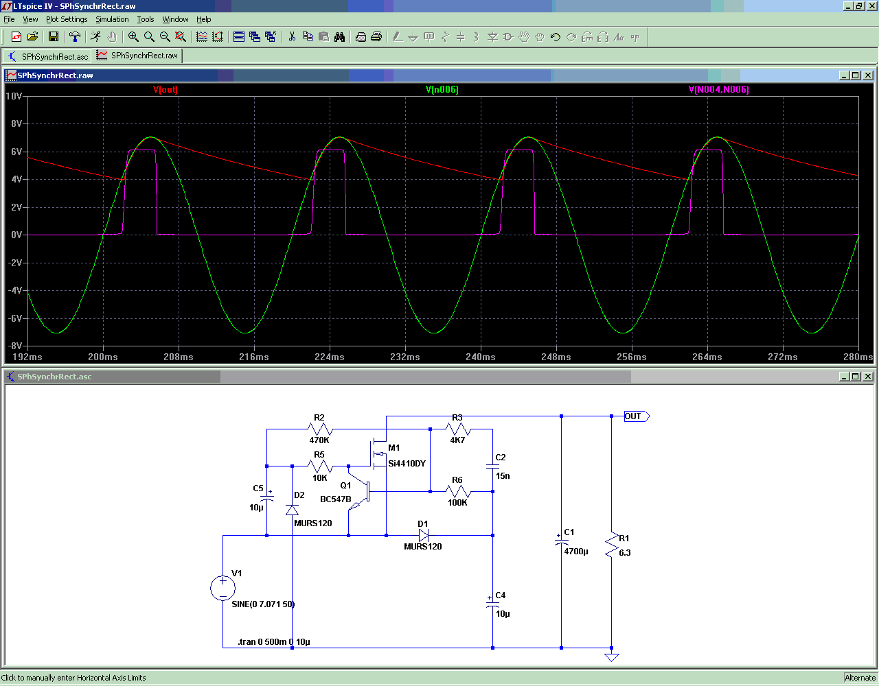

In this case, a diode bridge may not be an option, depending on the winding configuration/utilization.
Here is the half wave version of the synchronous rectifier: (C2 should be 12n for 60Hz)
I do it with Schottky rectifiers, lots of smoothing, and a very low dropout regulator. I've been able to keep in regulation with the mains 10% below expected as well.
You just need to check the specs of the diodes and the regulator carefully and find the lowest possible Vf and dropout voltage for the load current you are expecting.
Not this exact version, but I'll give it a try tomorrow, it's something you can breadboard in 5 minutes....
Tested!
Works exactly as expected, which comes as no surprise given the reliability of LTspice.
For practical use, I would recommend some standard protection measures: a B-E diode for the transistor, a G-S zener for the MOS, plus a gate stopper if there is a substantial length of track.
I might find a use for that circuit in + and - versions if there were a circuit board available. Currently using half-wave rectification from a wall wart to get +/-18V in a LF equalizer unit and I can't seem to get that last little bit of ripple out, even with a CRC stage followed by a Belleson super regulator. Not a whole lot of room in the box.
This circuit does nothing by itself to reduce the ripple, it only eliminates the diode drop.
If the ripple problem is caused by an insufficient headroom for the regulator, it could be helpful, it will improve matters by ~250mV compared to a schottky.
