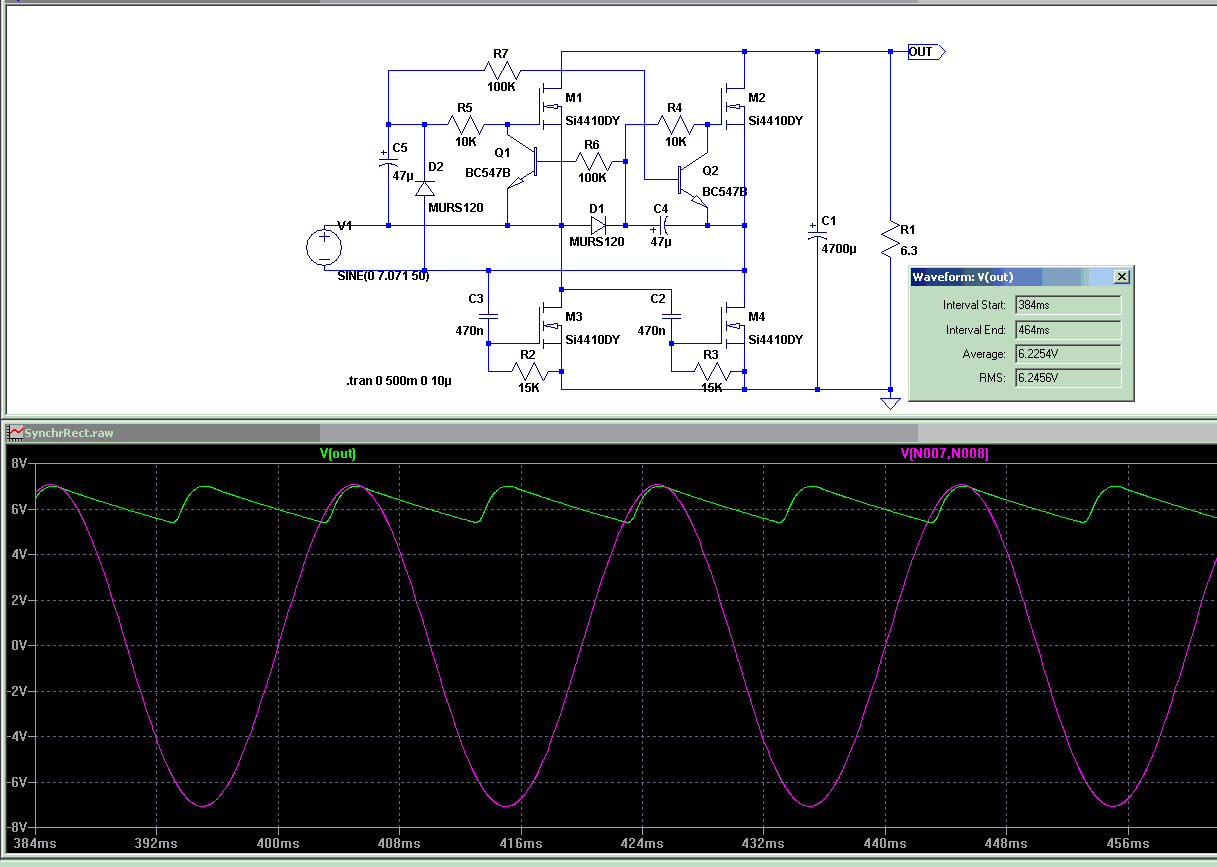

Hi All,
This is my first post to a forum so please bear with me.I found this idea in the book Tonnes of Tone by Kevin O'Conner and thought I would try running my 3 preamp tube filaments on 6vdc to see if it made a difference in the hum of the amp.The article stated it could run up to 5 preamp tubes on a 5vac 2amp winding.I am putting it into a tweed chassis and with it being a little tight I changed the bridge rectifier from a KBP602 to a BR104.I also changed the transistor from a 2n3005 to a TIP3005G.the circuit runs at 6.28 vdc with no load but drops to 4.2vdc when I connect a .45amp load.Any ideas on the problem would be greatly appreciated.Please see the attachment for the schematic.Thanks,Tom

Theory says that you should get sqrt(2)*VAC on the reservoir cap. However, this assumes that the rectifier conducts infinite current for only an instant. In reality, you end up with 1.2~1.3*VAC. So on your reservoir cap, C4, you should see about 5*1.25 = 6.25 V.
At no load, you'll get very close to that voltage on the output. However, as the load current increases, the transformer output voltage will start to droop slightly due to losses in the transformer. In addition, Q1 starts drawing base current. Now, I don't recall the hfe of a 2N3055 off the top of my head, but I bet it's lower than 50 - especially at low collector currents. The increase in base current will cause the voltage across R6 to increase, so the base voltage on the 2N3055 drops. As the base voltage drops, the emitter voltage will drop as well. In addition, as output current is drawn, ripple voltage develops on the reservoir cap. As the regulator doesn't have any headroom (input voltage is the same as output voltage), this ripple will go straight through to the output which begs the question, why have a regulator there in the first place.
I'm sorry to say, but that design is fundamentally flawed if it's designed to operate off of a 5.0 V winding.
If you want the circuit to work with minimum changes, I suggest adding a 6.8 V zener diode in parallel with C5 (cathode of the diode to the positive terminal of C5). That'll give you a fairly stable 6.1~6.2 V output voltage. The drawback will be that the output voltage will depend on the temperature of the 2N3055, but as the transistor heats up, the output voltage will rise (about 2 mV per degree C) so you may get closer to 6.3 V out as the supply heats up. You still need to provide a higher input voltage, though. You might be able to get by running off of a 6.3 V winding, but I'd suggest using an 8~9 VAC transformer.
If you want to be more exact about it and get 6.3 V across temperature, I suggest looking at the LM317. It should be available at just about any electronic component shop near you. You'll need to provide a few external components (two resistors, one capacitor) and put it on a heat sink. You still need to provide a higher transformer voltage, though... The LM317 needs about 2.5 V across it to regulate properly.

I guess the idea was to use transistor as smoothing ripple (active cap), but considering low starting voltage proposed design is not a good one.
Even using 317 s bad solution because of sharp cutoff when voltage sags below adjusted value (in this case) maybe some low drop regulator like 1084 (less then 0.8V drop @1A)or something even better, mayybe...
I would use better active cell with PNP serial transistor (so you don't loose 0.7V Vbe at least), just pure huge cap with some inductor in series before to smooth high diode/winding peak current spikes, or little step up (boost) smps (i know i know :eek::eek: nooise, but actually it is not that bad)...
You may be making this too hard. 5vac through a bridge rectifier will give you 7v -
the voltage drop across the bridge which will probably be ~1v. So you probably
will end up with about 6vdc. Usualy we forgit about this voltage drop when dealing
with higher voltages but in this case it's an inportant factor.

6 Volts DC from a full wave bridge rectifier from a 5 V AC winding is not going to happen. You may not get 5V DC. Somehow I cannot remember that I cannot even get 6 V DC from a 6.3 volt AC transformer. Remember the typical diode drops over 1 volt and a full wave bridge rectifier drops voltage across two diodes or nearly a 3 volt drop (real world). You might get a voltage doubler to work but that is brute force and will require not only twice the number of capacitors, big ones because of the stacked current peaks with the big valley in between.
I use 8 Volt AC transformers for 6.3 Volt heaters, that leaves a little room for drop out on the regulator.
