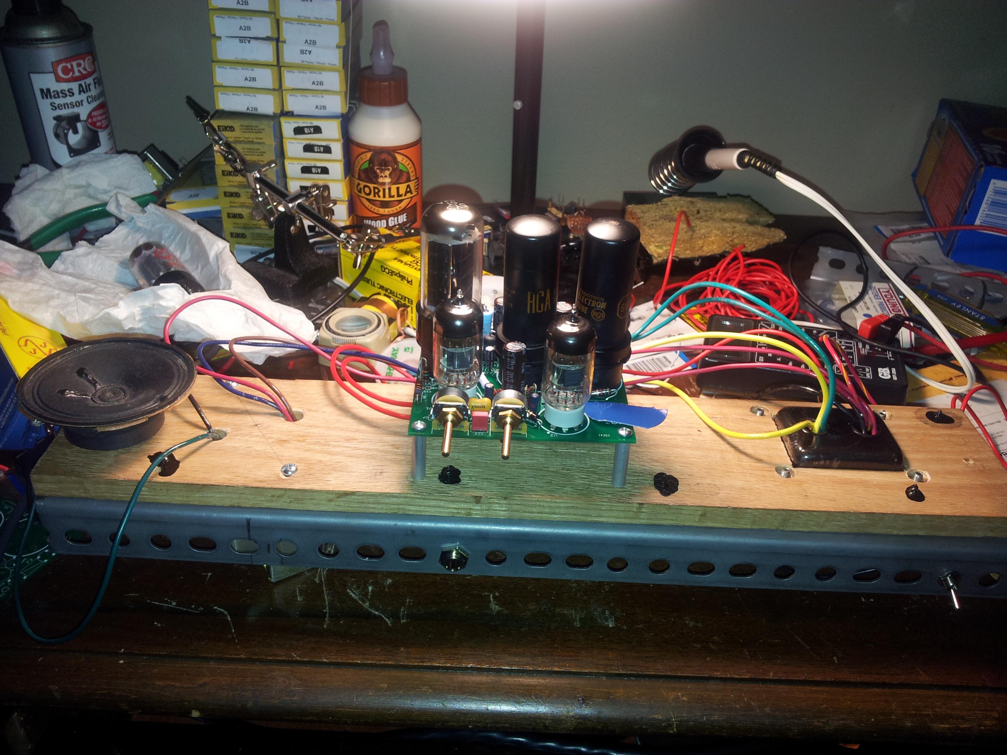

WOO HOO!!!! Got the rectifier to glow! I ended up shaving the polarizing keys off my tubes. Not sure if the board could have withstood all the mods. No worries, these tubes are now dedicated to r&d.

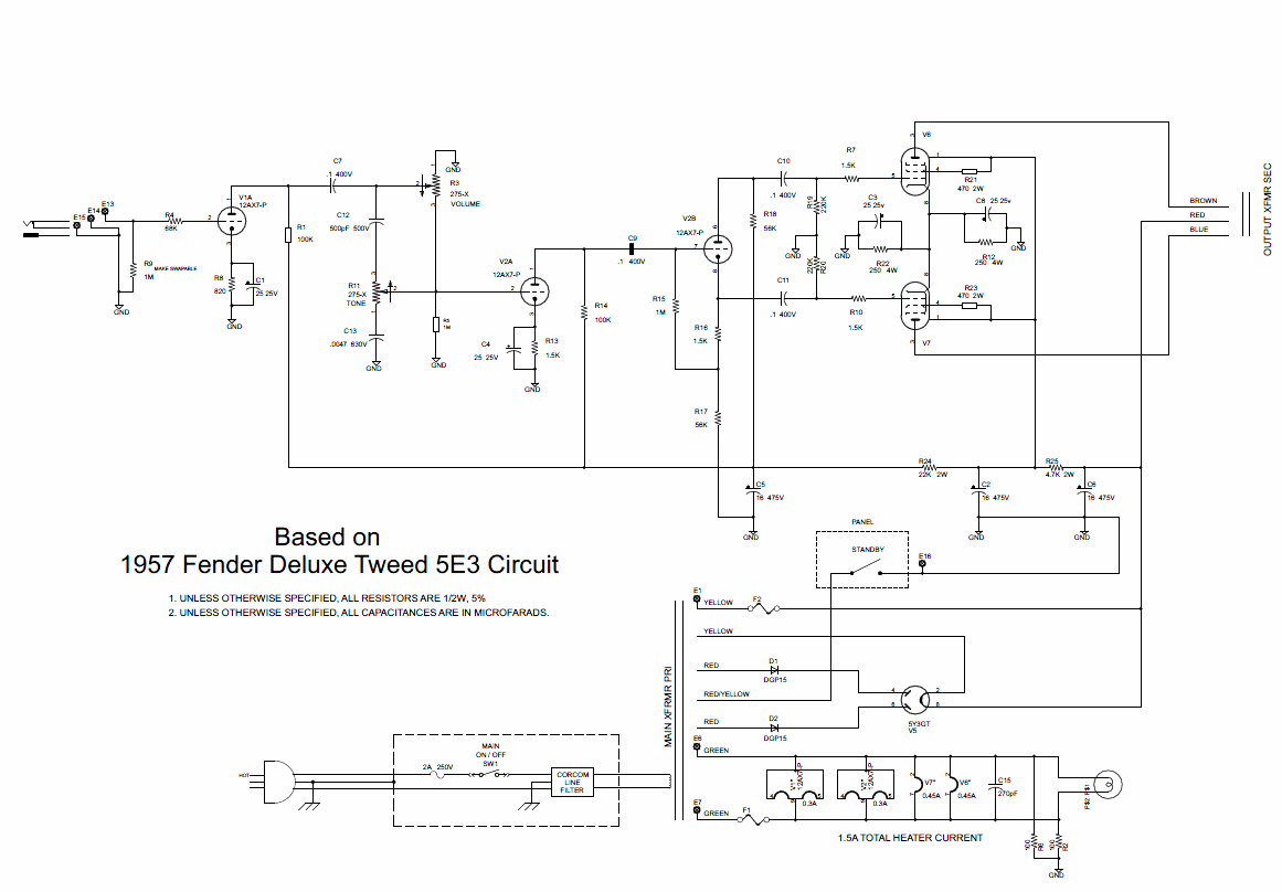

Output straight from the rectifier is 467VDC. Supply for the 6V6 tubes is 450VDC. Supply for the 12AX7s is 354VDC. These are too high,eh?

The plate voltages are high.
6V6 should see no more than 350 volts. 12AX7 should see no more than 330 volts.
Thank you Frank. So I think I fried my 6V6s, most likely earlier. No continuity on the heater pins. Now I have to do some calculating to get the R values right and obtain some tube fodder Thanks also for the pin orientation comment - that was my original mistake.
The RCA manual shows 350v for a 6V6. However, that is design specs RCA recommends. They are for polite designs like TVs and table radios. Leo Fender has been selling amps with 6V6 output stages running over 400 volts for over 50 years now, and they are not tube eaters.
Still 450v is too high.

My rectifier is putting out 476VDC. Consequently all the plate voltages are high.
I measured 3.95mA running thru the first resistor in the chain - the 4.7k 2w. I think that is low and indicates that no current is being drawn by the two dead 6v6. Their cathode bias R's have no voltage at the pin, indicating lack of current.
My question is: Once the 6v6 tubes are installed, will they cause the rectifier to sag, thus lowering the output voltage?

Absolutely. You should wait until you can install the replacement 6V6 tubes.
At that time, you can determine the actual B+ voltage under operating conditions.
If you find that it's still a bit too high, you can always add a power supply choke before the first filter capacitor.

But first I have to work on some resistor values. I screwed up on the 6V6 cathode values when I split up the original single res. My plate voltages plummeted from the skyhigh figures of before. Drawing 11.7mA through that first 4.7k res. I think that's close to "normal".

My own comments. If not for 2 minor mods at the outset, my board was good to go otherwise. I had to get creative mounting the pots. The replacements I got locally came without jam nuts - talk about unobtanium. So I c-clamped them on. So far I have not messed with any components but the pots. And that's about it. Frankenamp is born. I'm going to start trying to act like an EE and bias the tubes. Want to quiet the power as my scope shows it carries a little AC. Running cooler.

How do I make it so no voltage shows up on the strings!?!?!? Any comments appreciated.
Your schematic shows a three wire grounded line cord. You should have continunity from the round pin (USA) to the chassis. This is usually a green wire with a yellow stripe. Also continunity from the chassis to the ground side of the input jack and to the strings on the guitar. If you do and there is still voltage on the strings, the problem is with the outlet you are plugged into, not the amp. Get one of those little gadgets with three lights that checks the outlet at a hardware store like Home Depot.

Proper biasing. My sense says start at the input and work forward. But since the amp showed well in the dog n pony show, and since I know for a fact (actually after the fact) that I totally screwed up on r values when I split the 6v6 cathode r, I'm going after that first. Gonna install a single 8W 250 ohm wirewound for both tubes.

I did the resistor change mentioned in the previous post. Also attached one end of a resistor in the preamp I left dangling ooops!
