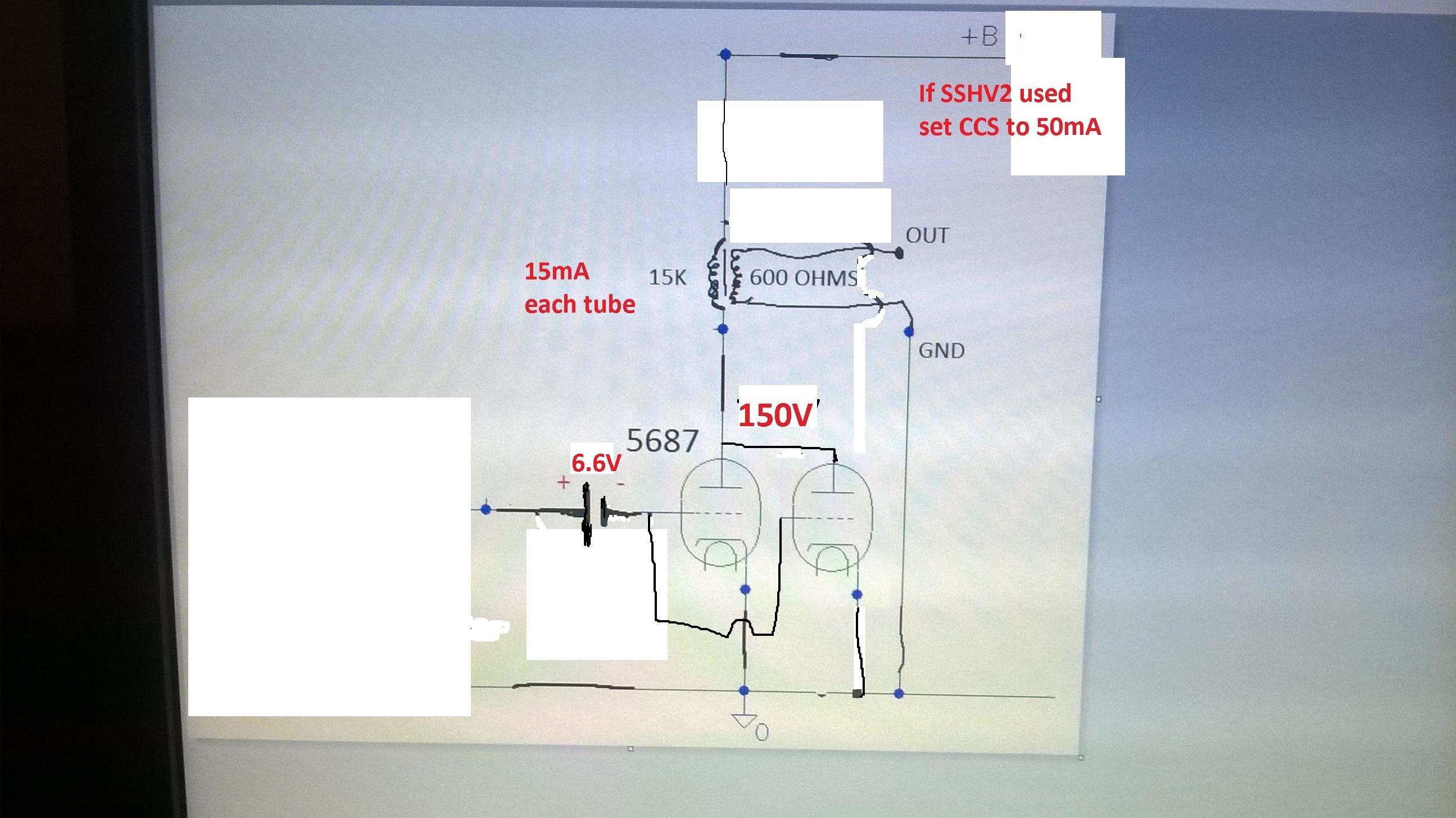

@rongon
As attached schematic?

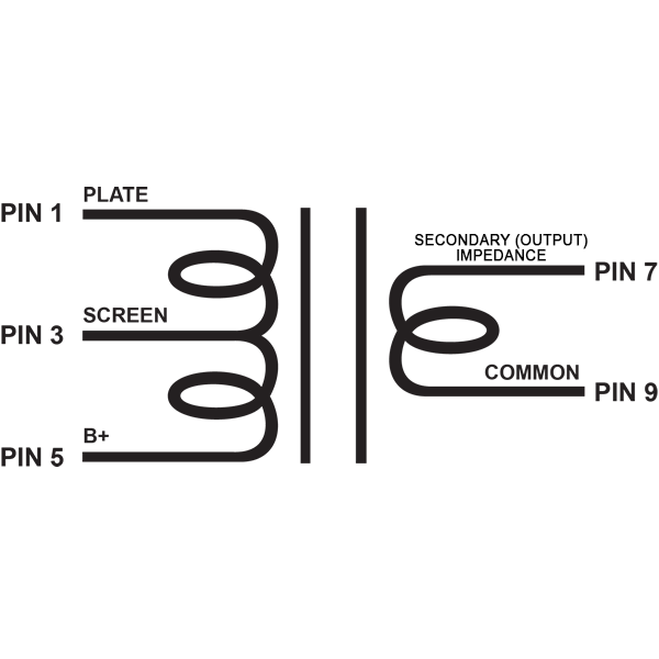

Hey Merlin, could you send me some measurements from your Edcor GXSE5-15K transformer?
Primary Inductance (in henries) - measure from Pin 1 to Pin 5
Primary DC resistance (in ohms) - measure from Pin 1 to Pin 5
Secondary inductance (in henries) - measure from Pin 7 to Pin 9
Secondary DC resistance (in ohms) - measure from Pin 7 to Pin 9
With that information, I can make a spice model, to make some very approximate simulations.
@rongon
Yes, that's basically it.
You'll want an input DC blocking capacitor, of course. You will also need a grid leak resistor. A grid stopper resistor will likely be needed too (the 5687 has high gm, especially two of them paralleled).

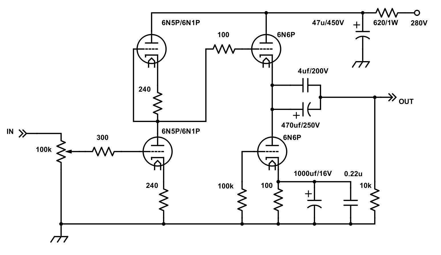

6AS7G (6N5P) as an input tube (totem-pole config) to drive a 5687 (6N6P) cathode follower with active load? Am i understanding that correctly?
On further reflection, I think I'm underestimating the insertion loss of the output transformer. How much gain will be lost across a little 5W SE transformer like that Edcor GXSE5-15K-600? 1dB 2dB? More?
12H
263 ohms
0.38H
24 ohms

Question:
Is the DC resistance of the secondary really 24 ohms? That seems awfully high. Can you double-check that?
Also, your biasing scheme isn't complete. I can fill in parts to make it work. Do you really have to have -6.6V bias on the 5687 grids?
You'll want an input DC blocking capacitor 0.47uF?, of course. You will also need a grid leak resistor100K?. A grid stopper resistor 1K?will likely be needed too (the 5687 has high gm, especially two of them paralleled).
All the above are sensible values.
The grid stopper could probably be as low in value as 100R. 470R would work. The value isn't critical, but it should be enough to inhibit a high gm tube's tendency to oscillate. Too high a value and you risk some treble roll-off from interaction with the triode's Miller capacitance.
I want to try two bias: -3.3V grid 100V plate 14-15mA and -6.6V grid 150V plate 14-15mA

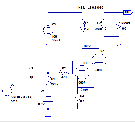

OK, quick 'n dirty simulation.
First, I'm not sure whether the OPT primary inductance is really 12H or 20H. I picked 12H, to be conservative.
Second, I changed the coupling coefficient to fit that. It's 0.99975 instead of 0.99985, because of the 12H primary L.
Bandwidth looks good. Too good on the high frequency end. I don't trust it.
As far as gain and power output, what I get is not encouraging. I think something's wrong with the OPT measurements, because there's a really large insertion loss. The total gain of the proposed amp is only 0.25X or -15dB (that's negative gain).
It takes 2.83V peak input to reach 710mV peak output, at 0.88% THD. The FFT display shows that the amp is nearly clipping at that level.
Changing Rload to 600 ohms doesn't help much at all. THD still 0.88% and gain is only very slightly higher.
I've attached the .asc file in case anybody wants to have a look.
