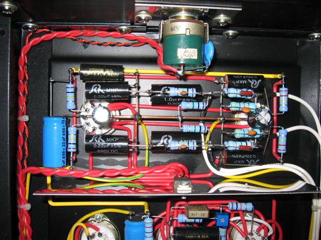

It was easier to re-wire this:

The board on the left is the psu, the board on the right is the phono stage. I built it into an old amp case that had gone to Jesus big time LOL.

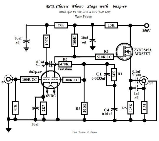

If you are starting from scratch, take a look at the tweaked version of the RCA preamp I had a hand in. The tweaks address the 2 biggest weaknesses of the RCA original: poor drive capability and mediocre bass extension. Yes, you could graft the MOSFET source follower onto AI's circuit too. If the tweaked RCA setup is of interest. Look here and follow the links. Some parts value changes are in order.

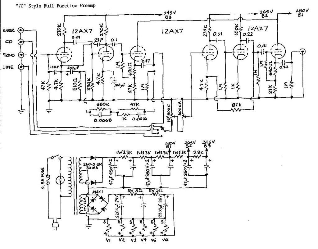

If you alrady have the PS, and the cabinet, and do not want to go point-to-point wiring you could aslo spend a few $ on a new PCB available on Ebay for an RIAA based on the Marantz 7.
That could be a fairly decent circuit - i think.

I'll be immodest. ;) One builder's remark was "incredible".
I claim no more than competence. Some MM carts. and SUTs fair poorly working into the large CMiller of a 'X7 section. OTOH, given a compatible "5" mV. signal, the tweaked RCA circuit will make you smile.

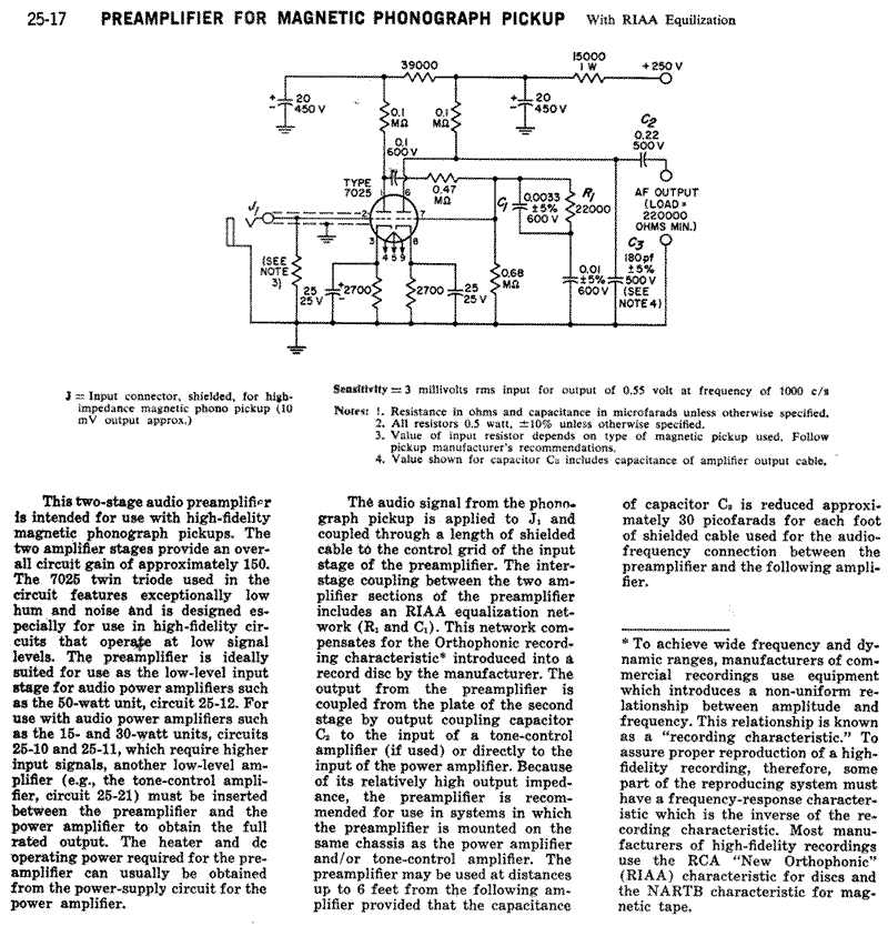

Never forget that all passive EQ phono preamps are descended from RCA's original. The 7025 is a 12AX7/ECC83 equipped with a spiral wound, hum bucking, heater. Of current production tubes, the Sovtek 12AX7LPS is the variant that meets the description.

I don't mean to throw a wrench in your plans since you have spent so much time thinking about them, but in my opinion the 1st thing you should do is turn this thread into a "how should I fix my Chinese 5670 phono stage thread?". Frankly, that 5670 circuit looks fine to me, other than the glaring weakness of lack of an output buffer. Try sticking a 5670 or 6DJ8/ECC88 cathode follower on the end and see what it sounds like. If still sounds bad, I would suspect PS issues. Sure, you can get caught up into chasing higher performance circuits with CCS's and passive EQ and so on, but IMHO you are already 50% there with that phono stage.

IMO, implementing a DC coupled ZVN0545A source follower will prove LESS problematic than adding an additional tube. For starters, both heater power and space are non-issues. ;)
