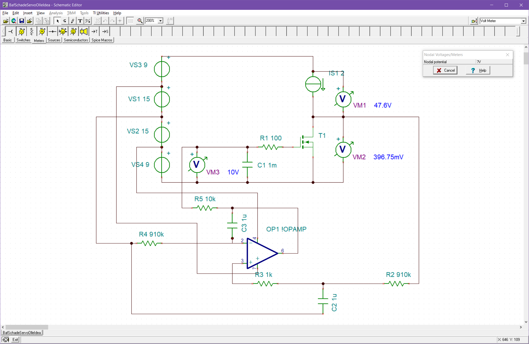

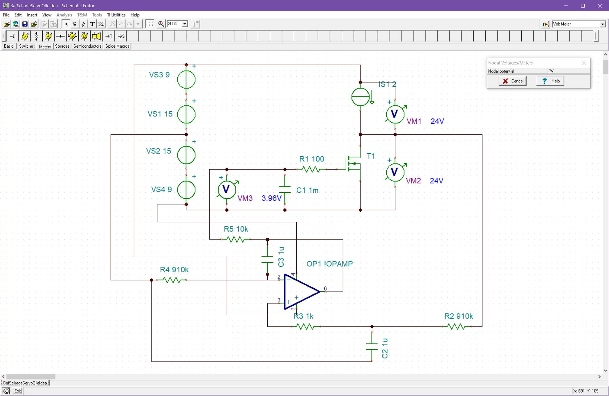

I've been thinking some more about #1198 schematic the more I think the less I understand:
The opamp rails are +-15V and share ground with the amp. Doesn't that mean that regardless of whatever input I use, the output can only swing across +-15V? And since that voltage is the bias, that means that the mimimum bias is -15V relative to Gnd. Or +9V relative to the -24V rail.
Won't that make the minimum possible bias voltage way too high? (The FETs I'm playing with (R100, IRFP150, hockey puck) requires bias in the 1.5V - 6V range for 2A)

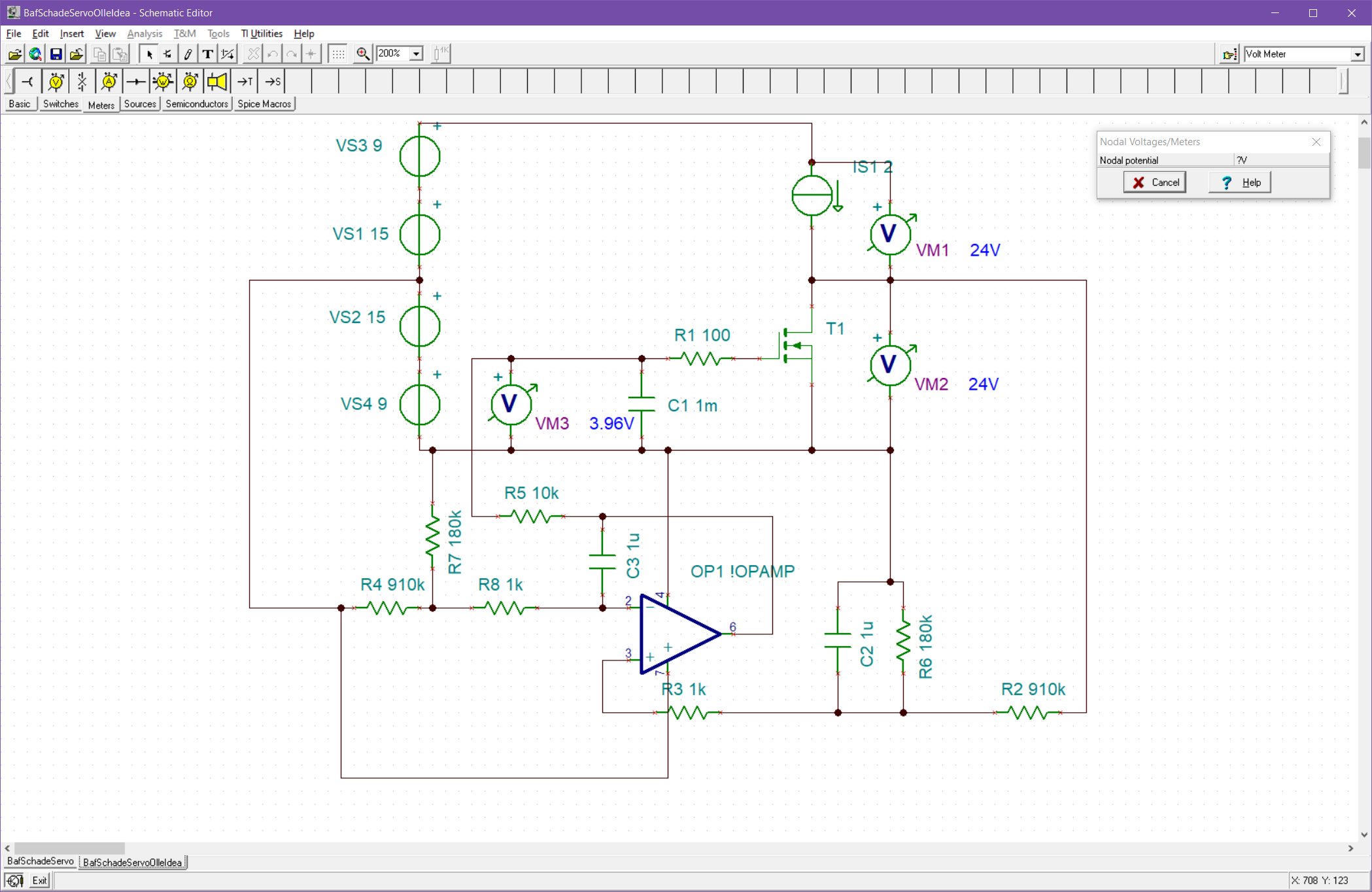

That what I thought to solve with the #1196 schematic:
  • Power opamp with -24V to Gnd such that it can swing across this range.
  • Use resistors to drop the voltage of Gnd from +24V relative to the -24V rail down to +4V (1/6)
  • Apply identical resistors to the input signal such that instead of being a signal of 0-48V relative to -24V it is 0-8V.
I tried to simulate all 3 schematics:
#1198 with opamp, full +-24V rails. Seems to work great.
#1198 with opamp, +-15V rails, not so great. At least in my simulation it breaks down in the way I guessed, the bias can not get lower than ~ 9V which is too high for the FET.
#1196 my idea to pull down the reference voltages towards -24V and use -24V to GND for the opamp. Seems to also work just fine too.

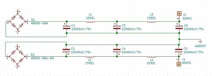

You have the left and right channel grounds of the power supplies connected. To maximize the benefits of dual mono, do not connect the ground of the two channels together. For each channel's power supply ground, provide a separate ground lift thermistor to the chassis safety ground.
The only common connection of power supplies would be the AC to the transformer primaries.

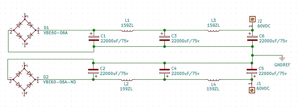

That’s an interesting suggestion. I posted the PS schematic to solicit other suggested improvements. I vaguely remember the Aleph class A supplies being bypassed by an electrolytic? Also, I’m pondering some sort of bleed off resistor?

Yes, a bleeder at the first cap is good. 4K is a good value. I=60V/4000R=0.015A, P=0.015A x 0.015A x 4000R = 0.9W. I would suggest 3W to keep temperature down.
Snubber at the transformer secondary/rectifiers is a great idea. Time for a new oscilloscope.
I believe that a film decoupling capacitor is best located as the last capacitor in the power supply, the one that is closest to the amplifier circuit.
I think 600VA may be enough for the transformer for one channel. 60V x 3.2A = 192VA. I typically mulitply that by 3, so that would give 576VA. However, more will not hurt, except perhaps in the wallet.:)

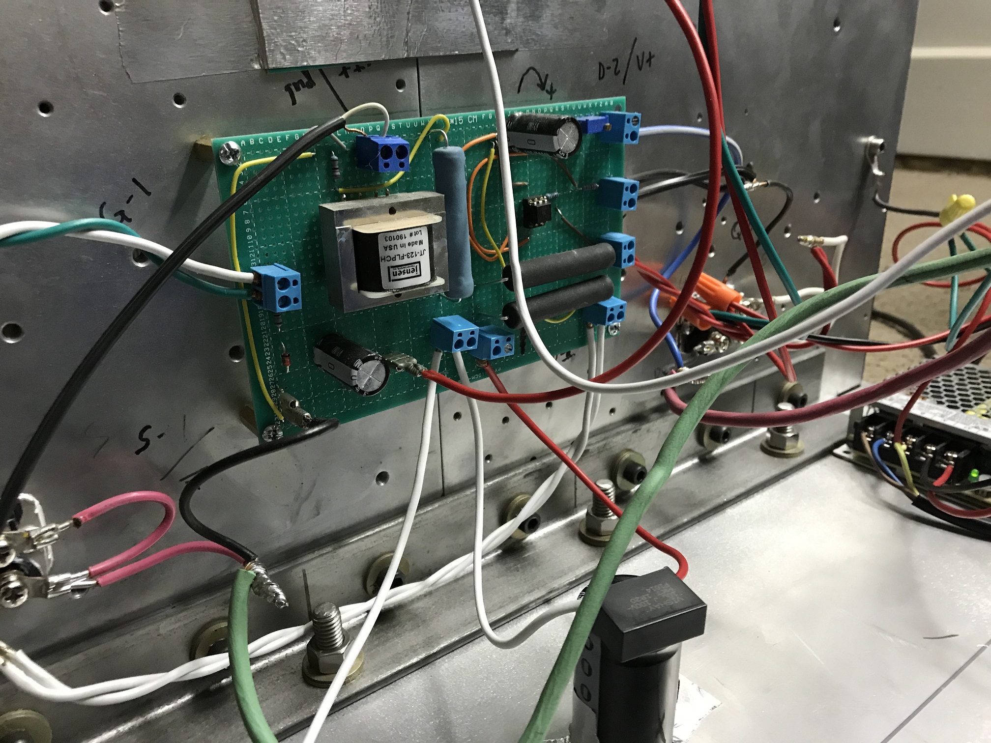

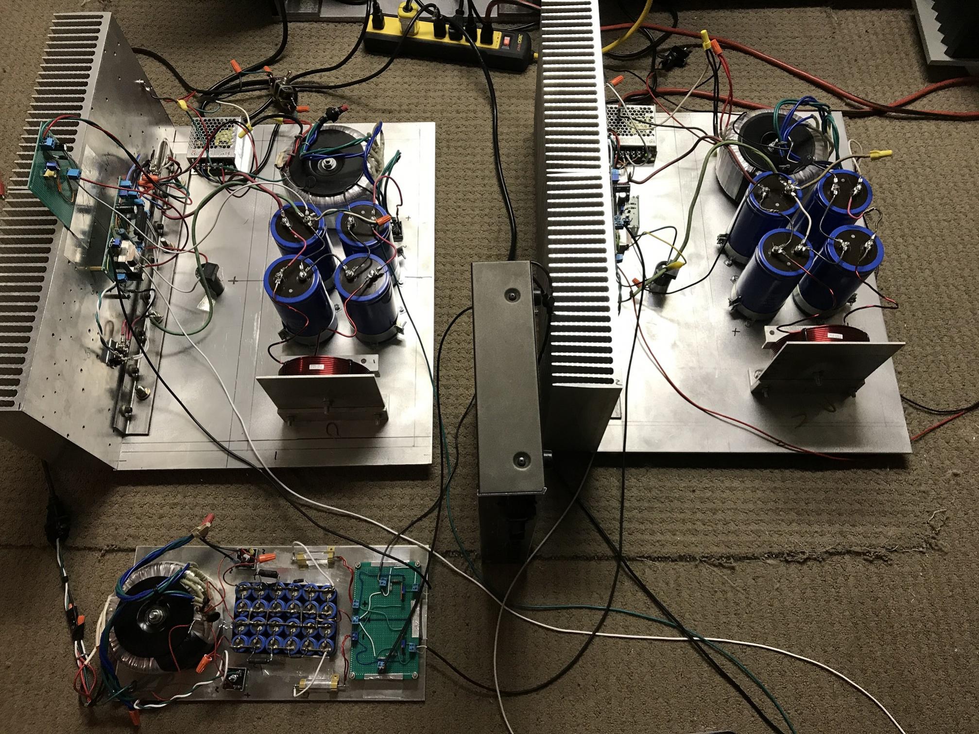

The Singing Bush placeholder a.k.a BAF2015 amp. Completely overbuilt B1 R2 with a 500VA toroid scrapped together with parts laying around....sounds fantastic.

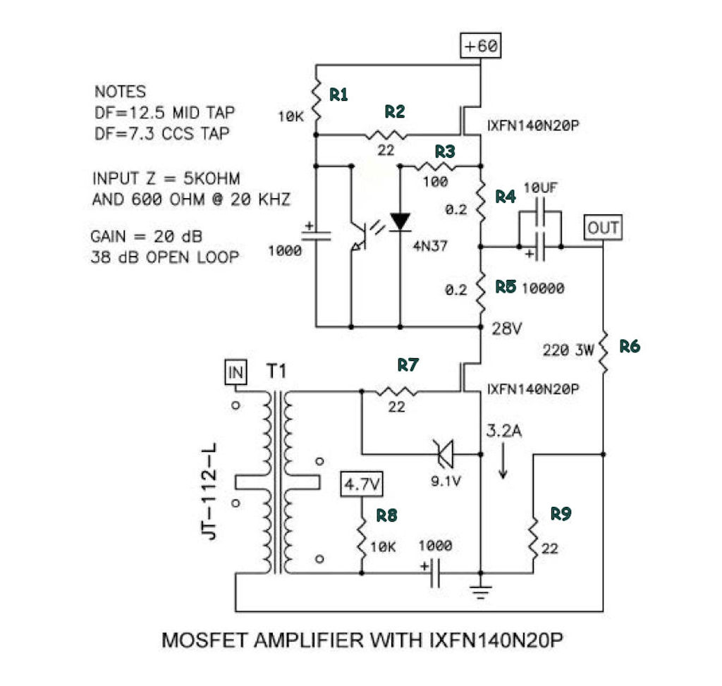

question...I've read the Tokin 2SK182ES needs to have it's bias supply on prior to applying power to the rails. As I'm using IXFN here, does this have that same requirement? I'd like to eventually use just one power switch when I finish the chassis instead of powering up things separately as I'm doing now.
