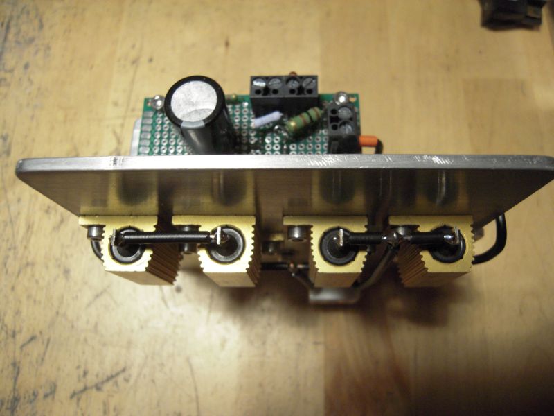

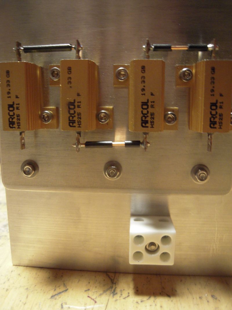

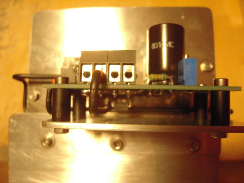

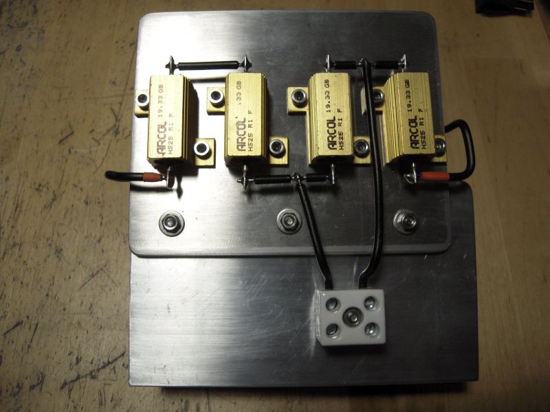

I made a nightshift - some little progress with my 'optocoupler-boards' (in
point -to-point).
The try continues.... :D
Greets
Dirk

to Soundhappy #968
Hello Soundhappy,
yes I will try the difference in the resistor cascade output (balance 2nd / 3rd
harmonic). I thought about a switch but decided for the screw method.
I am also thinking about a input buffer / driver stage. Nelson Pass recommended
an output impedance of a buffer / driver stage below 100 Ohms. :rolleyes: The resistance to ground - then into the transformer....
I see similarities to the M2X.... on the input side. I was thinking about using one of the buffer input boards of the M2X (but voltage difference +-24V / +60V, M2X is complementary and dual rail PSU - 50W-SE-Schade is single ended....) Only some thoughts.
Greets
Dirk :D

..I thought about a switch but decided for the screw method.
I am also thinking about a input buffer / driver stage. Nelson Pass recommended..
Hello Dirk
Your tight screw connection do the job as well :) :wrench:
One amplifier but with two distinct audio characters to chose
is an interesting DIY option = twice joy with differents audio sources , preamplifiers and speakers
for Your the very best system configuration.
Input buffer can be with 2SK170 or equivalents.
Greetings
..Still a lot of mechanical work. How to position components..
Yes keep distances , wires short if possible..try test psu voltage then CCS and bias circuit, audio path at the end.
Safe step by step method. BTW Nice big chassis :up::)

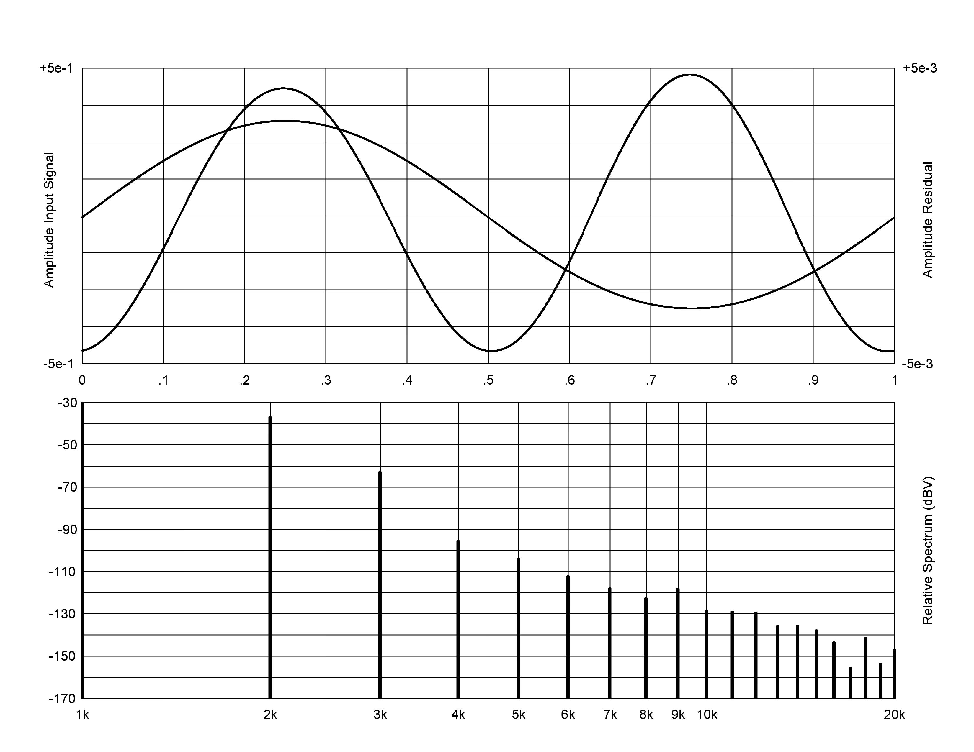

I have tried some of the connections and I'm not sure of the results. With my THF-51S version, I have found that the H2 varied quite a bit also with power output. More on that later.
One thing that I found was that I preferred the sound with the speaker cable connections inverted for negative phase H2. The amps output positive phase H2 and I found that in my system, at higher volume the sound projected forward too much. I sit about 10 or 11 feet from my speakers and at higher volume the sound was too much in my face. With reversed speaker connection and negative phase, the sound was more in the speaker plane and behind.
Here is a distortion plot that I did with my Focusrite 2i2 and DiAna software with a 1kHz signal showing the distortion at 1W into 8 ohms at the middle position (C).

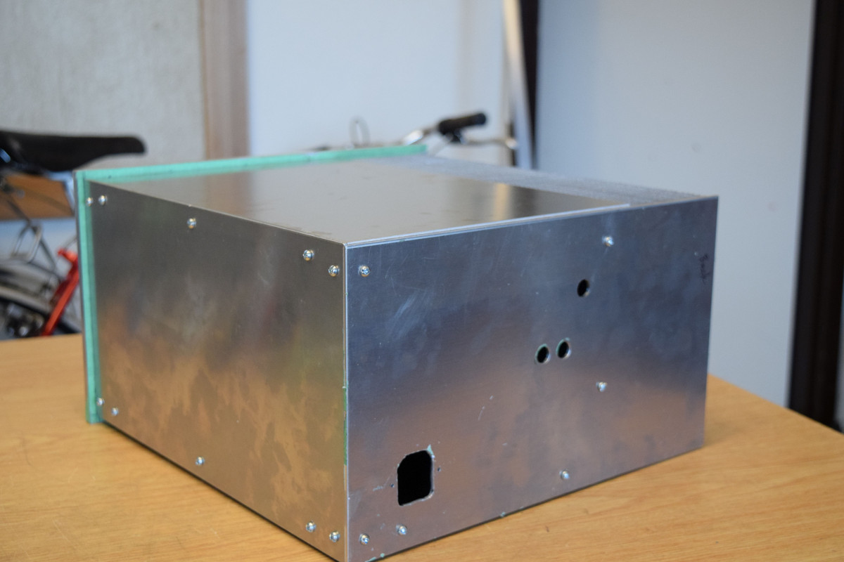

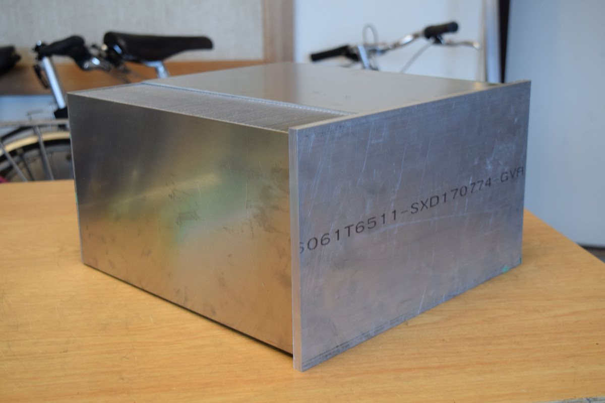

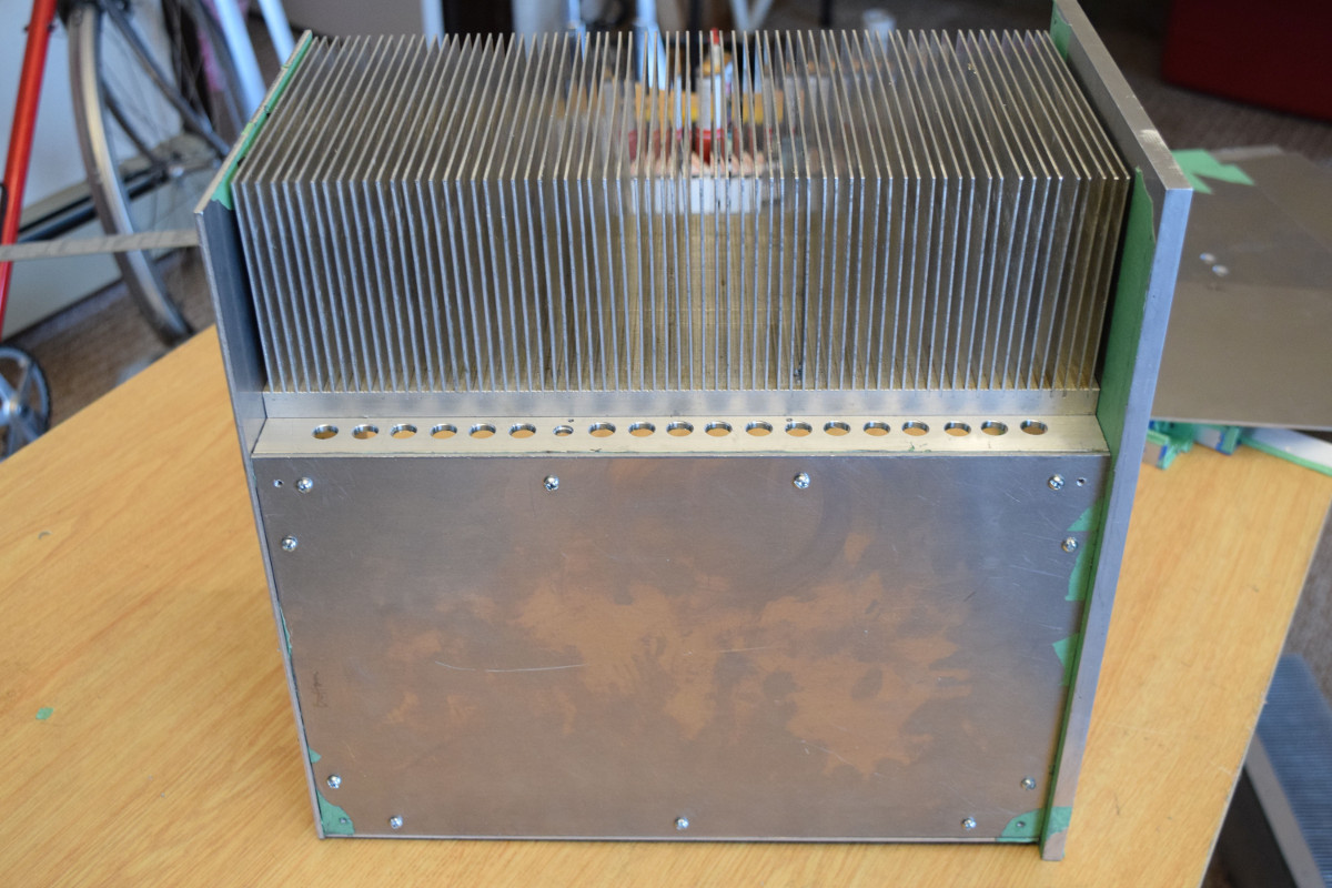

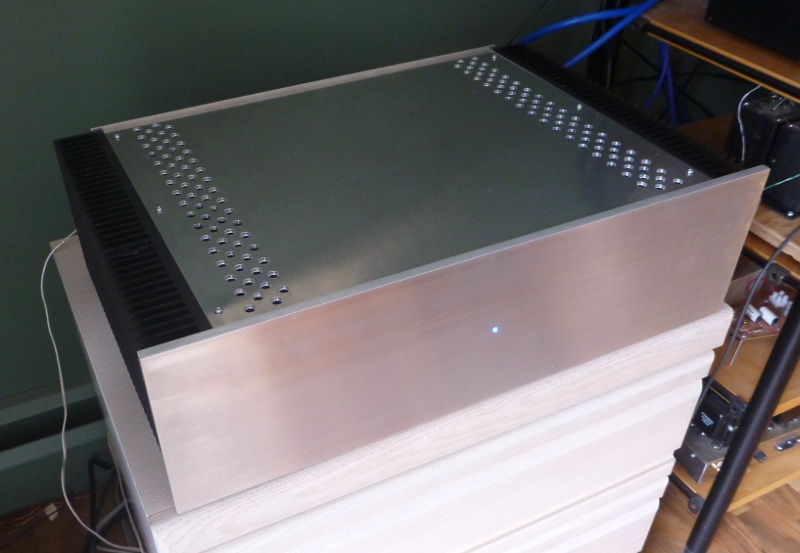

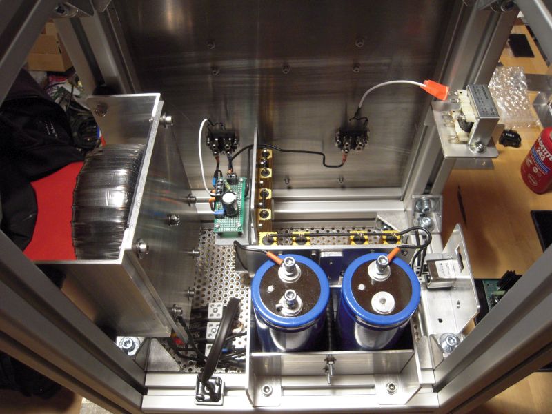

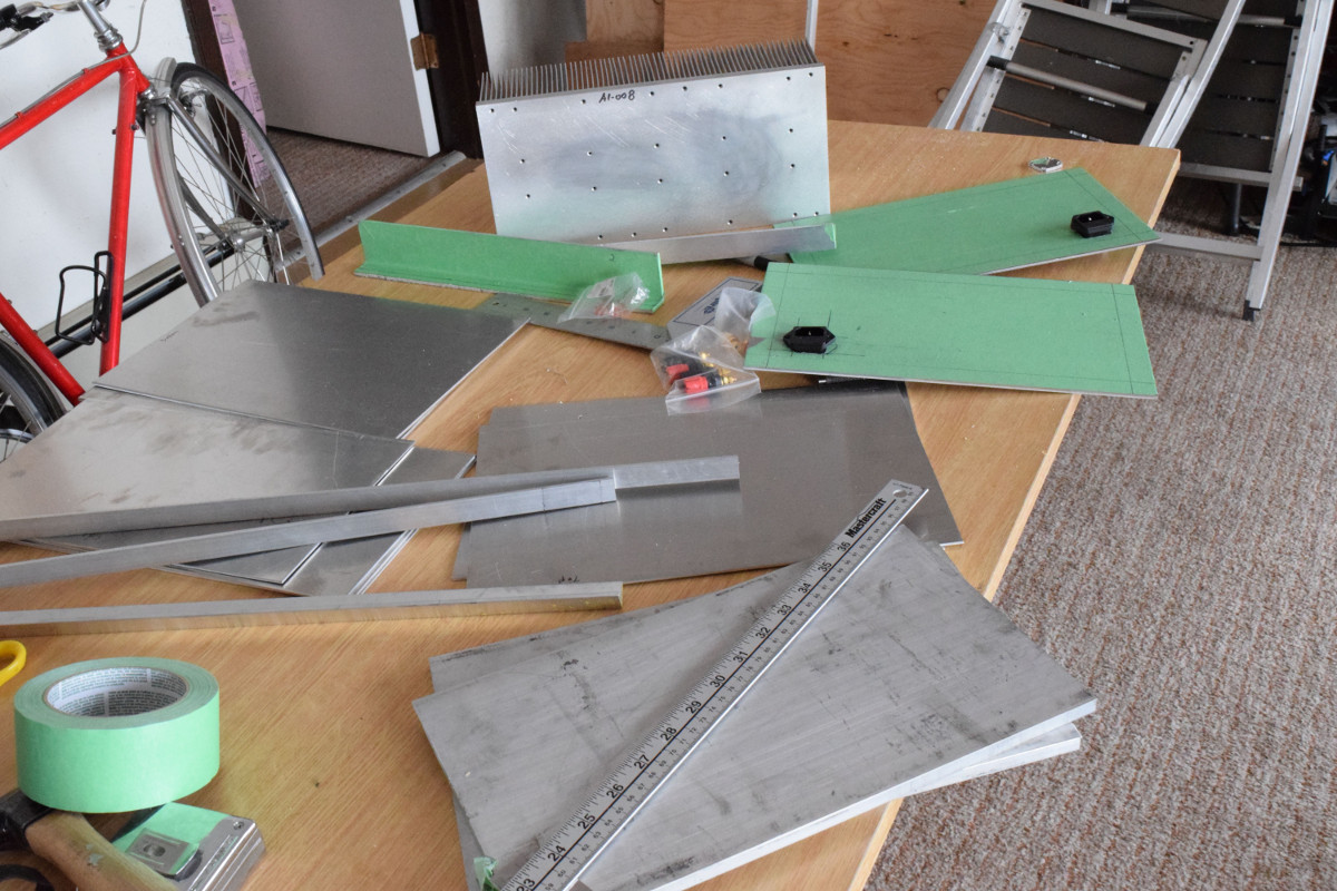

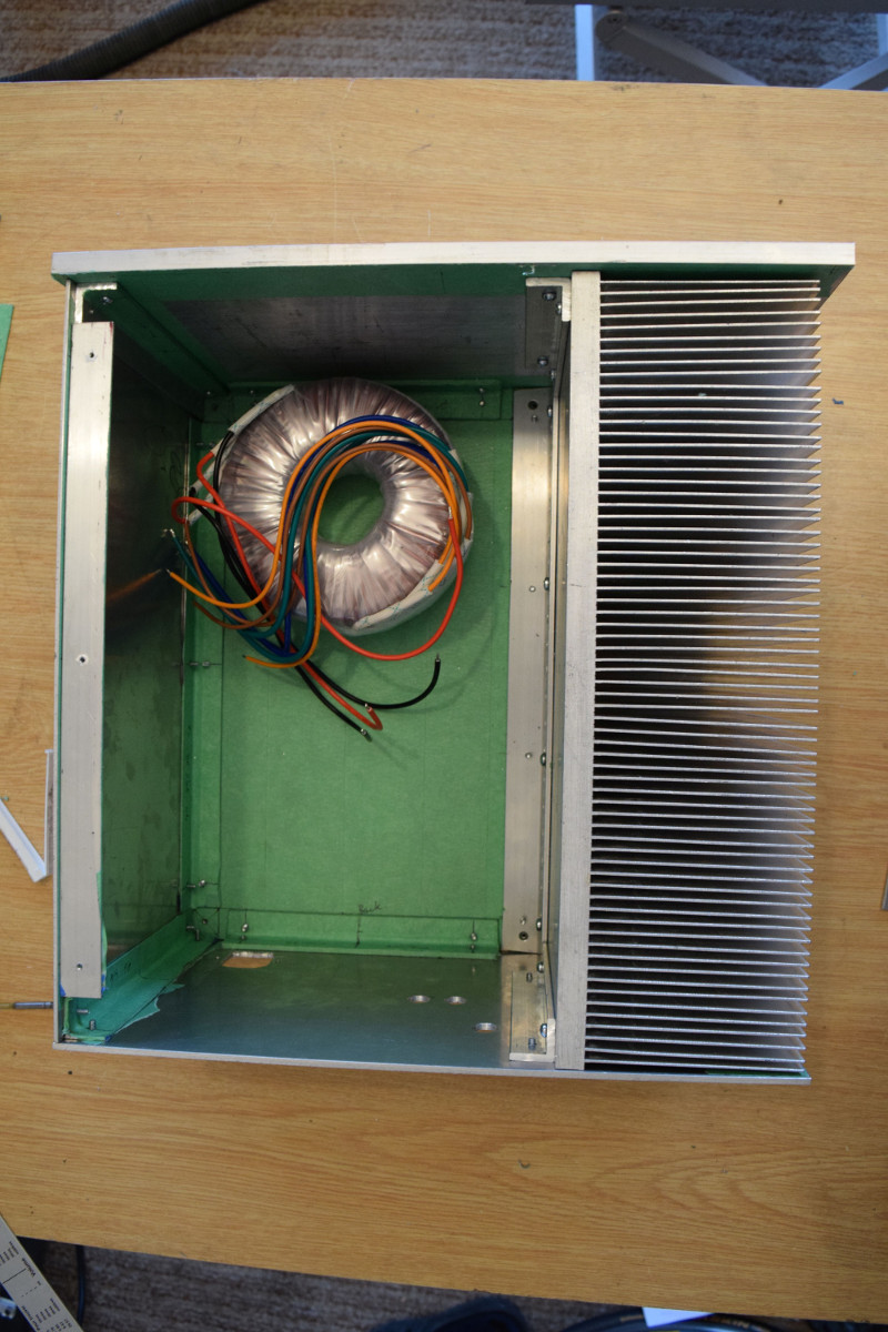

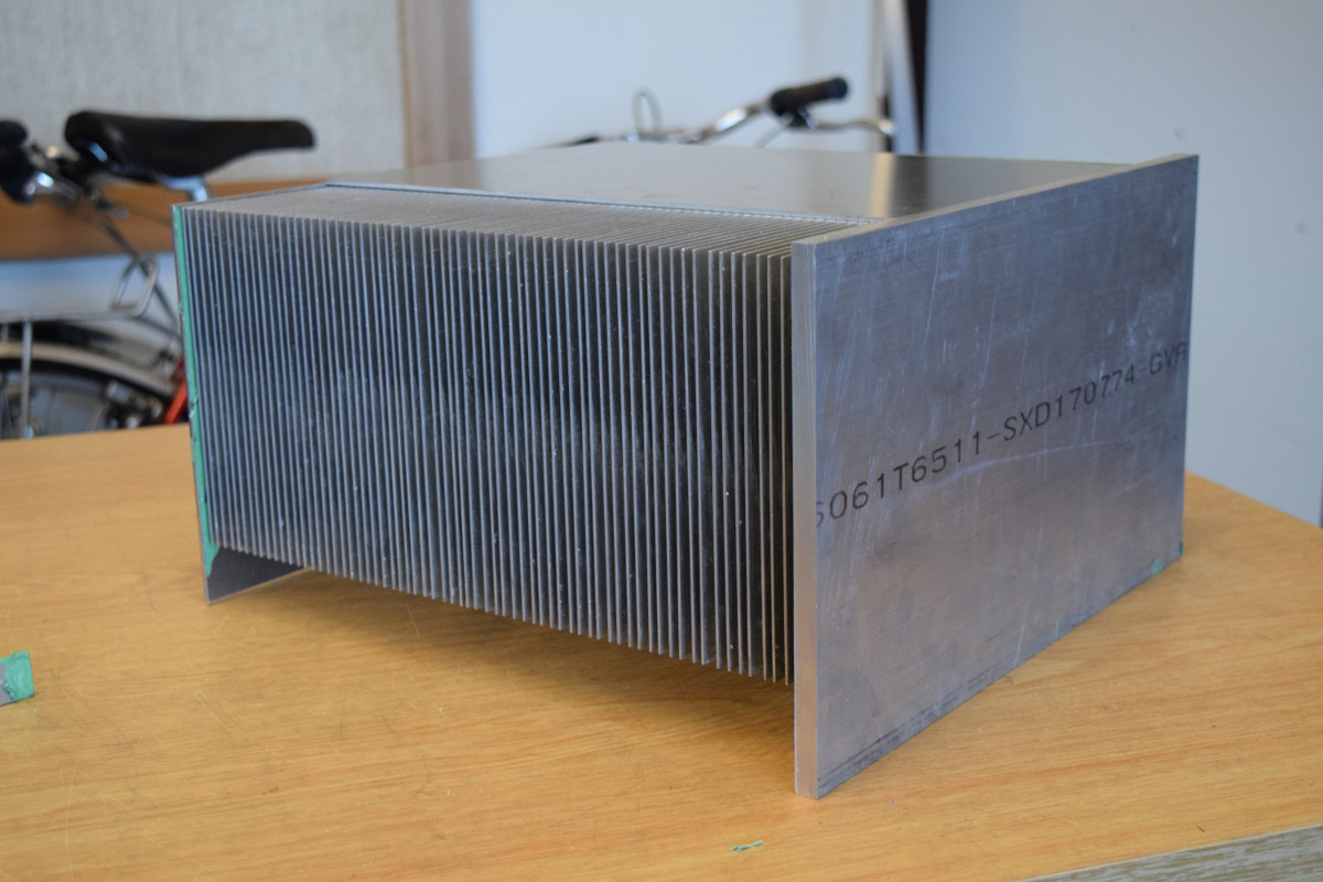

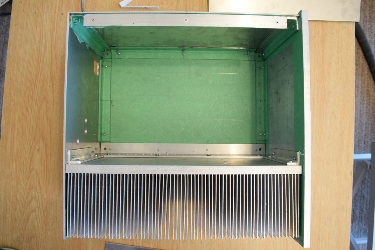

This looks like so much fun that I have decided to join the party and build a THF-51S amp. To be truthful, I have listened to Ben Mah's amp and it is very nice sounding.
I bought some surplus heatsinks which weigh 11 lbs. (5 kg) each. They are not huge so I knew that some sort of fan cooling would be needed. I wanted to make sure that the fan arrangement that I planned would be adequate before I committed to designing a case so I rigged up a test. Two 8 ohm resistors were clamped to a heatsink and 28 Volts were applied to the resistors in parallel. Three 92mm fans kept resistor temperature to about 41 C. Now I was confident enough to design the cases.
I am building the two cases so I will have monoblock amps. So far, I have all the parts cut to size and have assembled one case. The second case is not too far behind. Just a little bit more drilling and tapping.
The fans will be under the heatsink. I also decided to enclose the heatsink for better cooling efficiency.
