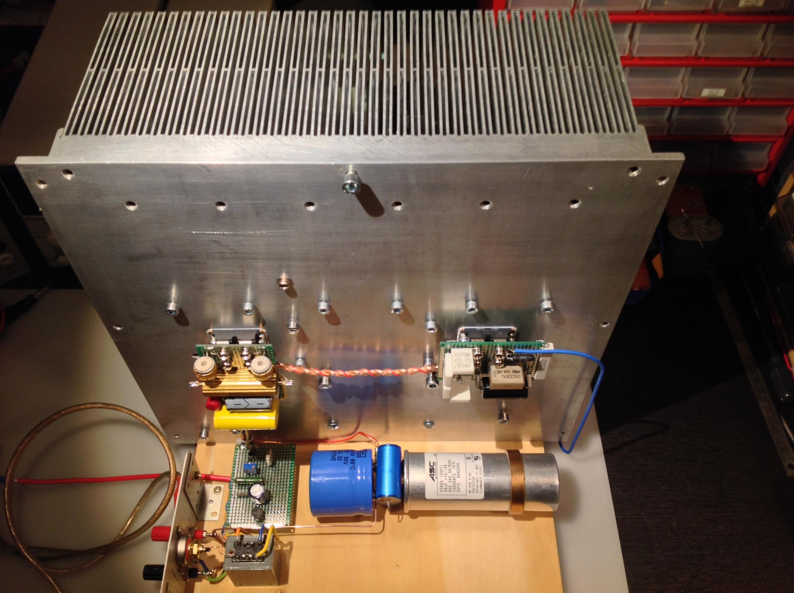

I do play more music with Schade 50W this evening and night.
First observations: start at power on with progressive up current rise for about -2 minute's.
Speakers are silencious without music.
I am happy camper with big heat sinks at 3A2 of the bias.
Time to try A, B, C, D taps of CCS and hear & feel subtle different harmonic distorstion signatures and phase.

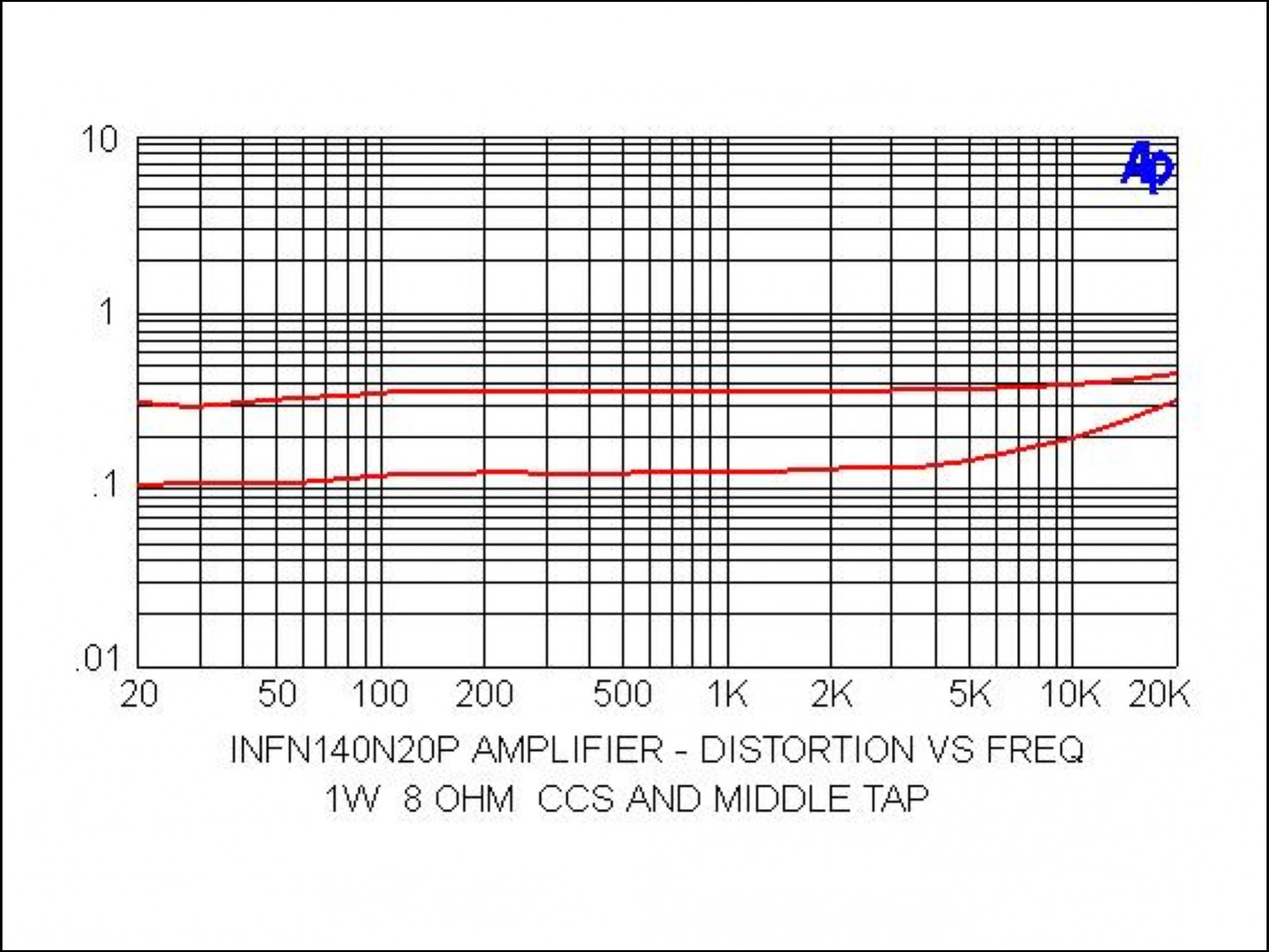

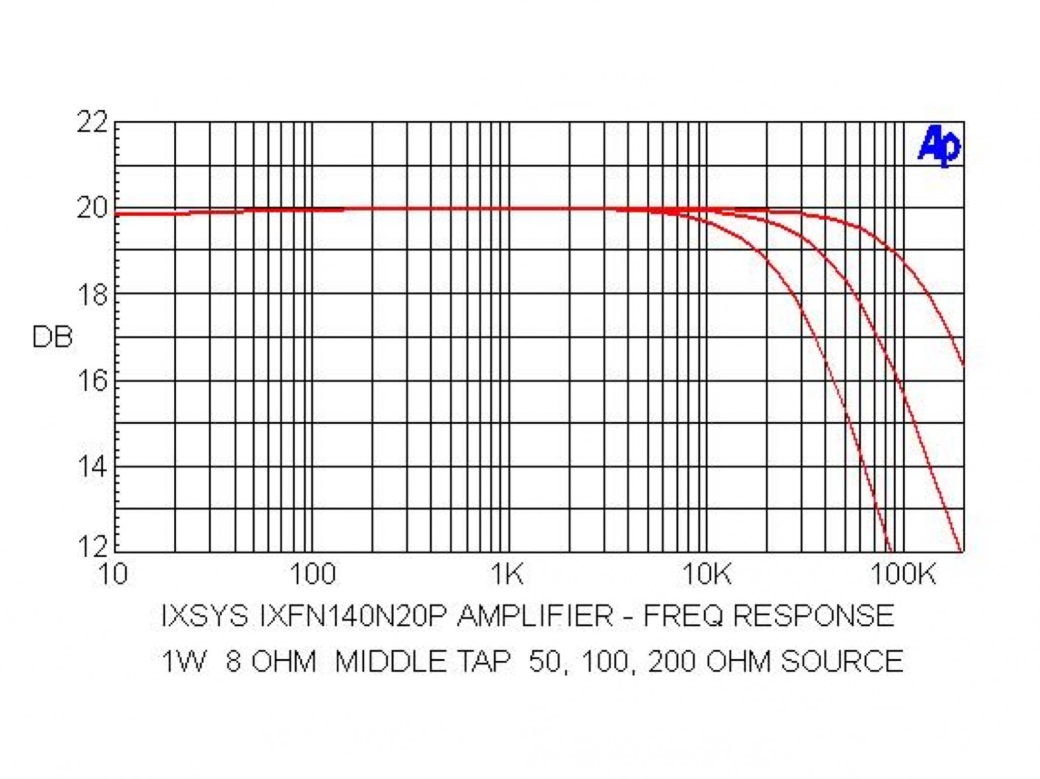

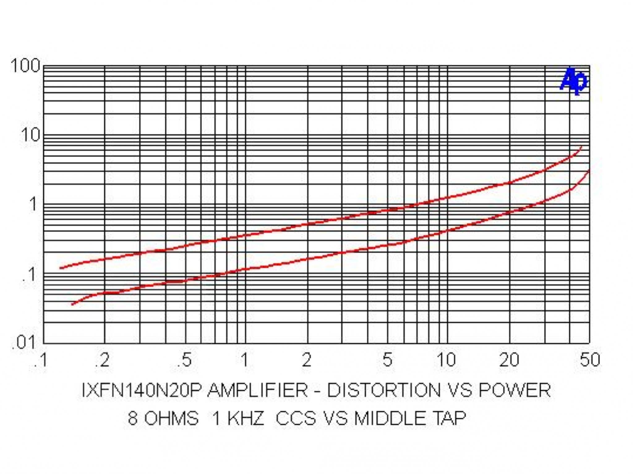

Graph and schematic courtesy of NP

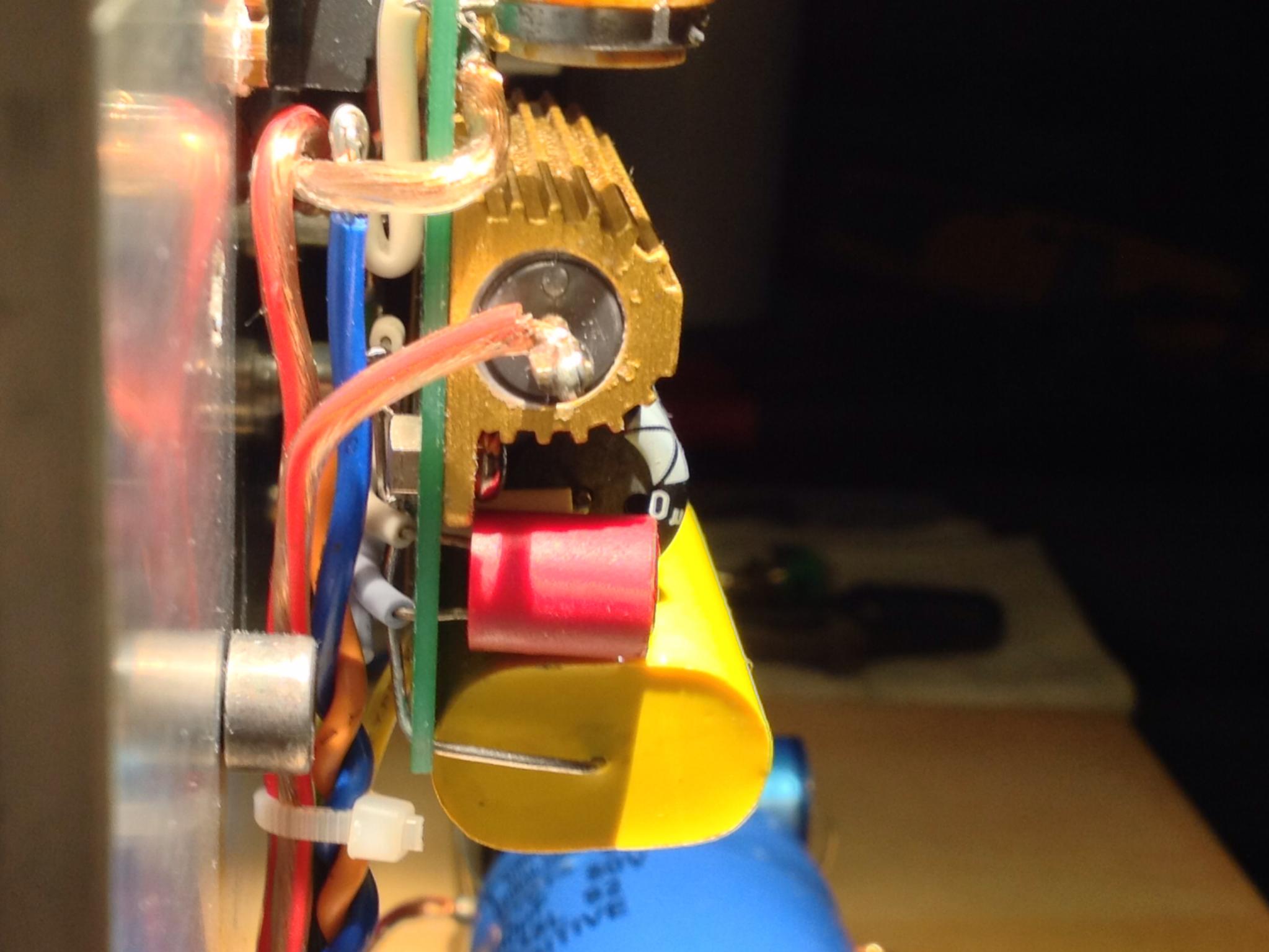

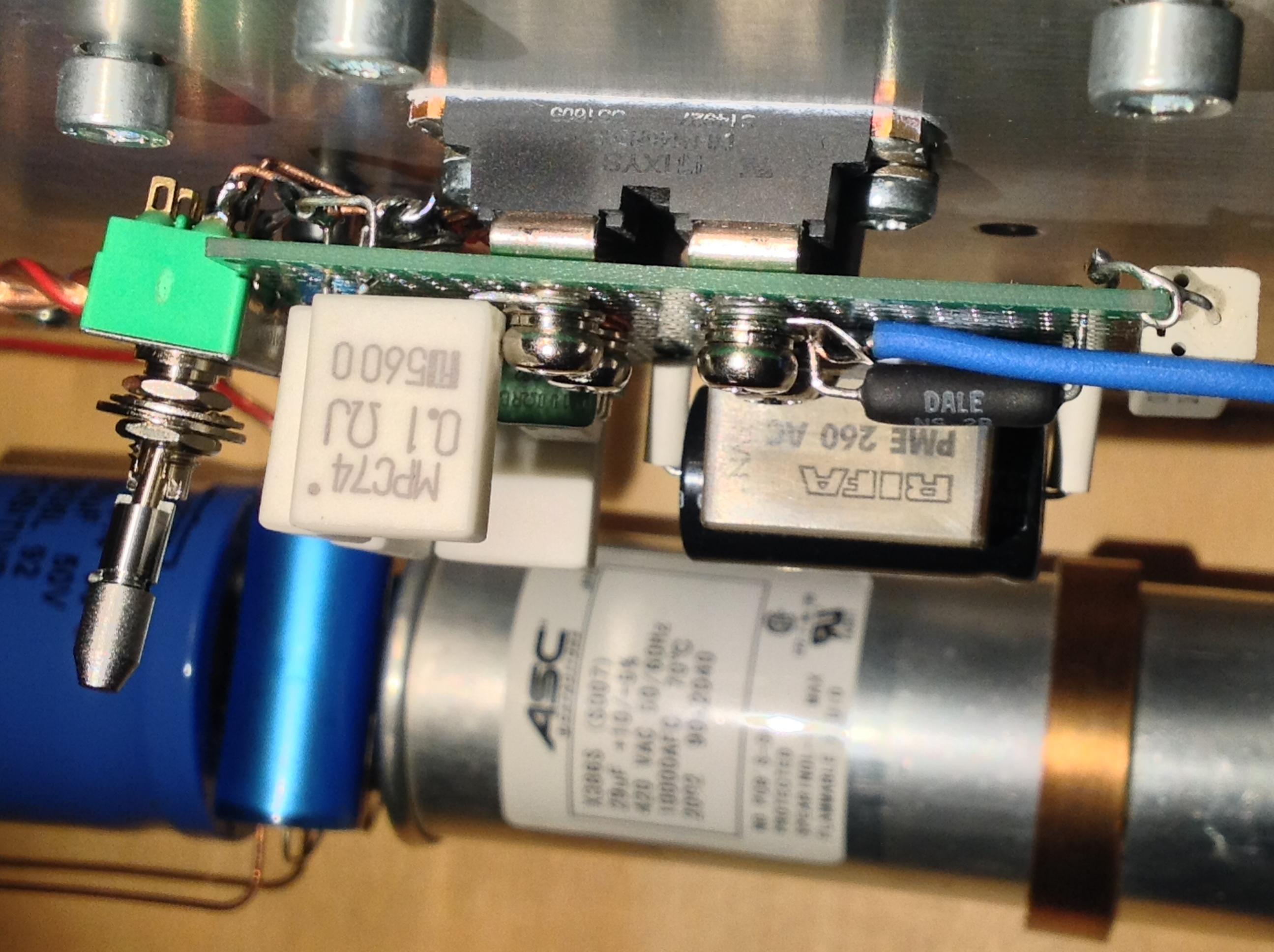

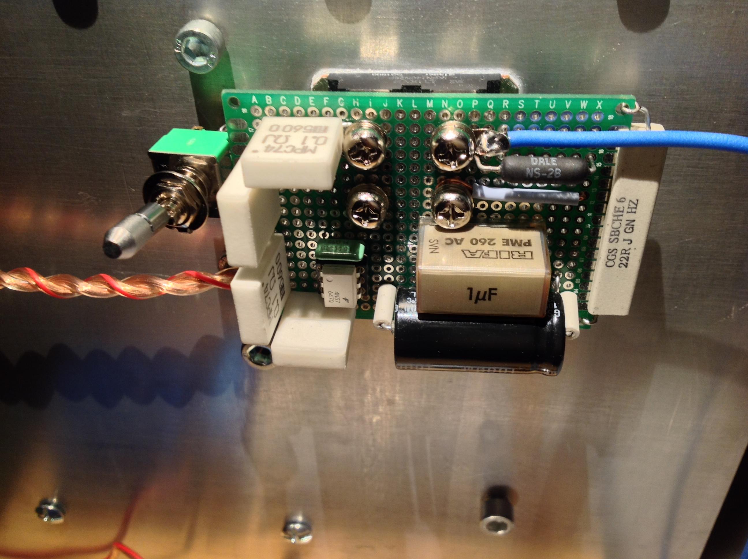

Nice Christophe! I see more exotic components, which I don't recognize, on the left PCB.
What IXYS are you using as replacement for the 2SK77B?
Are you listening Mono right now?
Thanks Walter
:D is two resistors with big ceramic core to keep them temperature stable
not far from the hot puck mosfet.
Oh it's all precisely like on the Papa schematic with IXFN140N20P.
Yes prototype is one channel only.

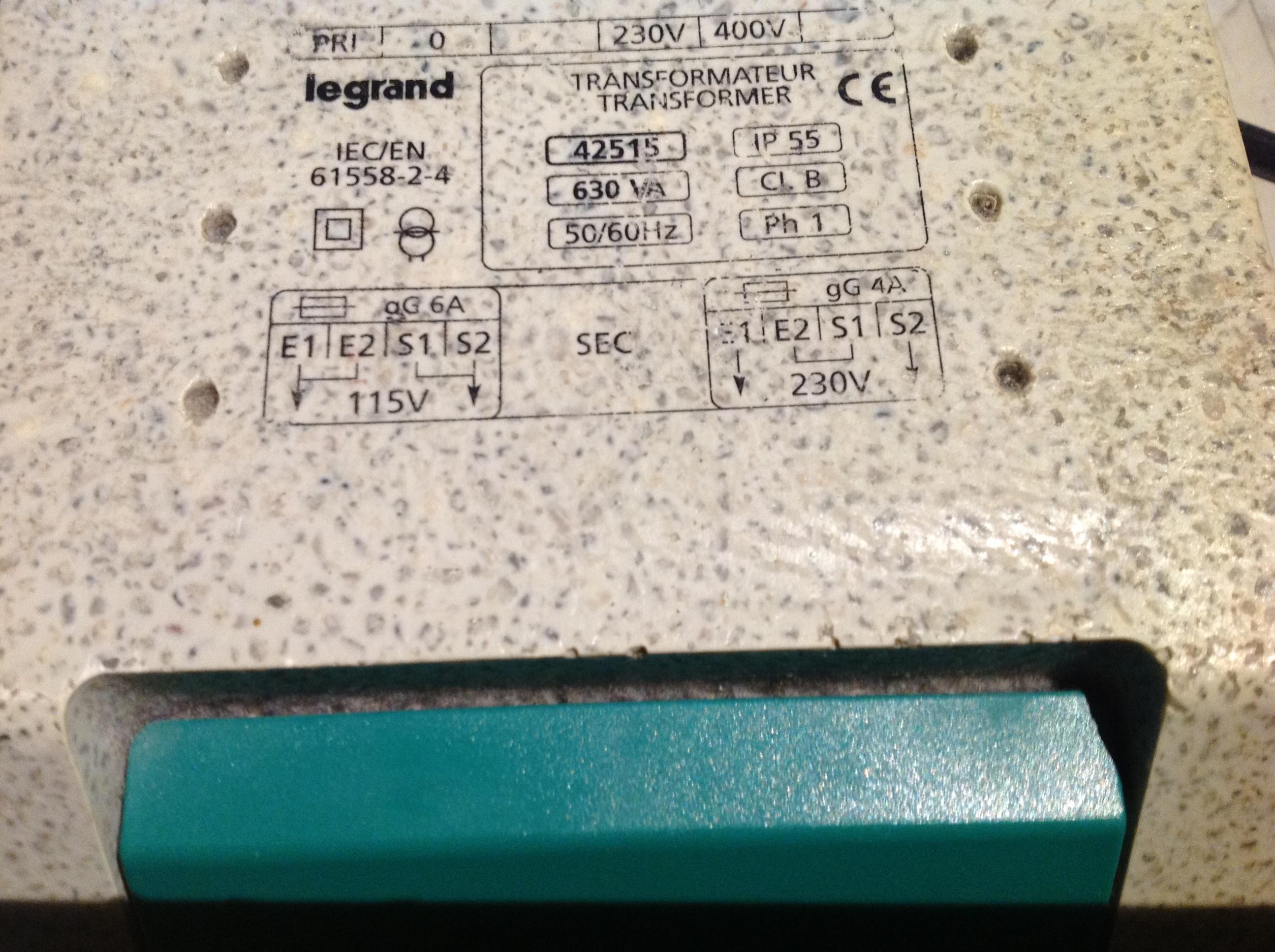

I get two bench psu 60 V | 5A max if connected in series just perfect for mono.
My thrue exotic component are huge 230V : 230V galwanic separation transformer.

2SK77B triode simulation with IXFN Schade Feedback

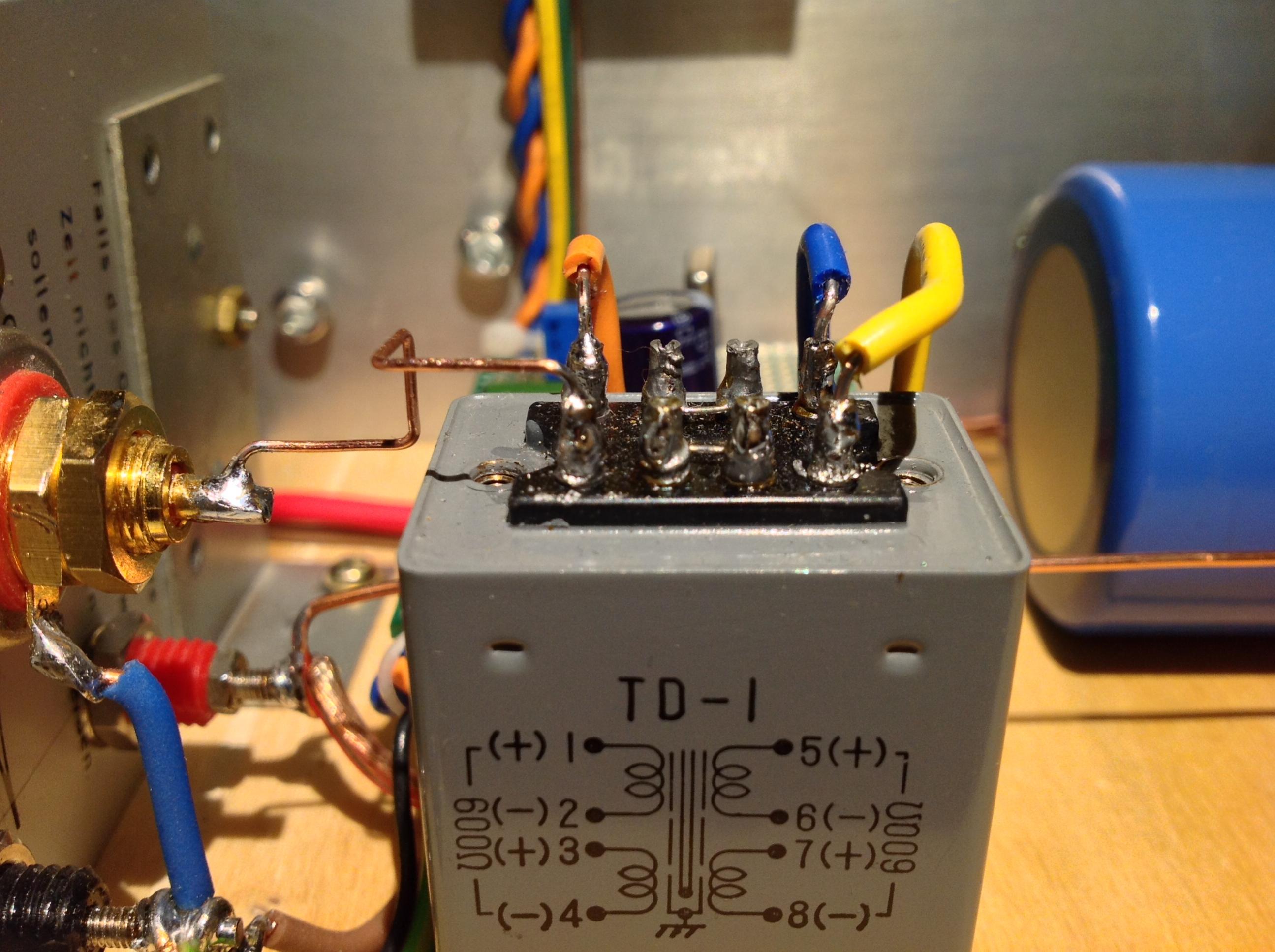

Few impresions after preamp's and taps test.
Jfet buffer 25 Ohm's source impedance or similar for this amplifier is the KEY.
First time I try passive Autoformer Volume Control AVC attenuator with this prototype. Clean sound.
After that i connect them to the solid state preamp and was BIG motor boat brrr bada boom.
One resistor value 50R ~ 500 R connected to the hot of the RCA and GRN and no more problem. All OK
It was delicious music with tube preamp at night.

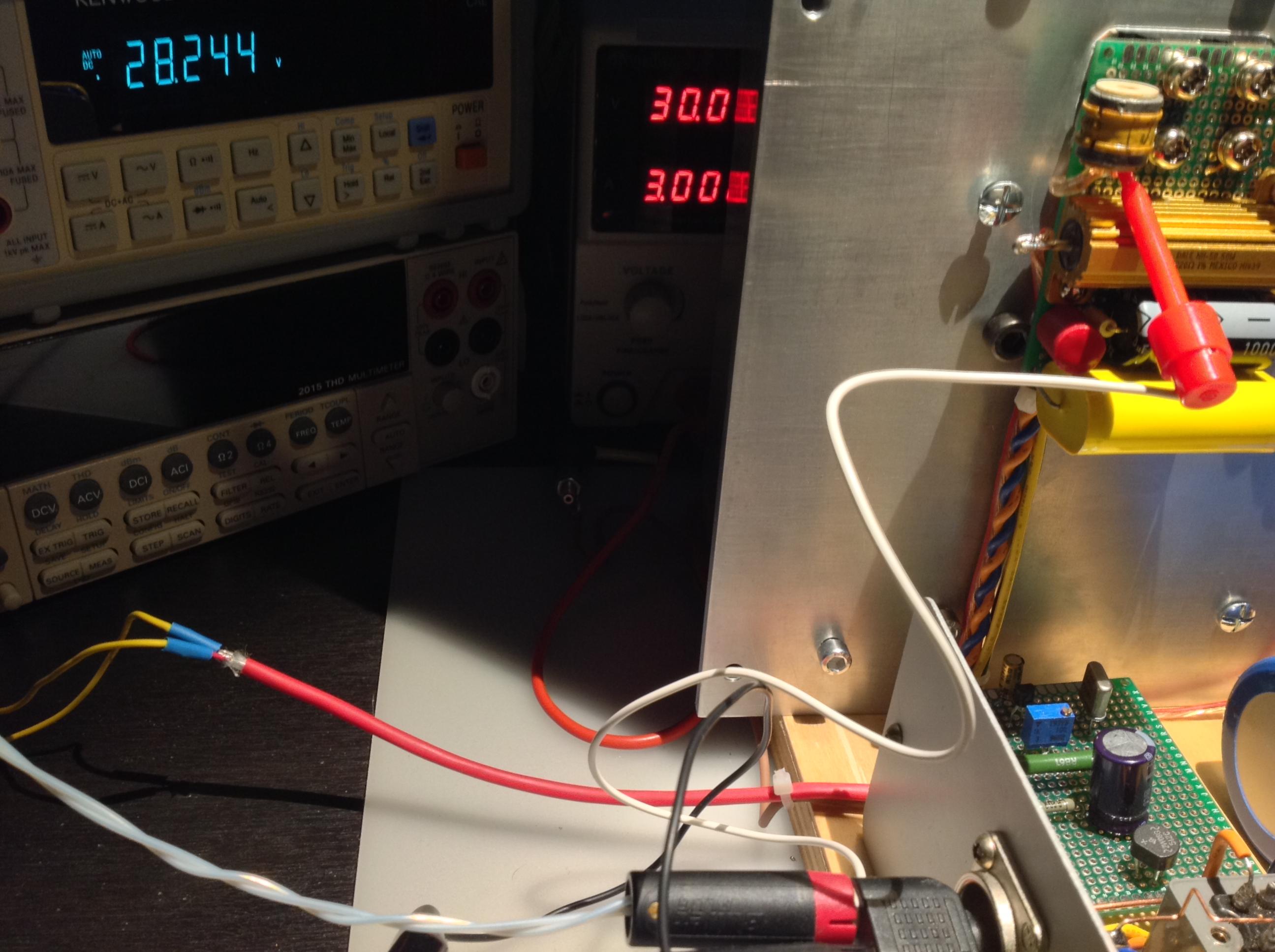

~ 28V from IXFN drain to GRN show me +3A bias.
I solder 2 order or 3 order distortion switch between C and D tap's.
Difference is clearly audible
2 natural relaxed tone
3 nice dynamic tone
get the two options is COOL for match with specyfic audio source, preamp and drivers.
Great experience :)

Voltage at lead outs of two 1000 uF caps are less 10 V.
10 KuF output cap have 59V for short time at power on.
After few minutes at 3A2 full bias , tension go down to ~ 15 V.
Anyway 50 V rated big can is safe.
