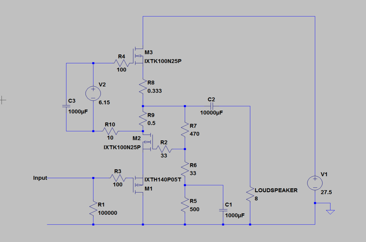

So were there any working baf2015 amps made without a servo circuit?
Of course. Note a couple things:
1) The amplifier must be driven by something with a resistive component
to its output impedance. That means that the source cannot be capacitively
coupled, or if it is, there is a resistor to ground after it. Otherwise the
amplifier will motor-boat.
2) The DC Drain voltage of the circuit's gain transistor is temperature
dependent, but it generally should be fairly stable if the heat sinking is
adequate - If it's not stable enough you can put a 5 or 10 watt 220 ohm
resistor from Drain to Source to stabilize it better. I don't think you need
the complexity of a servo.
Me either.
Does this mean a B1 and BA3 front end with their 10uF caps are not ideal with this amp?
If your source is cap coupled, then you will need some resistance to ground.
Try a value like 10K and watch for motorboat (with load). Decrease the
resistance until the motor stops.

Oh great, thank you for that information. Well now, I had just finished a servo circuit that works very well in ltspice, but I suppose there is no point in building it now since I don't need it.

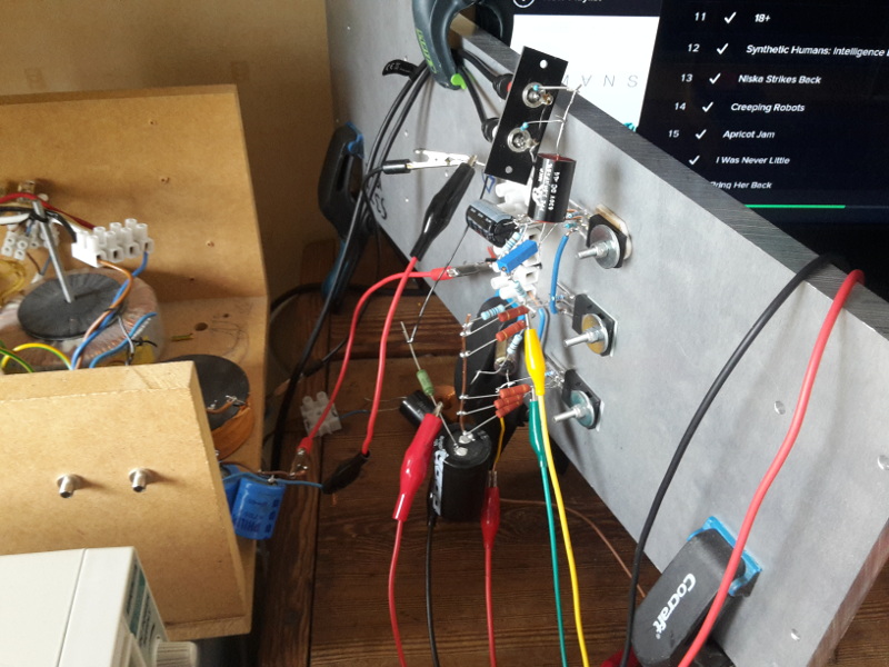

This is the schematic of the amp playing Cristobal Tapia de Veer as I type this post.
A simple point to point test with some devices bolted to a piece of 15 mm alu plate.
I am interested in this circuit. How did you go about making the 6.15V. Do you have a schematic of the 6.15V circuit? Does this circuit invert the signal? I have not followed this thread too much not needing all the power this build makes.
If it's not stable enough you can put a 5 or 10 watt 220 ohm resistor from Drain to Source to stabilize it better.
I don't think you need the complexity of a servo.
Reducted all servo components into one resistor...
