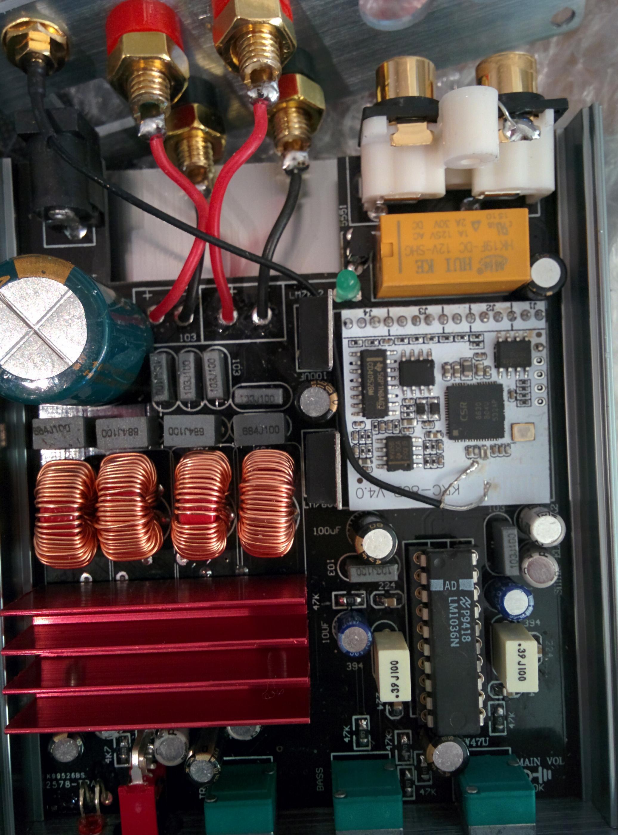

Finally it arrived
2015 New TPA3116 digital stereo 4.0 Bluetooth amplifier 50w+50w with high bass adjustment Mini Power Amplifier-in Amplifier from Consumer Electronics on Aliexpress.com | Alibaba Group
TPA311 BT4 50w
It's working and sounds not too bad, have to test it in the car though.
This is how it looks like inside:
What do you think? Can anyone familiar with the components tell me if it's worth it?
I'm not an diy audio guy..
TPA311 BT4 50w
I posted thoughts here on a nearly identical board. Was curious if others get noticeable noise using its Bluetooth, esp. during quiet passages.
Don't recommend wasting time trying to fix/improve it as I did, just use as is... Maybe after adding a bit of thermal paste between heatsink & chip if there is none.
BTW don't know if normal car voltages will be so great w/this board, its LM7812 min dropout voltage appears to be 14.5v.
I tried it in the car today - I'm getting some noise if there is no sound/music. And also, if I leave it turned on I get the typical pop sound when turning on the car.
Not sure if it can be solved (with my basic knowledge), I only know those power filters for the audio inputs, not sure how this can be used with a BT amp (on the outputs?).
