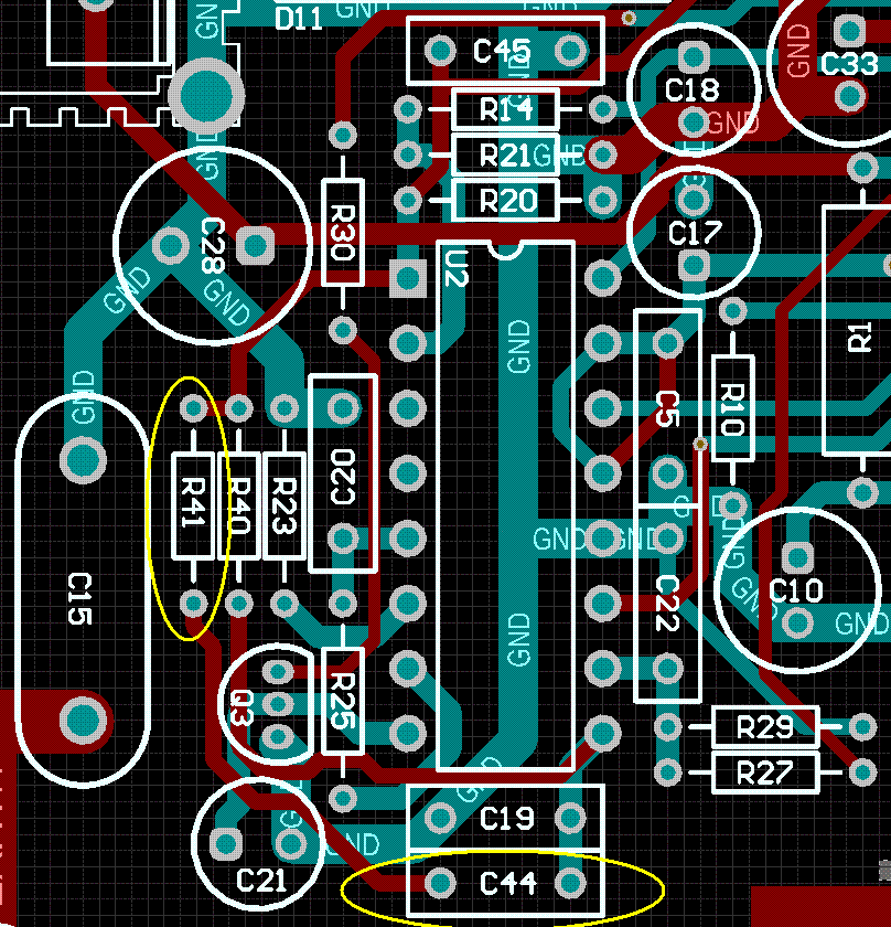

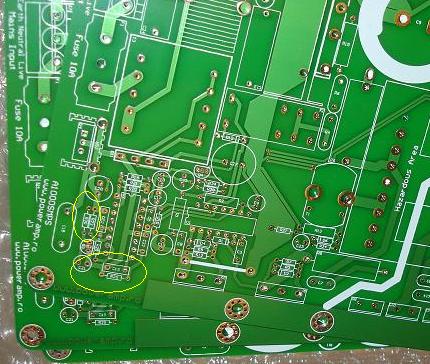

including the intentionally mistakes ? let's say traps ?
let me know if you need more photos, maybe higher resolution
I'm blind or there is a small difference...
At least don't try to fool people in face.
Tibi
