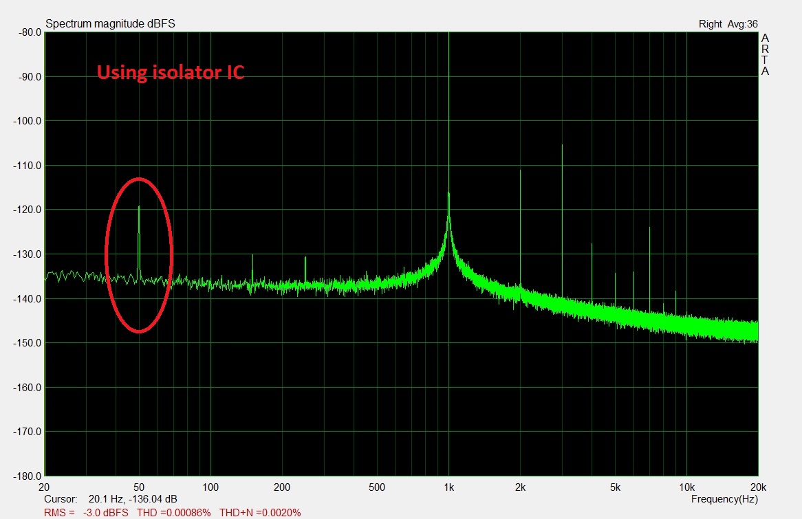

I'm wondering if anyone has any idea why I see a 50hz spike when using a ADuM7440 SPI isolator IC between a micro-controller and a DAC. I don't have much experience with isolators but just read the datasheet and designed the PCB myself. I have two 5V PSUs where I intended to use one for the DAC IC and one for the Arduino microcontroller with the ADuM7440 isolating them.

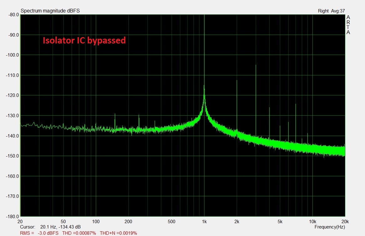

These are my observations:
1x 5V PSU with ADuM7440 bypassed = Good
2x 5V PSU with ADuM7440 for isolation = 50hz spike.

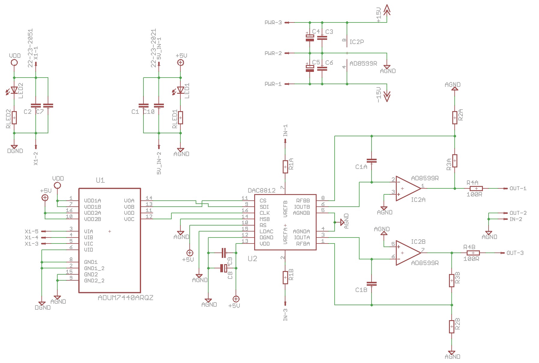

Here is the schematic:
http://www.diyaudio.com/forums/atta...g-switches-multiplying-dac-mdac-schematic.jpg
To bypass the ADuM7440 IC I just connected the VDD/5V and GNDs from either side of the IC.

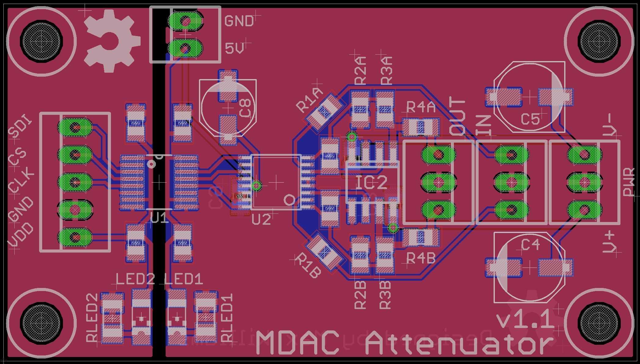

Attached is the layout and two graphs showing the 50hz spike.
Did I make some mistake? Poor layout? It just seems weird that either PSU on its own measure fine but as soon as I use the IC to isolate I get a 50hz spike

The spike is present in both of your plots, just the level changes. The first one has around -119dB relative to FS, the second around -134dB. Assuming we're looking at 1VRMS for the 0dB reference point these signals are in the region of 1uV and 200nVRMS respectively.
Given the absence of harmonics my first guess would be capacitive coupling from the 50Hz mains. Let's get some handle on the numbers involved - at 50Hz a 1pF capacitor looks like 3Gohms - if your DAC has a 100ohm output impedance this makes a 30,000,000:1 potential divider. So with 240VRMS on the input to this, the output would be 8uV. It seems therefore that your spike at -119dB could be due to just (very roughly) 0.1pF of stray capacitance to mains.
