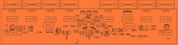

Post some picture of your work top and bottom side so we can try to help you..

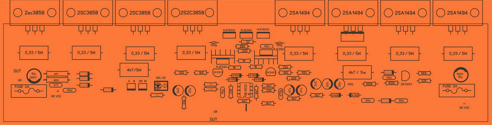

nice one can you share PCb layout back sideMy b500 with sanken transistor A1494 C3858
