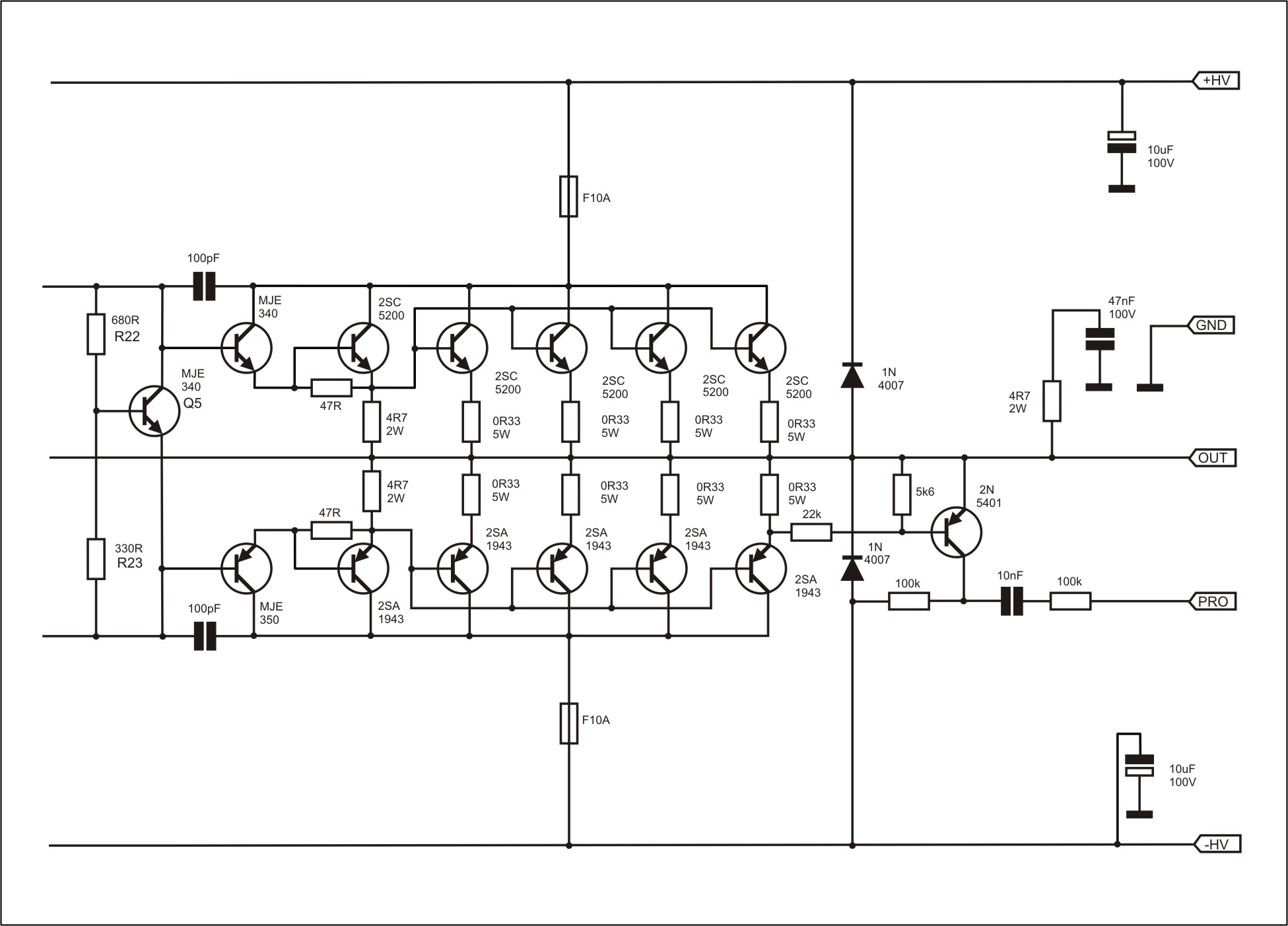

Sir, said apex B500 R27 (22ohm) I try to replace the previous 120 ohm load 4 ohm speakers at full volume and the final driver transistor hot enough after changing 120ohm & final drivers are not too hot, think about what effect the replacement of R27 is yes ... if the power is still stable at 3-4 hours usage, .. please guide

Try this output stage

On R20/21(100R) you must have 0,5-1V, if don't replace R15/16 (1K) to get 0,5V (5mA thru VAS transistors MJE340/350), and use 1k pot instead R22(680R) for set BIAS (10mV on 0,33R/5W is 30mA per outputs)
wow! What a nice advice thanks sir...sorry 4 late reply...i had made sir what you said..thank you sir apex sharing you talent all over the world..your awesome man and rare person..thanks sir GOD bless and more power...i share my project here in tread if i fixed it

I measure DC offset on some old B500 amp, and I have 1mV on left 4mV on right channel (3 pairs outputs with +/-75V rail), I am sure you can get better DC offset than 150mV.

hello sir apex sory for the lated replied, anayway i had only -35mv on dc offset out put trns. why it's negative 35, it's normal?.... and bias .430mv and the left side ,350mv, but sounds Good very nice,, thanks sir apex for sharing this amp..I measure DC offset on some old B500 amp, and I have 1mV on left 4mV on right channel (3 pairs outputs with +/-75V rail), I am sure you can get better DC offset than 150mV.

DC offset can be positive or negative it's normal. Where you get 430mV and 350mV (points). Transistor start to conducting at 550mV from base to emitter, and go from class B to AB, than BIAS current increase and base to emitter votage is still 550mV. Use 10R instead fuses and measure voltage drop on them (about 1V). Sound is good in class B it's normal for B500 and H900.

R12(1k) and R19(22k) determining amp gain, OP amp work as AC buffer and DC servo, first OP amp work with gain R1,R2 and R4 determining gain of this stage, and with different resistor value instead NSL32 you can detrmining amp input sesitivity (use 33k or any value from 1k to 100k).

You can use separate PSU (+/-15V) for OP amp. If you want increase rail voltage you must add more outputs.

If you want to use B500 as Hi-Fi amp, I suggest to adjust BIAS current to about 30-50mA per outputs.
