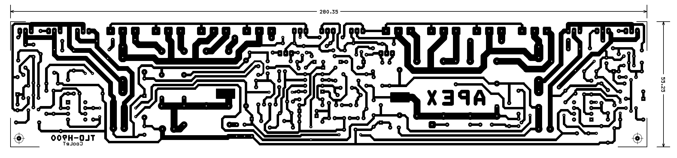

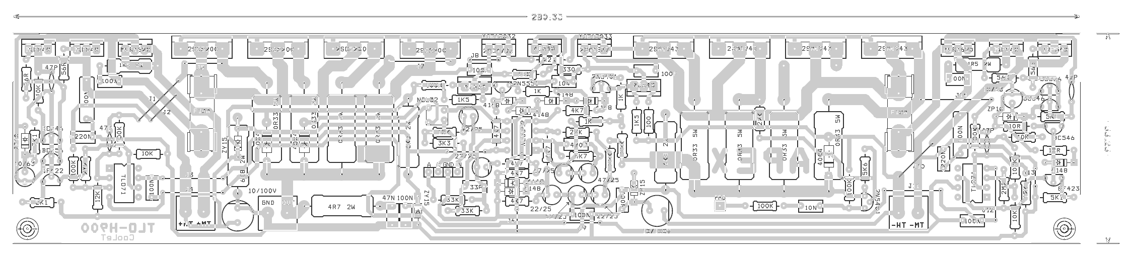

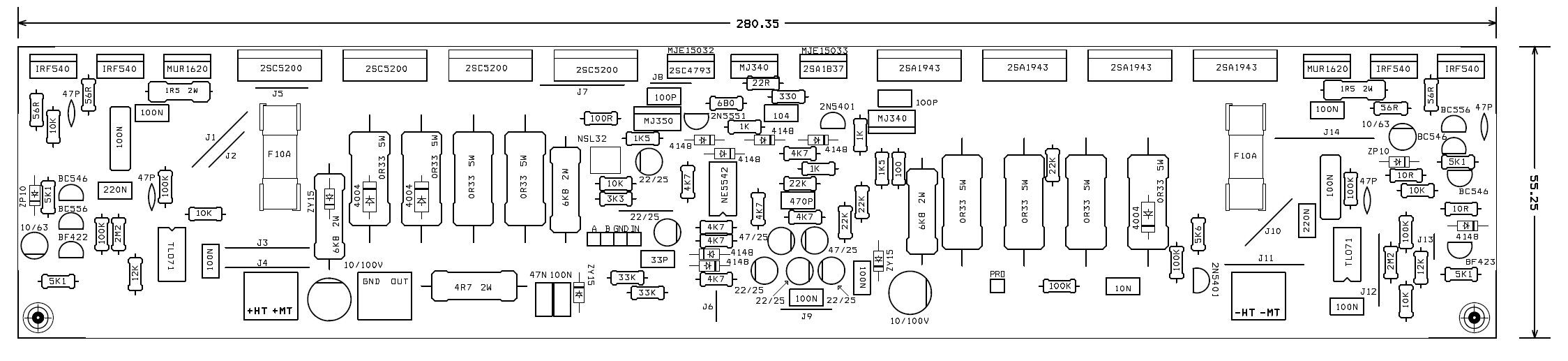

hi apex,
it would be nice if you check also the values and make a remarks on the pcb i make so that i can finalize it. another thing is, on your scheamtic you have 2x220n in series while in the pcb you have only 1x220n.
regards,
coolet
Ok, I will check. I use 100nF/250V instead 2x220nF in series becouse connect two 220nF/100V caps in series you get 110nF/200V.

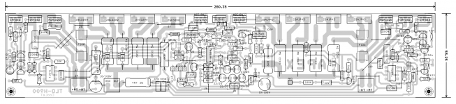

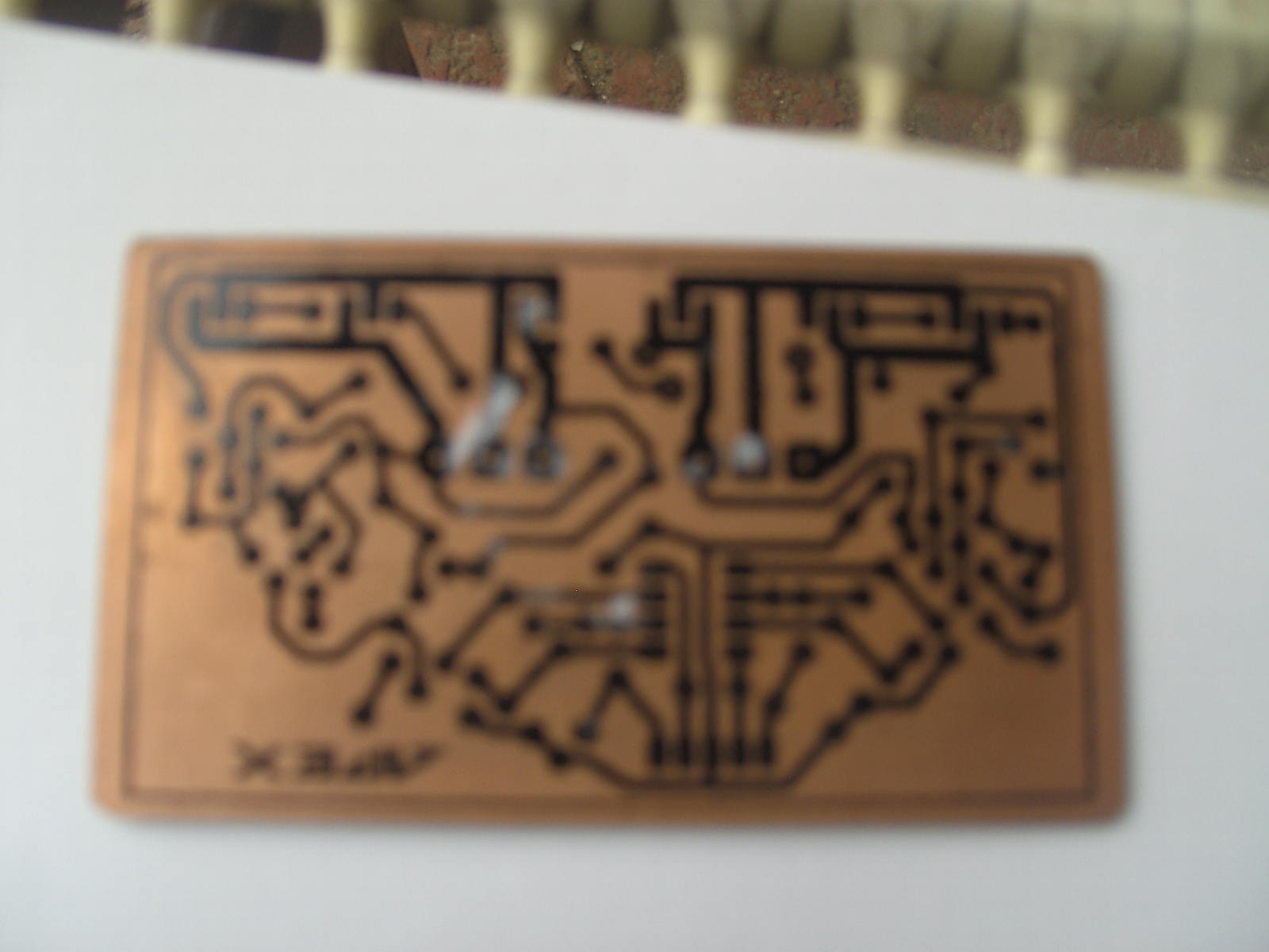

hi apexaudio
greetings trying to make this amplifier h class with tlo72
step driver pcb and have made your dc protect will use with this amplifier
will it work main i need dc protect and overload detect .
thanking you
andrew lebon
hi apexaudio
thanking you
andrew lebon
You must add parts around 2N5401 for overcurrent detect, or parts around NSL32 for limiter. DC protect will work with any amp.
